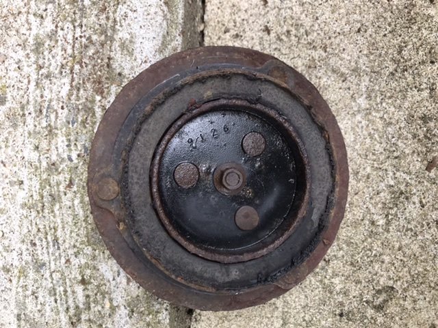

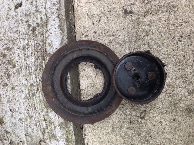

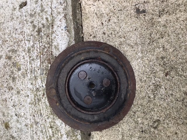

    Have a 2010 and did all the great ideas from all the postings. Light was flashing. The clutch would engage and then disengage. Since it was engaging was leading me down a different path. I finally realized when clutch engaged the center portion of clutch was not spinning. The center portion is the compressor. Compressor was not seized and spun freely. Realized clutch is similar to a harmonic balancer, inner and outer attached by rubber. The rubber separated and prevented compressor from spinning. When comp does not spin, sensor does not see it turning and cuts out the clutch. Replaced clutch, very simple one bolt, installed original spacers and A/C working perfect, very cheap repair. Thanks for all the great post, all very helpful.
