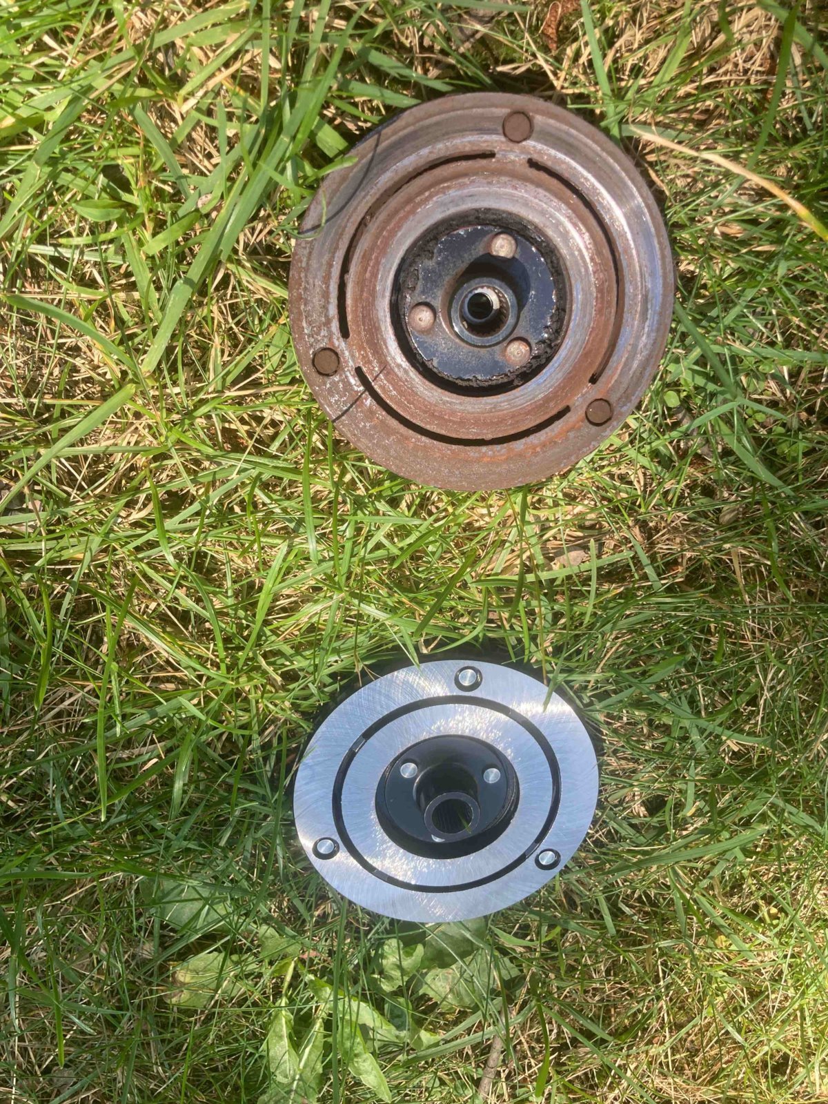

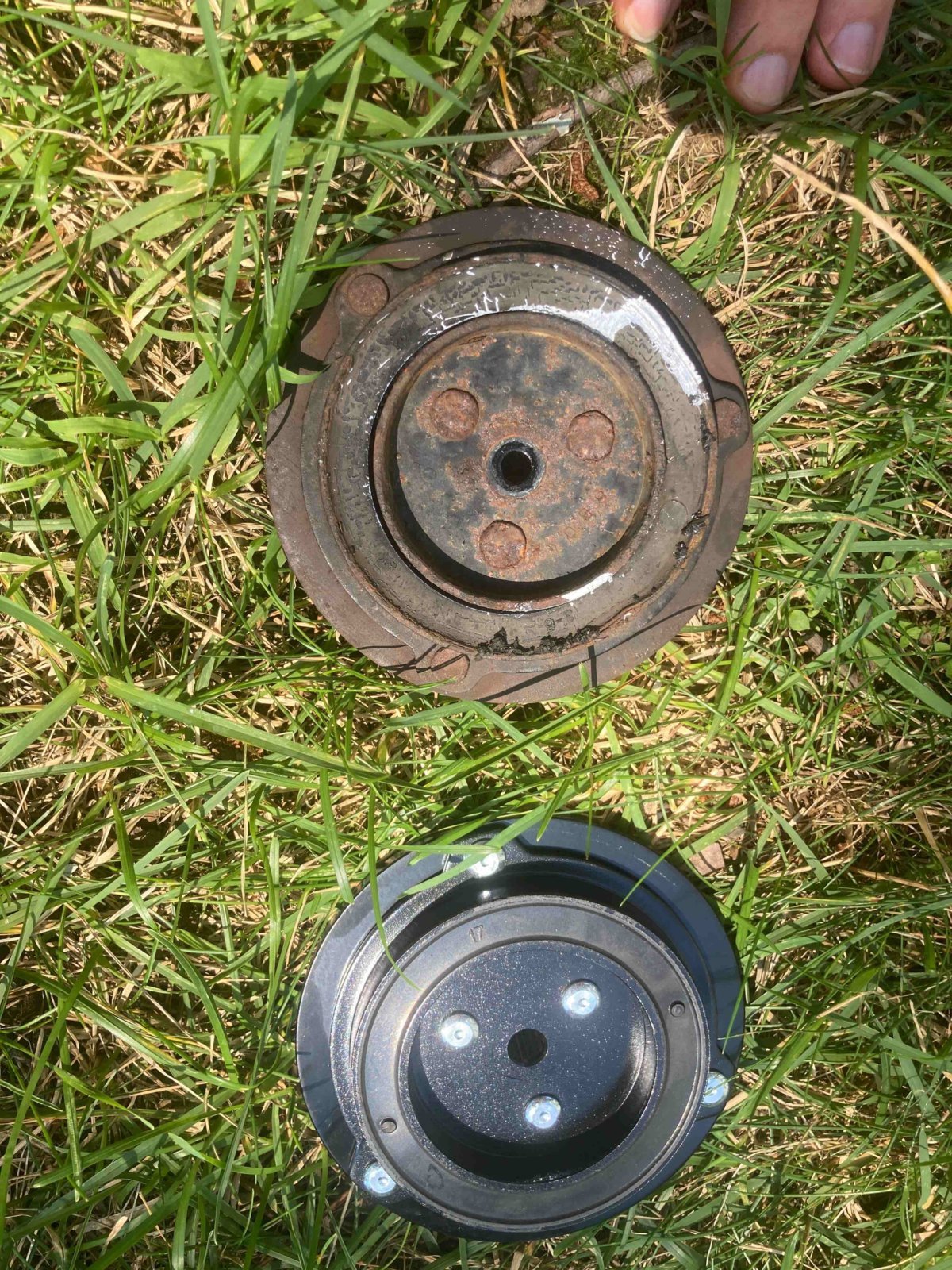

    The issue is solved! Clutch now engages and disengages. I dropped the extra shims, and in will now just BARELY turn a smidge every few seconds when the magnet is off. I am hoping that this is not an issue, and will go away as the clutch wears. I DO have another issue though. I was not as educated about A/C systems a month ago, and I overcharged it. I am wondering if that was a contributing factor to the clutch failure? The low side is reading about 100/110psi while running. I called around and so far the only shop I found that will pull out the excess charges $260 to evacuate it, whether they refill it or I refill it. The A/C still runs, but should I evacuate it because it can harm the system?

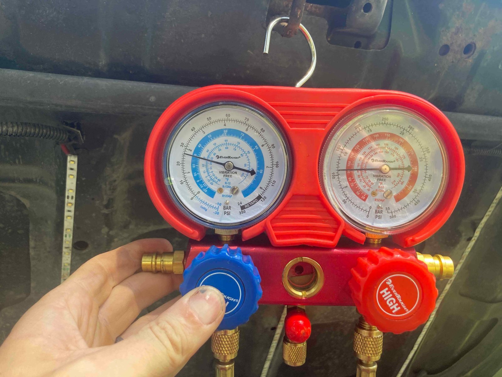

    I used a set of manifold gauges to test the pressures. It was a little confusing that you turn the knobs on the car valves clockwise to open, and the ones on the gauges anti clockwise, but it made sense when I thought more about it. That reading is from when all four knobs were open, I was seeing pressure in both high and low gauges. It is possible that I messed up how I read them, but I'm pretty sure I am right. Both needles (definitely the low side, pretty sure about the high side) migrated while the car was running and the A/C was on. I will try to take pictures and post them.

    OK! so basically by having both valves at the manifold open I was letting the high side affect the low pressure gauge? I hooked it all back up and did as you instructed and then I was getting about 100PSI for the high and about 25PSI for the low. Yay! Thank you so much Dm93 for your knowledge and responsiveness, I couldn't have done it without you! I guess that my "overcharged" system is actually a little undercharged.

    Here are the pictures I promised. First two are of the failed clutch and the new one. On the old one notice that the hard rubber is separated from the inner disk in the lower left side of the second picture.

    What's the ambient temp? Those pressures are pretty low.

    The temperature was like 78ºF
