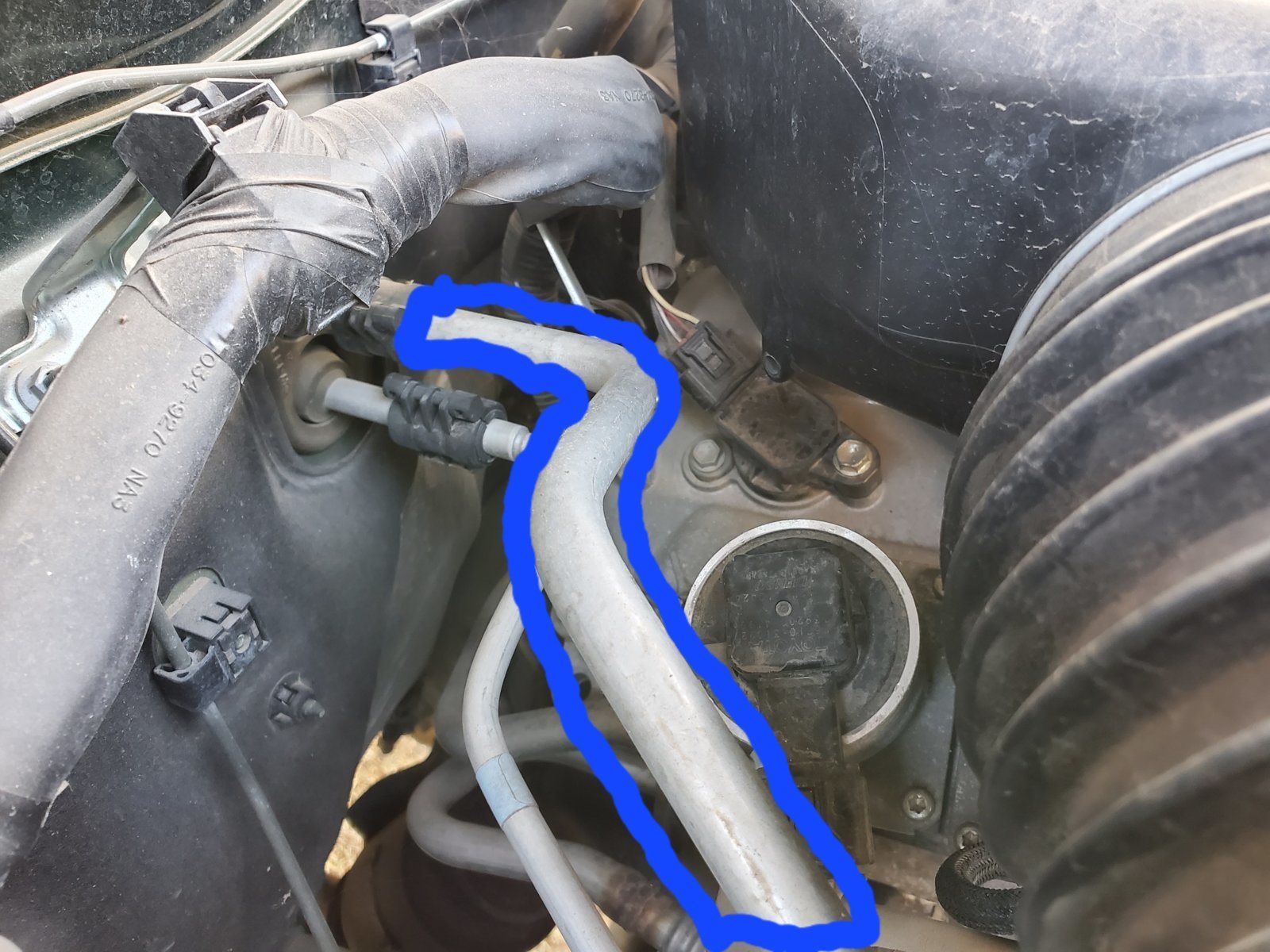

    Seems low for that ambient temp if you have the blower on high, low side is pretty close but I would expect the high side to be somewhere in the 140-160 range.
    Run the truck A/C on, blower on high, and see if the suction line exiting the firewall is ice cold, if it is your probably good. If it's not then your probably a bit low.
    PzTank likes this.

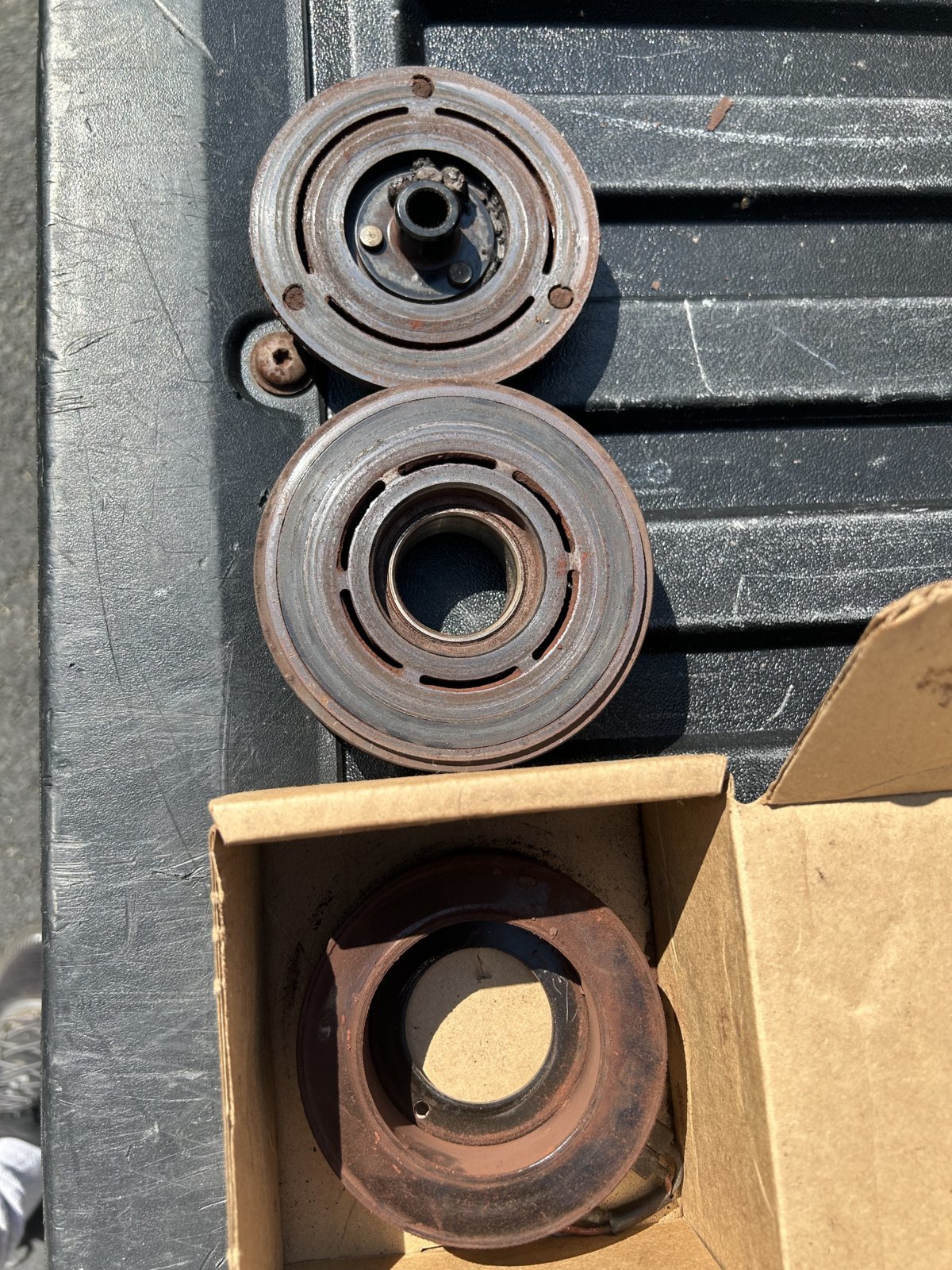

    That mid-pitched, resonating whine I heard was the rubber letting go on the AC clutch. See the little rubber remnants in the pic below:
    Bonus part number for the clutch (check fitment for your particular year and model):
    My truck is a 2015 with about 153K miles. I don’t think it’s the miles more-so the age of the clutch..
    Dm93 likes this.
