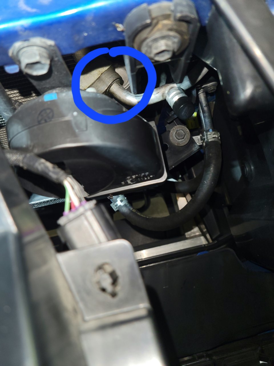

    I speak from experience, do not use the DIY AC recharge bottles from Auto parts stores. You have a high probability of overcharging the system, even with the gauges on the bottle. When that happens, you will have to perform an AC system evac and fill, so you're more money and time in the hole.
    OP: You can take a blacklight/UV light and search for the dye. If you find dye, bring the truck back and get the service manager to make it right. Also make sure to request they replace the service port valves.

    There are multiple ways to leak check after finding that oily spot spray some liquid soap on that joint and run the A/C, if they leak checked without the car and A/C running it may not have been leaking especially on the high side. Also if you know anyone in the A/C field you can see if you can get your hands on an electronic leak detector those are real sensitive and will pick up a leak quick.

    Update: I brought it back in for them to diagnose the leak, referencing the above issue and I even physically opened the hood and showed them where to look. Sad that we have to do our own diagnostics but, here we are. Very grateful yet again to this community forum!
    I got the same service adviser that told me originally the systems naturally "evaporate" refrigerant and eventually he admitted that another customer had a similar issue, and that they had to come back in 6 months because the refrigerant had leaked out again. At that time they identified a leak and apparently only charged that customer with the replacement part, not the full refill charge, noting that the leak was present when the vehicle was in the first time.
    I dropped the truck off and am waiting for the service manager to give me a call later today, I will keep this post up-to-date. I hope I'm not being a Karen, just worried that I'll be out the $400 again for another refill + the fix later down the line if we don't resolve it now

    Second update: Tech has agreed with the fix, which is to replace the O-ring. $3.29 installed.
    They need to special order the part and it should be in and ready next week. No (additional) charge for re-diagnostics or A/C recharge.
