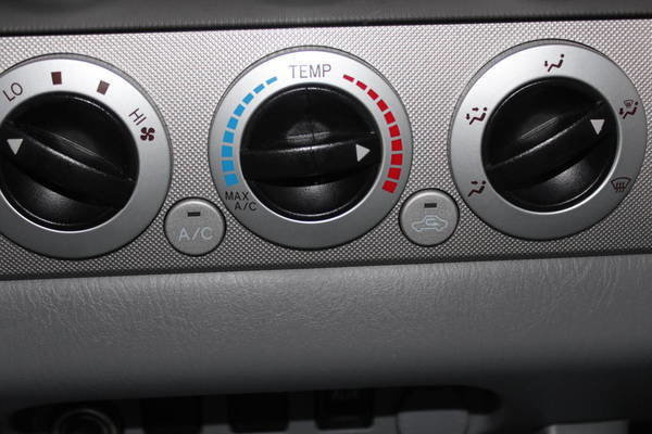

    When I turn the knob to adjust my a/c , the only one that works is high. the other three seem to rarely work. simply no air/ac will come out through those 3 (Low, low/mid, mid/high). But occasionally they seem to work and then about 5 minutes into the ride they shut back off and I have to resort back to high and freeze myself to death. Is this a fuse or is it something complicated like the compressor?

    My guess would be the swtich itself. If the compressor was not working, all settings will not work - even on high.

    That was my first guess but I have messed with the switch and knob hundreds of times...:annoyed:

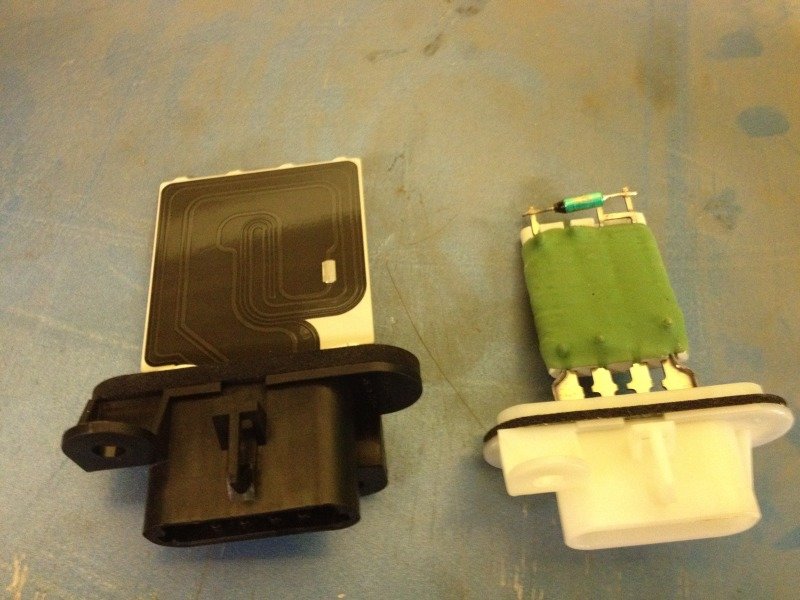

    New Denso part vs old Delphi part. The Delphi part looks like Eastern European technology... because it is.

    Hello! Newbie here....but I have a 2006 pre double cab that was having the SAME problem last week...thought it was a electrical problem...turns out, it was nothing more than my cabin filter clogged...hadn't changed it in YEARS.:der:.....but bought a new one and it fixed the problem...my repair man laughed at me! So maybe that's the problem?
