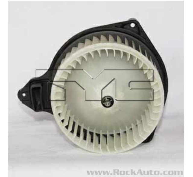

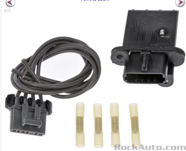

    image.jpg image.jpg Just ordered the blower motor resistor+wiring harness and new blower motor from rock auto. All three items with shipping were less than $75. $24 for resistor and wiring harness $36 for the blower motor plus tax & shipping. Every parts store around me either didn't have one item or the other in stock and if they did have something it was easily double the price compared to rock auto. Example-advance would have to order the resistor price $62 but didn't even carry the wiring harness. Napa had the resistor in stock price $49 didn't carry the wiring harness either. O'rielly didn't even know what I was asking for! Auto zone would have to order everything price $64 for the resistor $32 for the wiring harness. Seriously! Parts stores need to rcognize that Toyota Tacomas are the most popular trucks on the road in this country and start carrying parts for them. This is retarded!! Thank God for Rock auto!

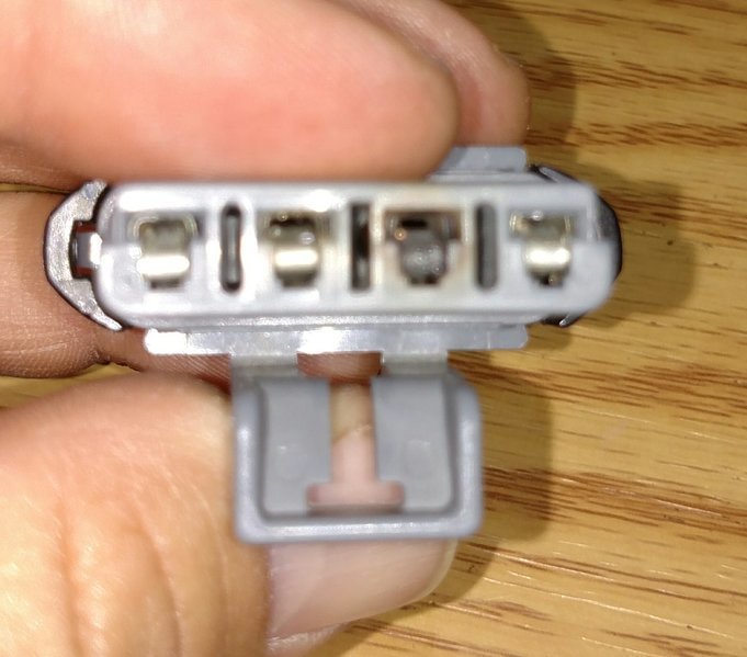

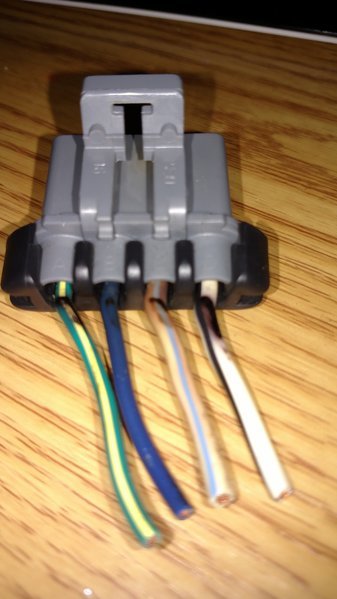

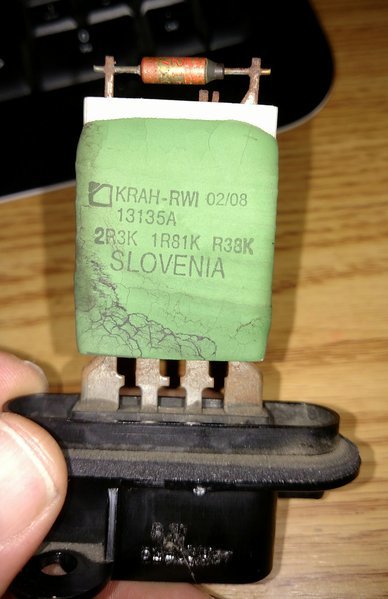

    This is exactly what is happening to mine.
    How would you know if the resistor is bad? The connector is fried, complete smoke checked. It may be from the kids putting their feet on it...
    Don't want to replace the resistor if the harness just needs to be replaced.
