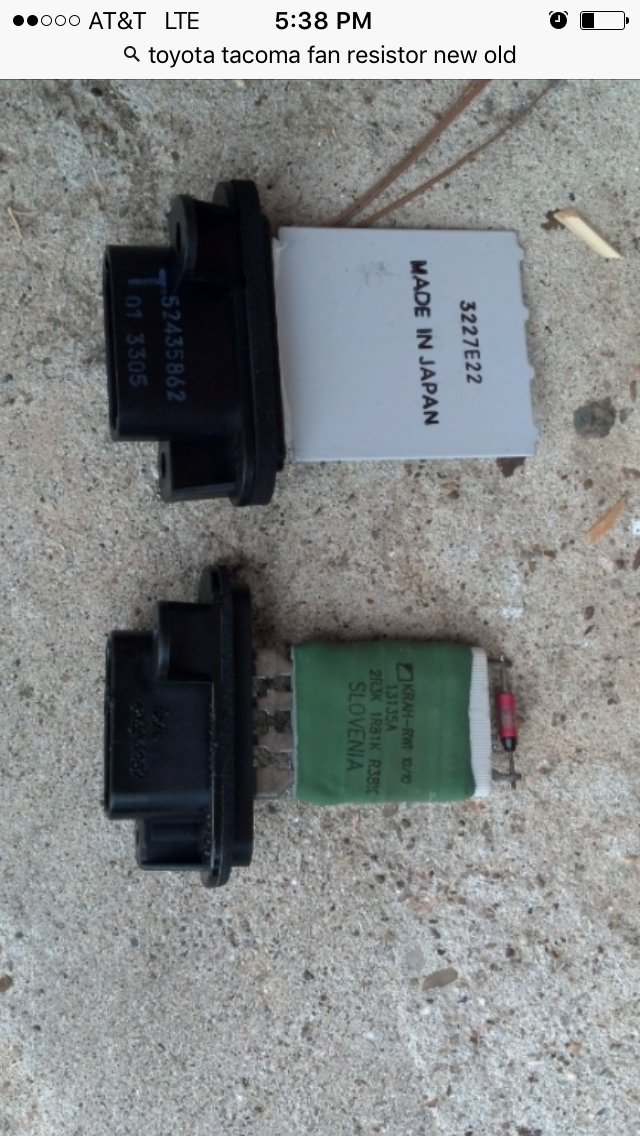

    How do I make sure I get the updated version of the resistor

    IMG_2269.jpg New style on top.
    I got mine on eBay.
    Also yes I had a burnt plug end and wire had gotten hot.
    I cleaned it up and it worked for about 6 months. Then I got the updated part and been good for a few years

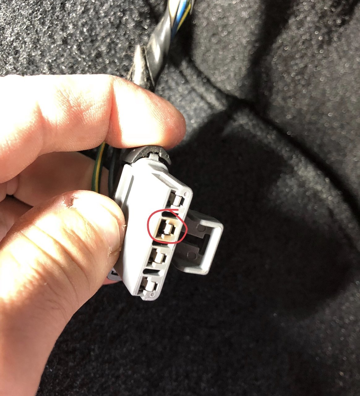

    3DA97A55-882D-4E6B-8098-08F920BC4D09.jpg I took mine apart. And i wish i seen that diagram on the post above mine lol. I guess ima have to take it out again

    Yup. Same thing happened to me.
