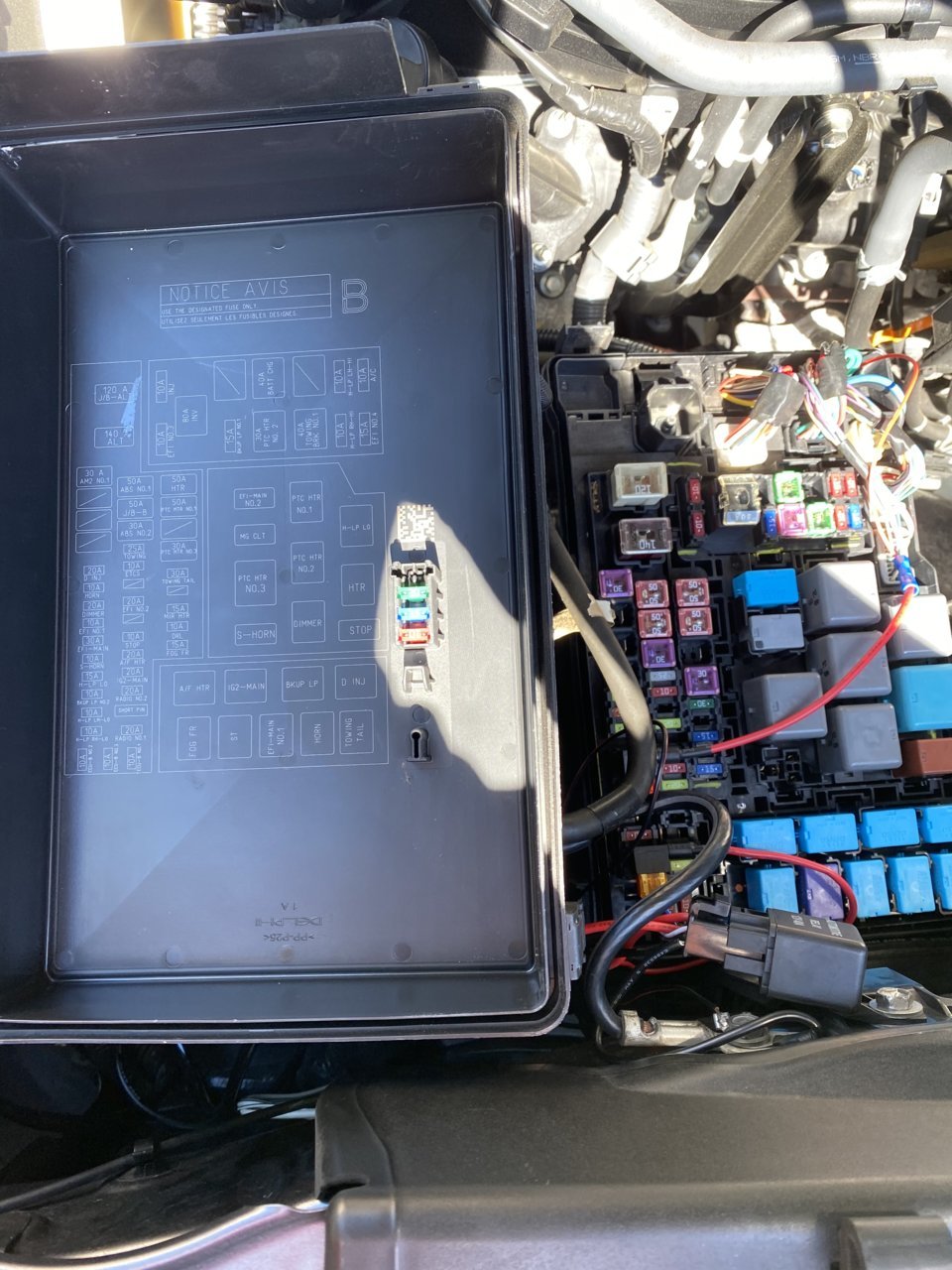

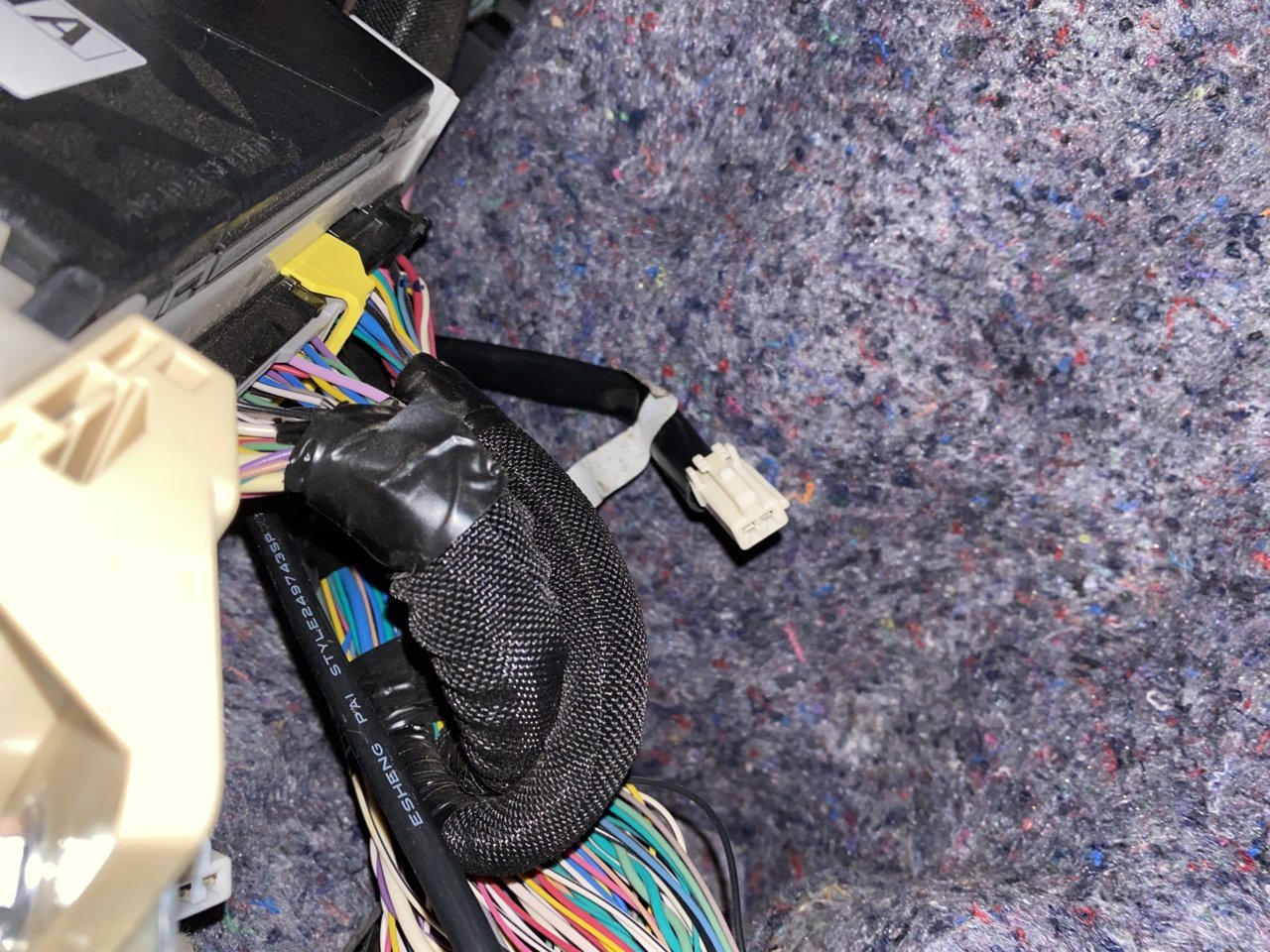

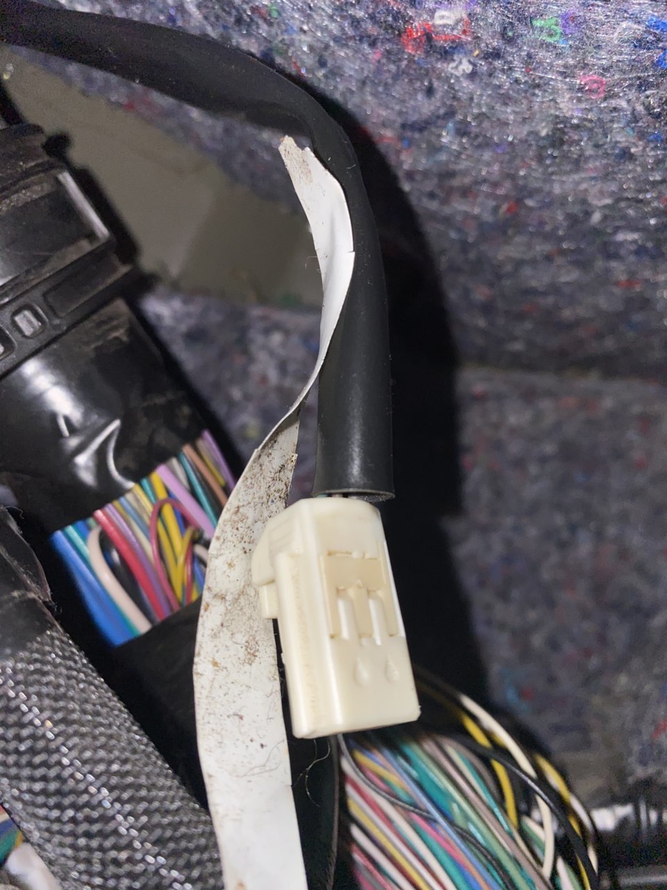

    The other day I installed Meso Customs puddle pods but I accidentally installed the wiring harness wrong. Now my A/C, power windows, and AnytimeBackupCamera do not work. My tire pressure monitor light also came on I pulled every mini fuse in my driver’s side fuse box (and all mini fuses under hood in the fuse box) and could not find any blown fuses. I read online my issues could be because of a blown IGN1 fuse so I replaced that and IG1 and IG1 n2 i replaced those anyway just to be sure and still had no results. I noticed this wire not plugged into anything behind my drivers side fuse box I am not sure if this is the cause of my problems. I could not find where this plugs into. Is there any way this would be the cause of the issues I have been receiving or is there anything else you could think of? I really appreciate all help :)
    I believe the wire may have been unplugged on accident while running the cable through the rubber piece on my driver door.
    09258127-71E0-471E-97FA-44B34452316B.jpg 73C7FBED-2520-4DE8-9DD8-5190DF2FD6FB.jpg

    Should be fuses under console by the hood latch

    Check your 50amp fuses #30-34

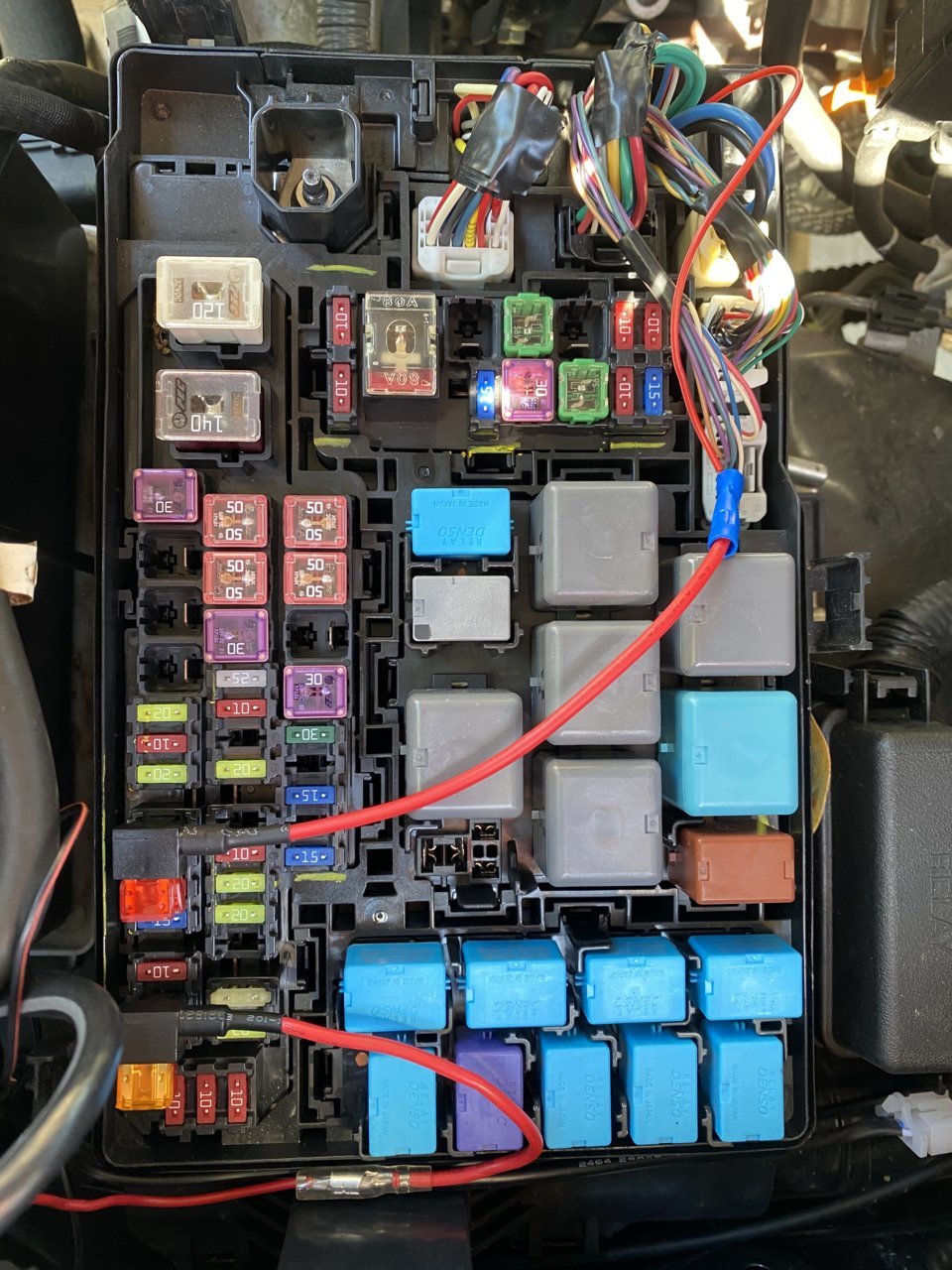

    574D301D-F14F-4439-80E5-0C1E2AD69E4A.jpg They all look good to me

    Did you check all of the big ones?

    Yes, I even replaced all of my 50 amp fuses

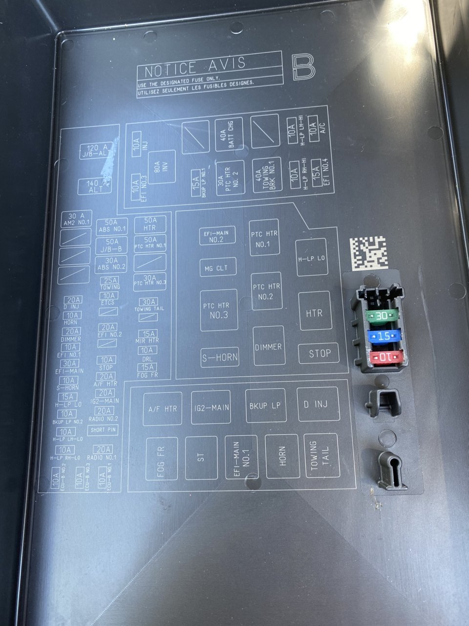

    Can you take a pic of the underside of your fuse box cover. It doesnt seem to be like the manual i found

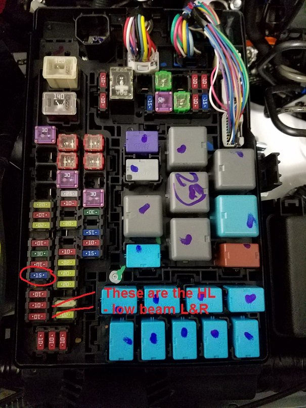

    Not sure if this helps but I found this pic online and it looks like my fuse box. I could not find a picture of the box cover. I will still get you a pic of the cover tomorrow

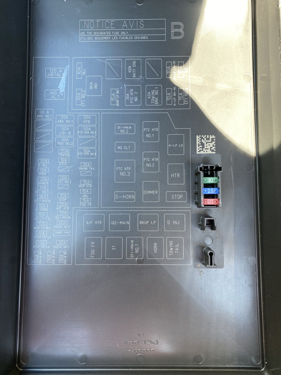

    1785D7BC-C9A9-4AEB-8819-9453B5A871EB.jpg 33B56DAB-4521-43C9-9CD6-428EA21263A4.jpg 9CA220AA-3CCC-4B89-B8CA-107E58106205.jpg
    here is a picture of my fuse cover and the inside of my fuse box
