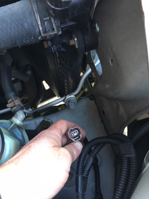

    I've been dealing with an A/C issue for the last few months. The compressor is cycling about every 10 seconds. I've had the system evacuated and recharged, replaced the compressor, compressor speed sensor and wiring harness. I've taken it to an automotive a/c "specialist" and was told nothing is wrong. I've checked periodically with a gauge manifold and confirmed there is a leak somewhere because the static pressure drops continually over time. But I just haven't found it yet. I'm afraid it's somewhere behind the dash, maybe the evaporator. Frankly, I'm sick of it at this point and need to take a break for a while. Plus, I live in the northeast, so working a/c is needless worry for about the next 7 months. I have read endless threads about rapidly cycling compressors and potential causes, so I'm not necessarily looking for troubleshooting advice, though it's welcome and appreciated.
    So, on to the point of my post: I was thinking about just unplugging the binary switch on the high pressure line to prevent the compressor from constantly cycling (and wearing out the clutch) when I'm using the defroster this winter. Is this a bad idea? Would doing this cause any issues elsewhere in the system? My thoughts are it would simply (and harmlessly) disable the compressor.
    Also, if I were to do this with no negative effects, does anyone know where I could get covers for the electrical connectors? (see picture)
    Thanks in advance!

    No, leaving the pressure switch unplugged won't harm anything. Dunno why you want to unplug it though; if you have a slow leak, eventually there won't be enough refrigerant left in the system to close the contacts on that switch anyway, meaning the compressor won't engage.

    Good point! But as of today the static pressure is at 75 psi, so it might take a while. Perhaps I'm worrying about nothing, but cycling every ten seconds if I have to use the defroster for an extended period of time just seems like it would cause premature wear on the clutch. I probably should just have the system evacuated.
