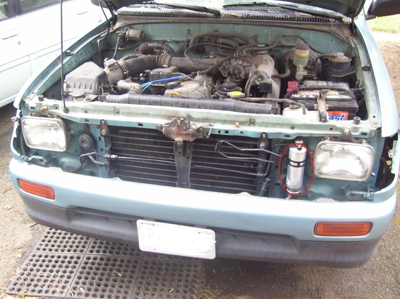

    Accumulator = Receiver/Drier and yes they do. Google search image below of location.

    Dah my bad. I was thinking accumulator like the old chevys had on the low side line.

    Ah I see your though process. All good man.
