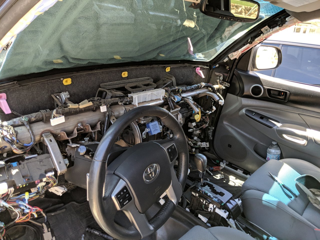

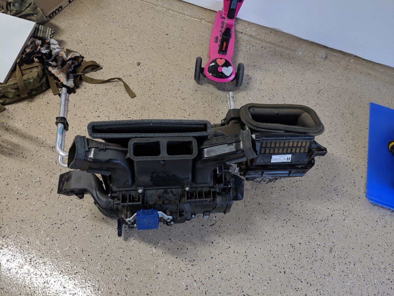

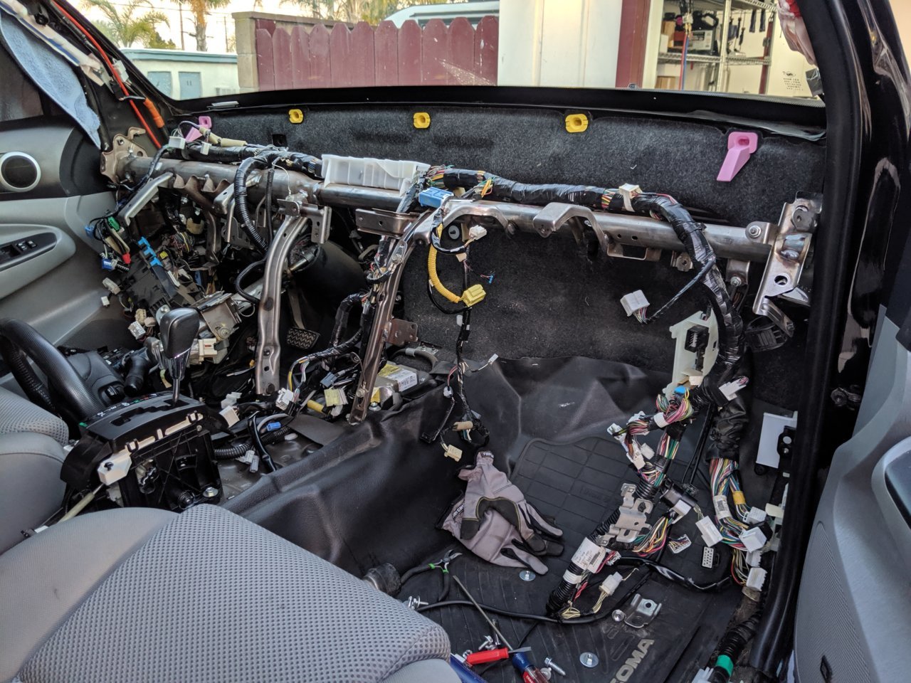

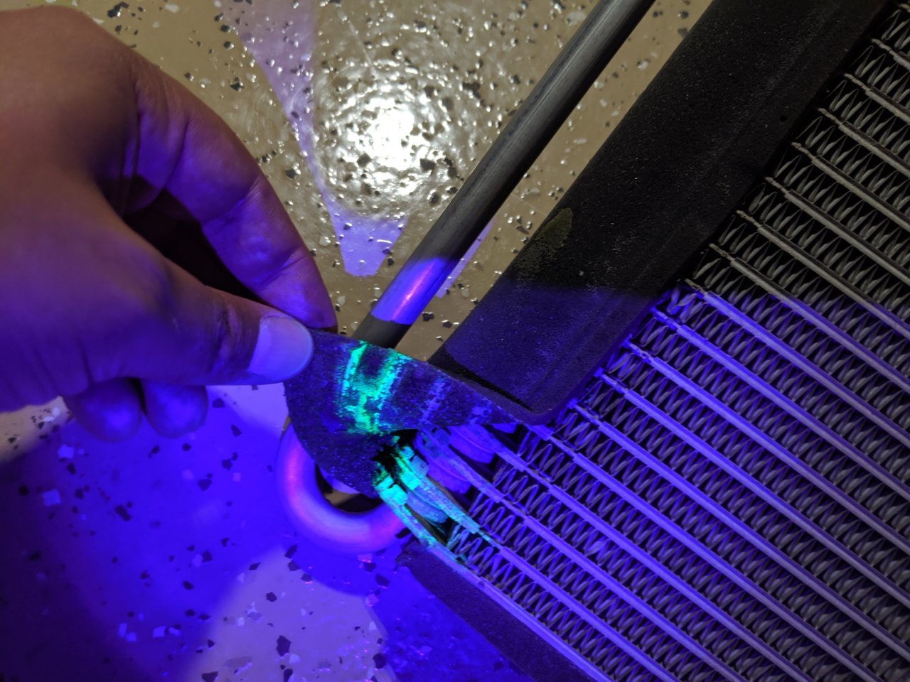

    I have a 2010 RC 2.7L, and the A/C suddenly started blowing warm on the passenger side, but it was ICE COLD on the driver's side.. Two recharges and more than a year later, my local Toyota stealership of all places used UV dye to track the leak to the evaporator core. This first showed up in June 2017, and I had the problem fixed for good in September 2018. My truck is 2010 but was manufactured in August 2009. This would make it almost eight years old at the time the problem started, and it had around 75K miles.
    I'm amazed that your truck is having problems at only four years old! After my dad's mechanic failed to find the leak twice in a row, I got desperate and took it to the dealer. DO NOT take it to the dealer. While my A/C is working great and has held a charge for almost a year now, it still cost almost $1,600 to fix. My new mechanic charged $1,100 to replace a leaky evaporator core in an FJ Cruiser, so I'm guessing it would be about the same for a Tacoma.
    Also, I asked the service manager to text me pictures of my truck taken apart for the evap core replacement; The whole dash had to come out and that's why it was so much more expensive than, say, a compressor replacement...
