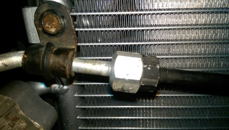

    Update:
    Got most of the parts that are easily flushed cleaned and blown out with compressed air. Did not find anything odd come out. I used a clean shop towel filter the air/solvent.
    I had a broke bolt on the dryer bracket, had to drill that out, that took some time. It takes a while to walk 200feet with crutches. Shh, don't tell the Mrs.
    Dryer is mounted, condenser is mounted. I have done no plumbing yet. I found several bad O rings. I have a kit, just ran out of energy last night. I decided to call it a night at 3 am.
    I am missing a long 10 mm bolt, the one that connects the line block to the condenser. It looks like it needs to be 1.5 or so inches long to go thru the block connector. I'll have to hunt around on the parts truck later tonight.
    I did take few pics, but honestly, changing out condensers and dryers is pretty straight forward. There is only one way they mount up. One note, when changing these parts, remove the hood latch and bracket, horn and of course the grill has to come off.
    Maybe I'll post a few pics just for the fun of it.

    Quick question on these connection.
    I noticed when tightening up the union, both but. Faces seated against each other. The connection feels right, but I'm not sure if one half is supposed pull the male half completely into the female half. Hopefully the pic will explain better than I can.
    Other than that, I THINK I'm ready to do the first test vacuum.

    used to have - 99 2.4L I4 5 lug & 04 prerunner v6
    I have seen some that bottom out like that and some don't with a thread or two still showing so it varies depending on the brand, the leak test says it all because its the flare and or o-ring seal that matters and as long as it seals you are good

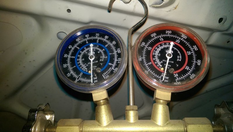

    Here is a pic of first, 15 minute vacuum. Wanted to record it with a pic so when I come back in 30, I can verify that test vacuum is holding. Cross your fingers.
  13. Jun 15, 2015 at 7:13 PM
    #33
    koditten
    koditten [OP] Well-Known Member
    Sep 8, 2013
    #112077
    19,794
    Kirk
    Central Michigan
    04 trd x-cab 4 x 4 3.4l
    Reserected from the dead.
    Valves on manifold gauges are shut off and pump is off. Timer set to 30.
  14. Jun 15, 2015 at 7:25 PM
    #34
    keakar
    keakar Well-Known Member
    Oct 2, 2014
    #139537
    5,258
    karl
    louisiana
    2006 4runner sport 4.7L V8 (white)
    ok, now if it moves any add nitrogen to it and do a high pressure test with 150 lbs in it just to confirm, forgot to tell you this is best done first to save time since it quickly shows any leaks but you don't "need" to do it if it holds vacuum.
    since the system was dry I recommend to add one can (usually 1oz) of refrigerant oil at the beginning when you first start adding Freon. I only recommend adding oil like this to dry systems because it replaces the film of oil that normally covers the tubing all throughout the system.
    its important to note that sometimes you have slight leakage at the hose fitting connections or the connections to the gauges so if you think you might see a change retighten the connections and retest before you assume its a leak.

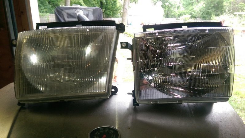

    Just killing time. Since I had the grill out and had new lights, I went ahead and installed new lights. Holy shit, what a difference. I had even polished my old ones and thought they were decent, was I wrong.
  16. Jun 15, 2015 at 7:29 PM
    #36
    keakar
    Oct 2, 2014
    #139537
    5,258
    karl
    louisiana
    this is what I was trying to tell people but its hard to get across until you set them side by side because people go from yellow to what you had and swear they are clear as new but you just cant ever get that clear by polishing them.
    a 1/4" tiny ratchet and 4mm socket fits the adjuster to set them correctly, I assume you know how to do that but if not this explains it: https://www.youtube.com/watch?v=qDudMM4J-ZE

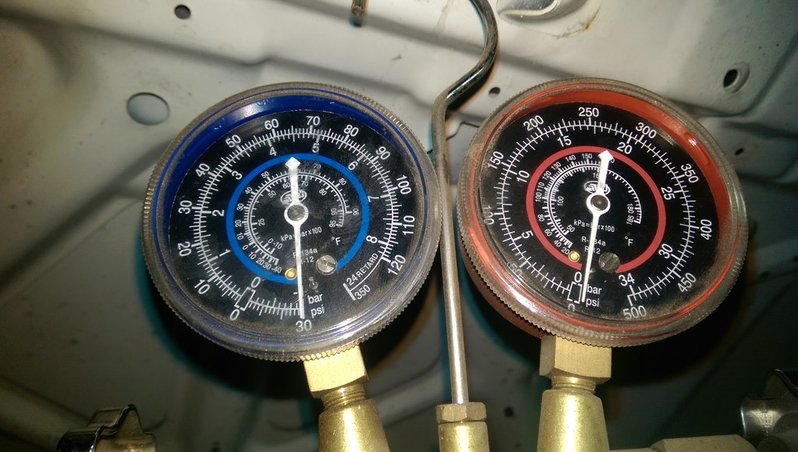

    Here is the after pic. I've looked at them very close. I can see no difference readings. I think I have a tight system. That's a lot of pressure off me.
  20. Jun 15, 2015 at 7:56 PM
    #40
    keakar
    Oct 2, 2014
    #139537
    5,258
    karl
    louisiana
    long as you don't rush anything it usually goes very easy, you will need to jumper the low pressure switch to recharge it and I suggest you put the oil and half of the first can in or as much as it will take in, before you even start it up.
    I think the cans are like 12oz (I forget) but you loose whats in the hose so maybe 10-11 oz per can is what you get in the system out of each can.
    as its running it will be full when you feel "ice" cold holding your finger to the bottom of the large tubing coming out of the evaporator, that signals its filled with liquid and the system is full. it should read around 40 lbs low side at idle and about 35 lbs low side at 2k-2500k rpms
