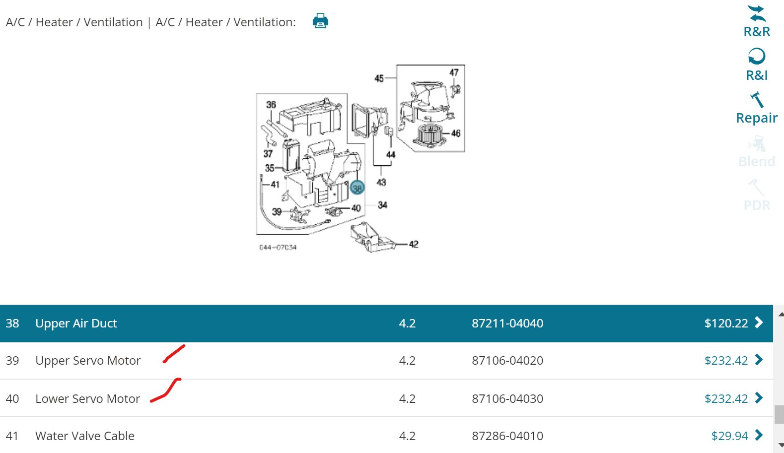

    post a pix and lots of guys here will tell/show you where this servo is
    i did find this

    ouch see that 4.2? tht means 4.2hrs to install
    labor description says:
    R&R Complete, Includes R&R Evaporator Assy, Glove Box, Glove Box Reinf & Inst Panel Finisher, w/ A/C Add 1.0
    that is not always the case, sometimes you can get to the servo by contorting your arm/body to remove and install
    once you get to the point tht you can see the above box^^^diagram
    you can determine which servo is bad by turning knobs on the HVAC panel while your hand is on said servos
    if you feel something moving/clicking....that servo is good
    if you feel nothing.....there is your issue
