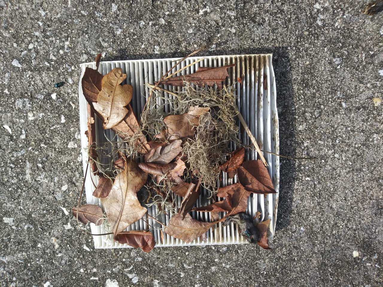

    My 2020 just turned a year old (10 k miles). I noticed this morning when I put the AC on a foul odor came from the air vents... smells like dirty socks... what are the best ways of getting rid of this? I watched a YouTube video and sprayed Lysol into the intake vents there in front of the windshield. Will that take care of it?

    Hopefully it’s not a Freon leak, those have a very distinct smell.

    Have you changed your cabin air filter?

    Turn off recirculate for a few minutes while running the AC.

    Pull your air filter and see if dead vermin are there.
    If so, we'll give you a link on how to prevent that.

    I took out the cabin air filter and look what I found. There were actually maggots in there along with a small dead mouse.
    How could a mouse get in there?

    Maybe you should just pop the hood open and look for any chewed wires and nests. Just to be sure. They are sneaky and have gotten more than one fellow member here. More than likely it came in by the vent for fresh air whish is in the plastic cowl behind the hood, bottom of the windshield. He looks small so they can fit anywhere...

    I was shocked to see the air filter like that. It actually had maggots crawling on it from the dead mouse. :eek: I ordered a new Fram filter from Amazon and it will be here tomorrow...
    Thanks Clearwater! So... How do I prevent this from happening again ???

    Wow! That happens a lot actually. Definitely check your engine bay for any chewed up wires. I would spray lysol disinfectant everywhere cause those rodents are quite nasty. Glad you found the issue! I was going to mention what someone else said to use evaporator cleaner

    Here’s a thread on putting in some screens around the air intake areas to help with this very problem. :thumbsup:https://www.tacomaworld.com/threads/cabin-air-intake-screen-mod.566441/
