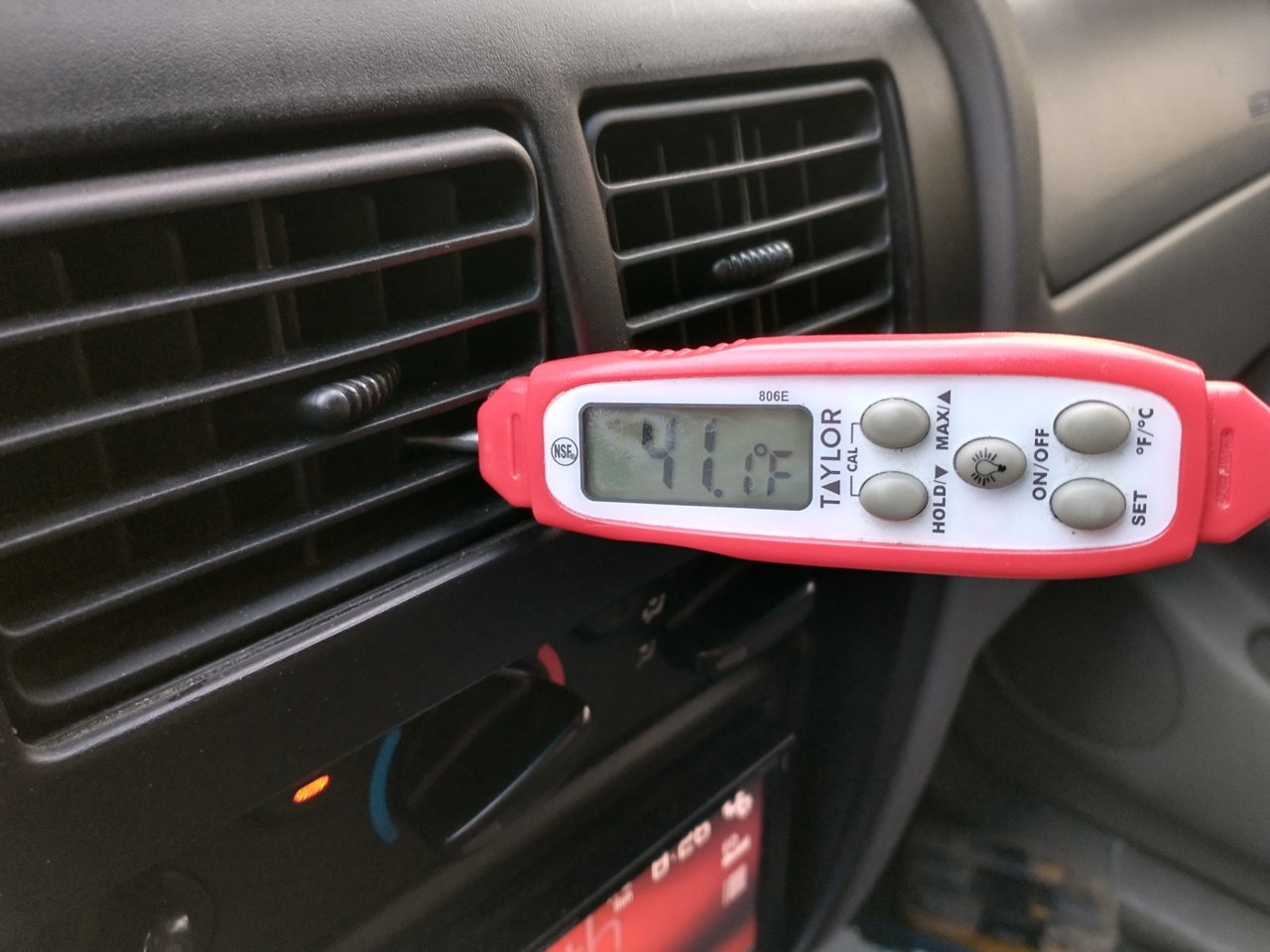

    I just finished charging the system with r134a and see UV dye. She blows coooooooold now.IMG_20220425_190106669_HDR.jpg
    I put a vacuum on the system yesterday and it was at -30 before I drove it today. Before I recharged the system it looked like it was -26. Does this confirm a leak or is it normal after turning the car on and driving for that pressure to change a little?

    You’ve got a leak.

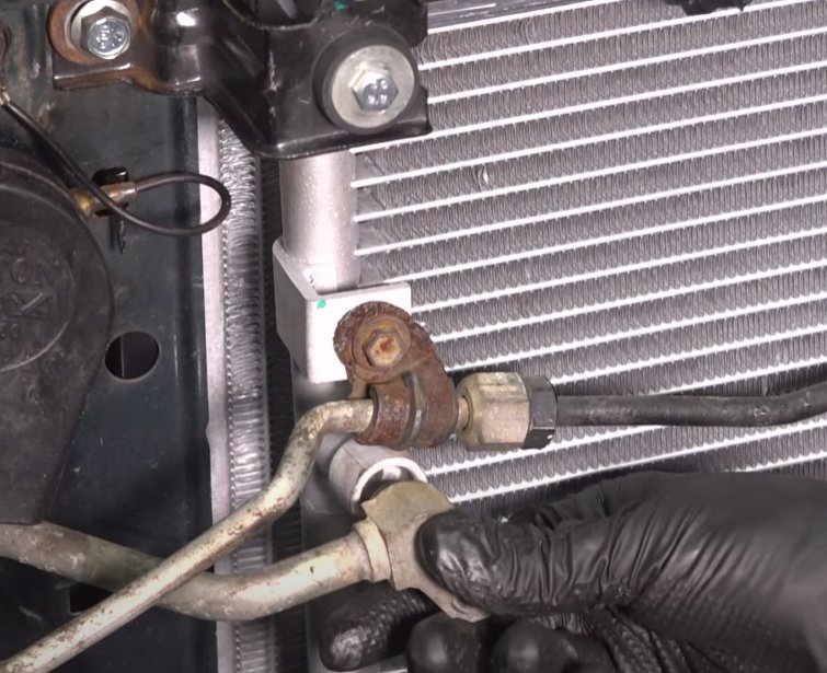

    *** Update ***, parts were a bit more expensive for OEM (or Denso) than I thought. Currently about $800 for me. Another $50 because my crap was so rusted on my power steering pump the dang bolts snapped. Other than that everything is going good. I am about 90% done now, just gotta add power steering fluid back to the pump and hook up the AC Dryer (still waiting on it) and then recharge the system. Really not that hard of a job. Just tedious.
    Also, does anyone know what part this is that hold the AC line in both the engine and across the Condenser? One of them was so rusted it wouldn't come off the old Condenser. I asked Toyota for a part number but they couldn't find it. Searching rock auto and parts geek doesn't show anything either.. I might have to make something myself.
