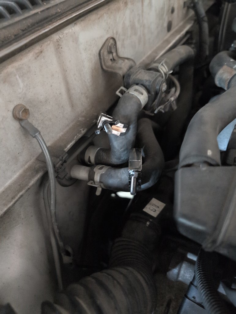

    I'm still getting heat.
    Maybe these clamps are crap and aren't actually fully closing off all the fluid.

    I can see the clamps are not as wide to pinch the entire hose.
    Use the heater control switch to cut off heat - verify the switch behind the firewall (on the engine side) to moved.
    Move the 2nd clamp to be just behind the 1st clamp (on the hose with the heater switch. 1 clamps in one direction, mount the 2nd clamp 180 degrees so the entire hose pathway is closed. At least you can close off the primary flow path into the heater core. Check, you shouldn't have any heat now.

    I ordered some better clamps to cut off the heat. I will get back to you on maybe Tuesday after they get in. Thanks

    Alright the new clamps worked. It cut off air to the heat. It was blowing normal air after doing that.

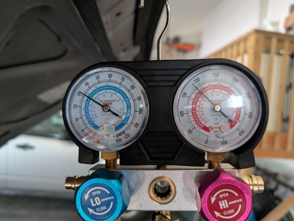

    However, I'm still only getting temps in the 48-50 degrees on a low humidity 85 degrees day. Here is my current pressure readings
    I think I may have a leak with the shrader valves. When I pull a vacuum and they are pressed down I don't get any leaks. When they are depressed and normal it seems the coolant pressures are slowly going down. What do you think?

    Did you verify the valves with a UV light? It seems to me if you have a leak, your system will go flat after a while because the freon is lost. How long has it been since you recharged the system? How many miles have you driven.
    Everything you have described sounds like an inefficiency problem. Read this article: https://davesoilchange.com/too-much-oil-in-ac-system-symptoms/

    I recharged the system 10 days ago, have driven the truck maybe 20 miles.
    I added the same amount of oil as Toyota recommends to the system. I added the exact amounts as others have done. 100 CC to the compressor, 40cc to evap and condenser, 20cc to dryer. It seemed like a lot to me, but Toyota recommends 7oz for the system. To my knowledge the only device that needs oil is the compressor and if denso says 100cc is enough... Why would we need to double that?
