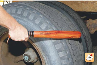

    Resistor. Easiest way to verify, next time it doesn't turn on, give the bottom of the fan a smack. I keep my tire bat by my pass seat for that reason.
    Kinda reminds me of my grandmas station wagon when I was a kid. Had to smack the starter with a hammer every now and then to get it to work. I don't recommend a hammer in the fan though.

    Tire Bat?
