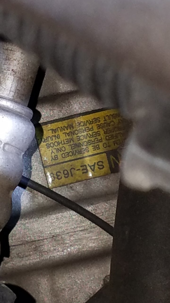

    I had mine done by an aftermarket company, but that was 20 years ago, they are still in business but not sure if the kit is available.
    Whatever kit it is, it works fantastic zero issues over the last 605,000 miles.
    Just needed a new compressor at 450,000 mile.
    You could call MAXAIR in Colorado Englewood, they did my install with the kit.
    It was expensive back then like 1500 if I remember but 22 years later worth every penny.
    Here is a picture of the compressor, maybe you can track it down that way.
