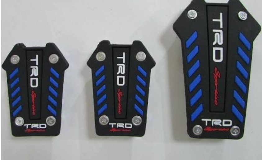

  5. Nov 15, 2019 at 2:32 PM
    ChiCAgoTako
    ChiCAgoTako Well-Known Member
    Jan 30, 2019
    #281300
    126
    2019 TRD Sport DCSB 6MT MGM
    You could put some universal pedal covers on, will give you about 1/2"? I...I mean a friend, did that and he likes having a larger pedal area too. :crapstorm:
    Just search online, there's a bunch out there. These are the only "TRD" ones I found from a quick google search.
