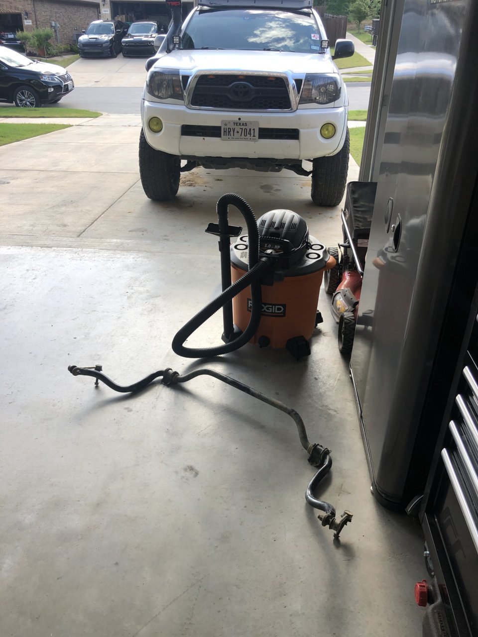

    Swaybar is out. Tightened everything down but still hearing the pop. Sounds like it’s coming from the passenger side and only makes the noise when im turning. Really weird. Might try and turn the coilovers down half an inch of lift tomorrow.
