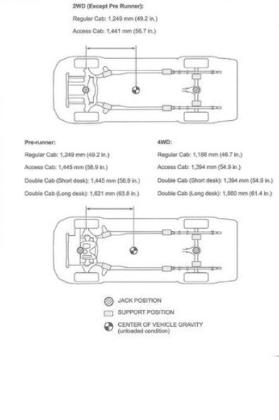

    Now I live in a house with project space and can do all four wheels at once. I know this has been asked and I've gone and read but still a little confused. Can anyone give me pictures and a step by step short guide on jacking points and how/where to put jackstands please?
    I know the front gets jacked up by that circle in the middle near the skidplate but I will only be using the provided spare tire jack is that enough to get it off the ground to get two jackstands under? Should I use a small piece of wood in-between the spare tire jack and the truck so not to damage the frame? Where do I put each jack stand? And people said do not jack the rear from the pumpkin for jackstands, so where do I then?

    I place the jack stands along the frame between the wheels. It depends on the balance point and where they get in the way.
