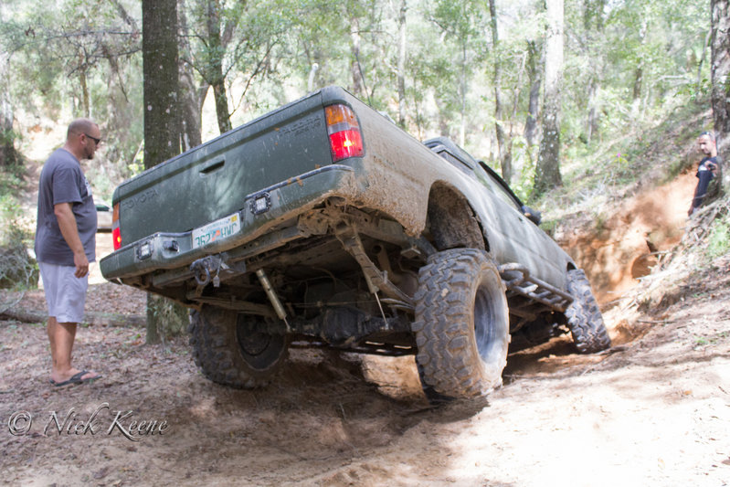

    OME 3" lift with Dakar rear leaves and 883 front coils. 36x12.50 Super Swamper TSL/SXs on Pro Comp Series 97 15x8 Steelies, Bud Built Front Skid, 4xI rock sliders, 4.88s and an Eaton True Trac LSD up front, 4.88s and a Detroit Locker in the rear, LED cab clearance lights, Sway Bar Delete, Rear Diff Breather Mod, Autometer Monster Tach, Cobra 25LTD Classic, Roof-mounted 3' Firestik Firefly, Garmin GPS, HiLift Jack, Flush-mount LED pod lights in rear bumper, 28" light bar in the front bumper, rear shock relocation (Ruff Stuff brackets), u-bolt flip with Ruff Stuff Anti-wrap perches, CBI rear frame reinforcements, 10" travel Bilstein 5125 rear shocks, heavy duty front crossmember made by Allenfab, Rear shock mounts/crossmember (for upper mounts), spring perches, frame plates, and front crossmember welded in by Allenfab, CBI Ditch Light Brackets, Ditch Light Pods. AllenFab Custom Hybrid front bumper and recovery points. Drivetrain lifted 2" in conjunction with a 2" BL. Modified Trail Gear transmission crossmember/skid. Warn Xeon 10K winch. Large left side body mod.

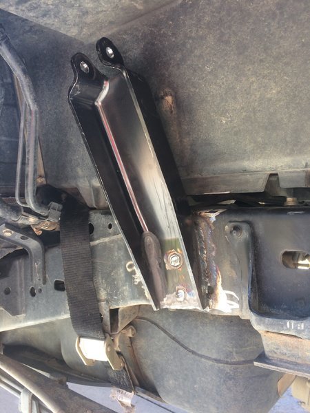

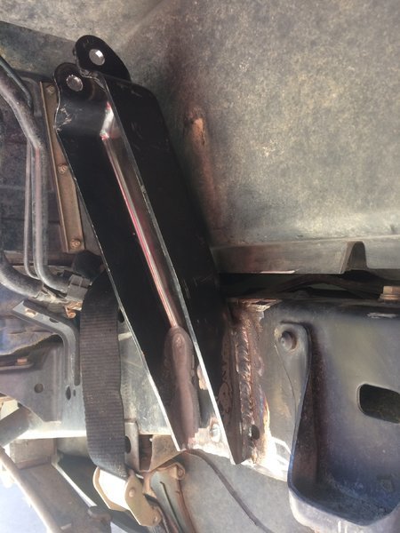

    That's a large lever arm you got there, any plans to reinforce them?
    Looks good though :thumbsup:

    Thanks! We talked about it during install but it is sturdy as hell and just beat them pretty good in N. Georgia mountains with no issues

    Looks good. was thinking of these the other day. I'm using them on a totally different project and they are awesome.
    I agree with you on not needing to reinforce them much more. they are nice and beefy and rear shocks do t have to take huge forces.
    On my use I did "straighten" them. might give a bit more room from the tire doing that but not sure how close to the bed the mount is already

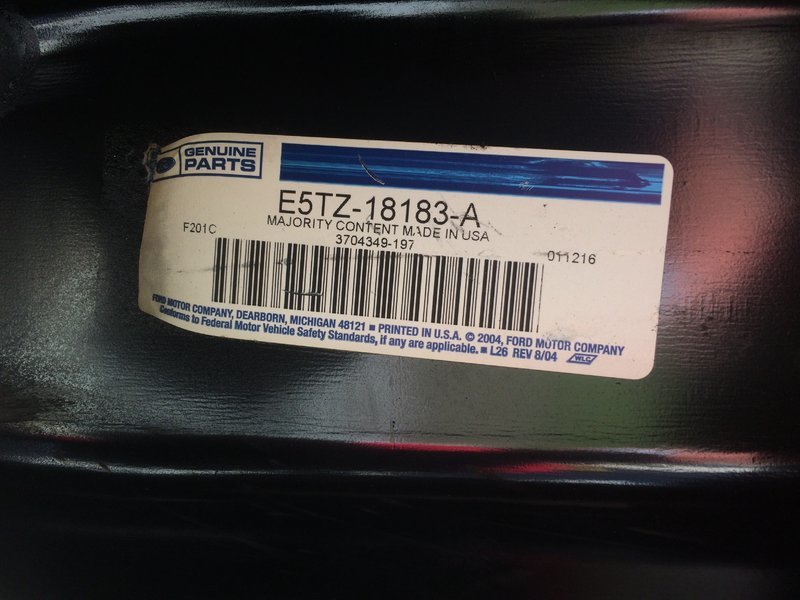

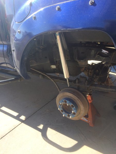

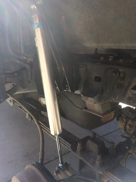

    From what I've found online....the 14" 5125's are 46mm ID ~ 1.8". You think this relocation can clear 2.0" or even 2.5" shocks?
    @Rattletrap66
  11. Dec 6, 2016 at 10:54 PM
    #51
    12TRDTacoma
    12TRDTacoma Powered by Ford, GM, VW, and Mercedes
    Aug 20, 2012
    #85133
    16,671
    Rob
    Concordia
    Boosted
    Holy shit @Rattletrap66!! Great work bud! :thumbsup: where did you get your Chevy 63's from? Looks like I just found my new economy project for doing the rear end. These would work great with some 2.0 Fox Resi full eyelet shocks in the rear, not to mention be a hell of a lot stronger than stock.

    Thanks! Local auto salvage had them for $100 for the pair, they pulled em too

    Holy crap. That's dirt cheap. They bolt right on or what?

    1997 t4r has super duty axles, 5.13s locked front and rear. 3 link front with 14" kings. Rear 63s.
    Weld on

    2 days max. I did one in a day but he already had the tank removed @xweslingx

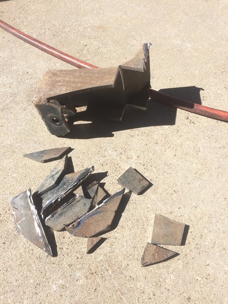

    How long did it take you start to finish to git 'er done? All the work plus the removal of those BS 2 inch thick stock rivets on the shackles is what intimidates me to do that work. It took me forever to get out the rivets on the bump stop striker pads.
