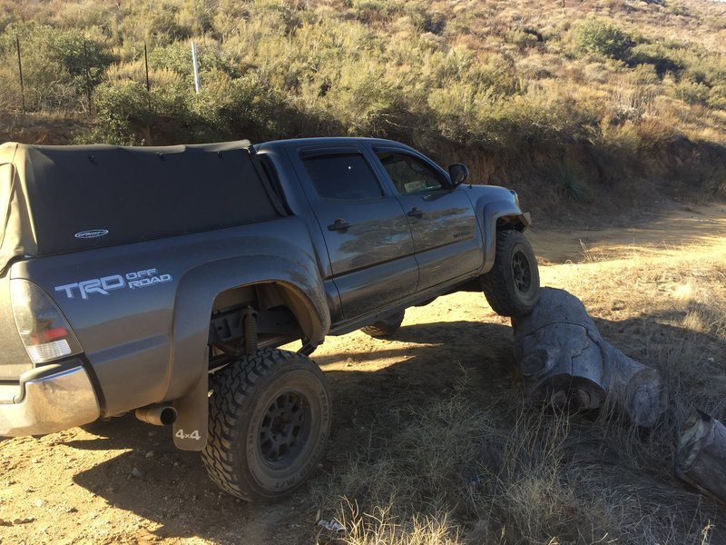

    Frank, @Rattletrap66 With the new shocks, did you gain more wheel travel?
    Have you measured center hub to fender with your new setup?
    like this?
    Curious how the chevy leafs work. thanks.
    Holloman and Rattletrap66[OP] like this.

    I did measure without any shocks, can't recall the exact numbers but it was close to 18" of travel. I can get some measurements with the shocks in for you this weekend

    Well that works too.
    I calculated my max wheel travel at 13.25, while measuring fully compressed and at droop. Thanks.

    10-4, right now with the 14" shocks in I am at 9" of droop and 5" of compression

    @Crom where were your measurements taken from. When we get a little better weather, which is a term we don't use everyday, I'm going to put my Archive Shackle flip on then most likely go this rout. But before I do, I can measure from the same points to compare between your setup, the Chevy 63" swap, and the shackle flip. There will be some differences obviously due to the different leaf packs, but it will give a more definitive answer for comparison.

    by the looks of the picture, top of the tire to the bedside but to be more exact with varying tire sizes, I would do center of wheel to bedside
    edit: nvm, I guess it doesn't matter since you would be getting travel numbers from those measurements

    I plan on removing my shocks and flexing the rear out, measuring a mocked up tower eye to eye at full droop/compression. I guess I could just measure what I have now, but I know my 5125's are already my limiting factor.

    Center hub to fender at max compression 18.75"
    Center hub to fender at max droop...........32.00"
    Subtracting I got 13.25" of wheel travel.
    I'm happy with what my truck does. :)
