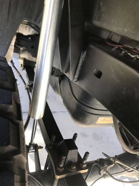

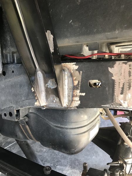

    Ford ran these towers in the front end with 2 rivets not fully welded and plug welded where the factory rivet would go. Most of the time when I was researching the towers before ordering them for frank was some of the older trucks like the samurai, they were tearing the frame so they put a plate on the frame then welded the towers. No one ever braced the back from what I found.

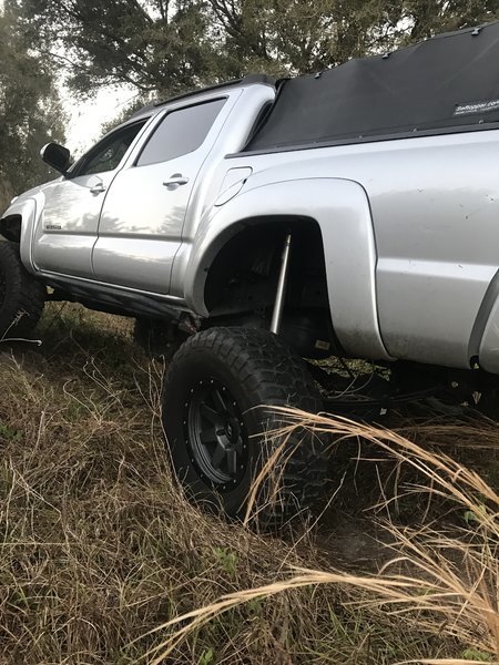

    Forgot to add my pictures

    Looks right at home in the fender

    Does the top of the tire hit the shock when fully compressed? I can't tell how far outboard the shock is (next to the bed) from your pictures.

    No issues and love them. Only thing I must advise is having a offset wheel or you need to cut the angle out of the mount and adjust it in some. I slightly rub the shock body when stuffed.
