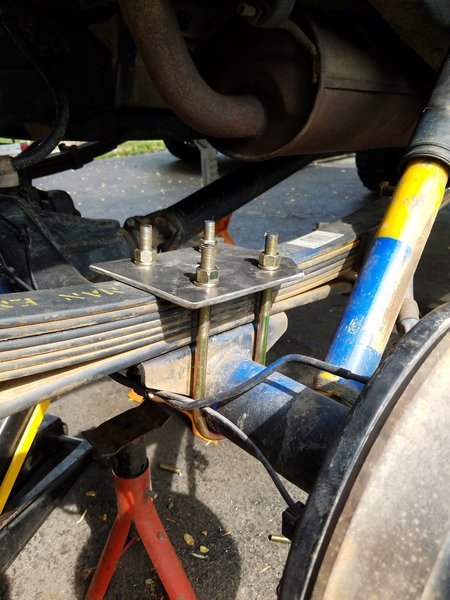

    I ordered the curved shock tabs from ruff stuff and 35x12.50. I wanted a wide stance to keep it balanced. They don't stick out that bad really and quality spacers don't bother me at all

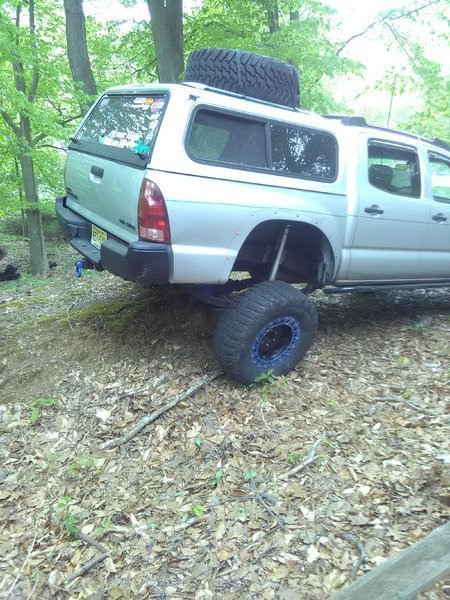

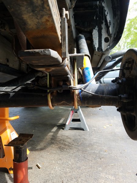

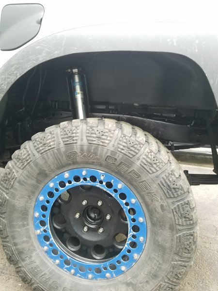

    I just did this, I shimmed the towers to bring the shocks in but they still rub at full stuff so I'll be going with 3/4" spacers. both shocks in front of axle and lower shock mounts in line with bottom of axle tube. The Dakars limit travel up and down now....about 12" of travel with bilstein 14" shocks and home made shackle flip
