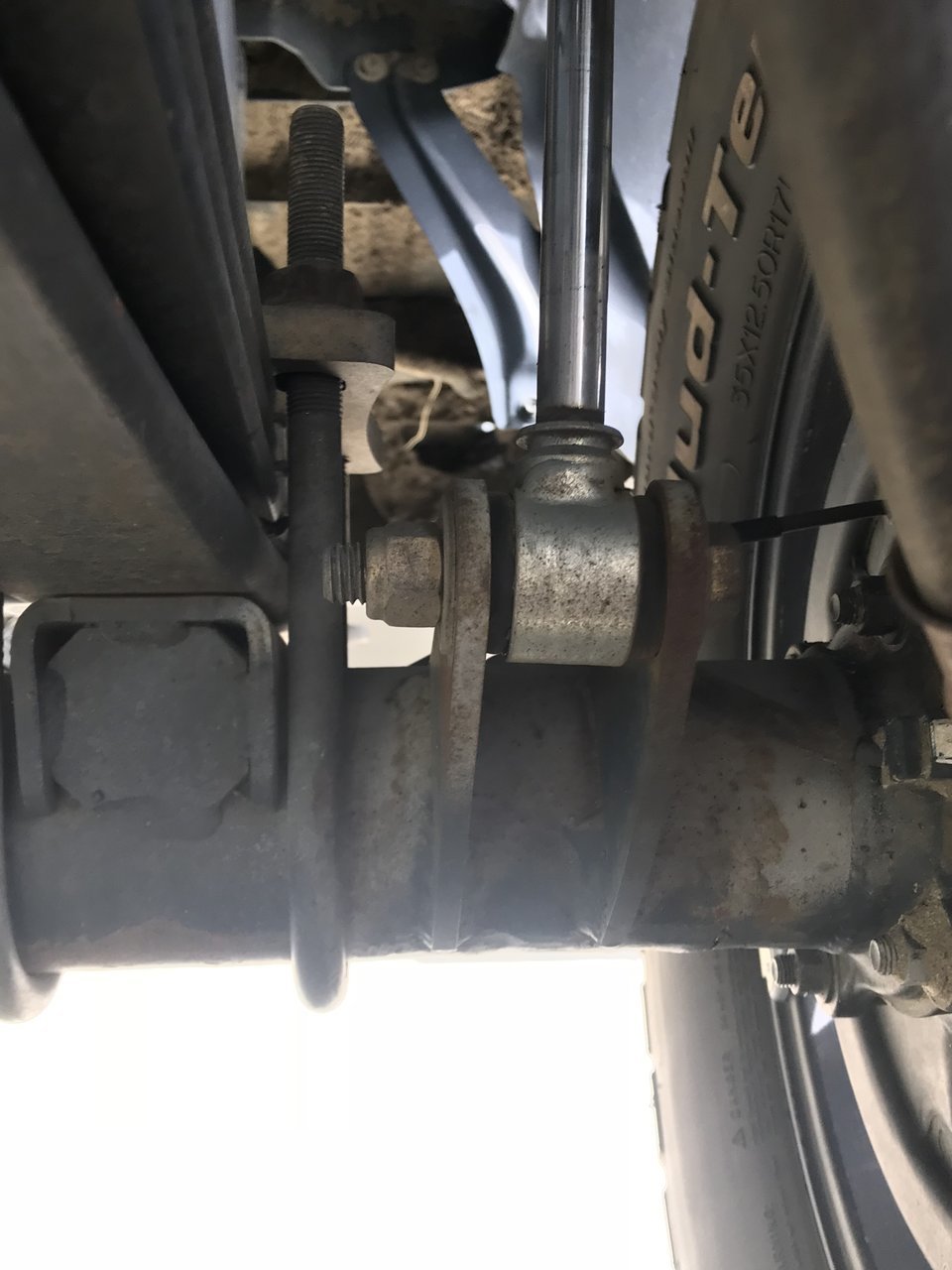

  14. Jan 9, 2018 at 1:55 PM
    #134
    Sub-Zero
    Sub-Zero NOOB
    Oct 15, 2014
    #140388
    4,527
    Frederick, CO
    '06 DCSB
    None
    Here's my lowers, both sides in front of axle
    Holloman and Sicyota04 like this.
  15. Jan 9, 2018 at 2:04 PM
    #135
    stronghammer
    stronghammer STTDB
    Jan 8, 2016
    #174366
    35,132
    Scotty
    Huntsville, Alabama
    2011 MGM DCSB TRD Sport 4WD
    Why both on front
  16. Jan 9, 2018 at 2:13 PM
    #136
    Sub-Zero
    Sub-Zero NOOB
    Oct 15, 2014
    #140388
    4,527
    Frederick, CO
    '06 DCSB
    None
    I like symmetry, plus I would think it helps slightly with axle wrap, although probably not much. It's possible that it's easier to mount the uppers forwards of the axle due to clearance with the bed but I don't remember
    stronghammer[QUOTED] likes this.

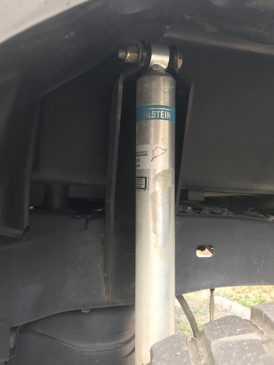

    #138
    scocar
    scocar Patron of the Farts
    Nov 11, 2009
    #25814
    40,175
    Are those witness marks on the shock body from your tire when stuffed?
  19. Jan 9, 2018 at 2:26 PM
    #139
    Sub-Zero
    Sub-Zero NOOB
    Oct 15, 2014
    #140388
    4,527
    Frederick, CO
    '06 DCSB
    None
    I think about 5", never measured it tho. I'm not running bump stops
  20. Jan 9, 2018 at 2:32 PM
    #140
    Timbo's Customs
    Timbo's Customs Well-Known Member
    Aug 8, 2013
    #110078
    7,266
    Timothy
    Lakeland FL
    2019 f250 6”lift 37s deleted 1997 T4r, tons and 4ds
    1997 t4r has super duty axles, 5.13s locked front and rear. 3 link front with 14" kings. Rear 63s.
    Yes. Since I’ve done a few I’ve started cutting them in the middle and pushing them back and re bracing the bracket. Stock wheels will eat the shocks using the towers. Plus 63s will go pretty far into negative arch when flexed
