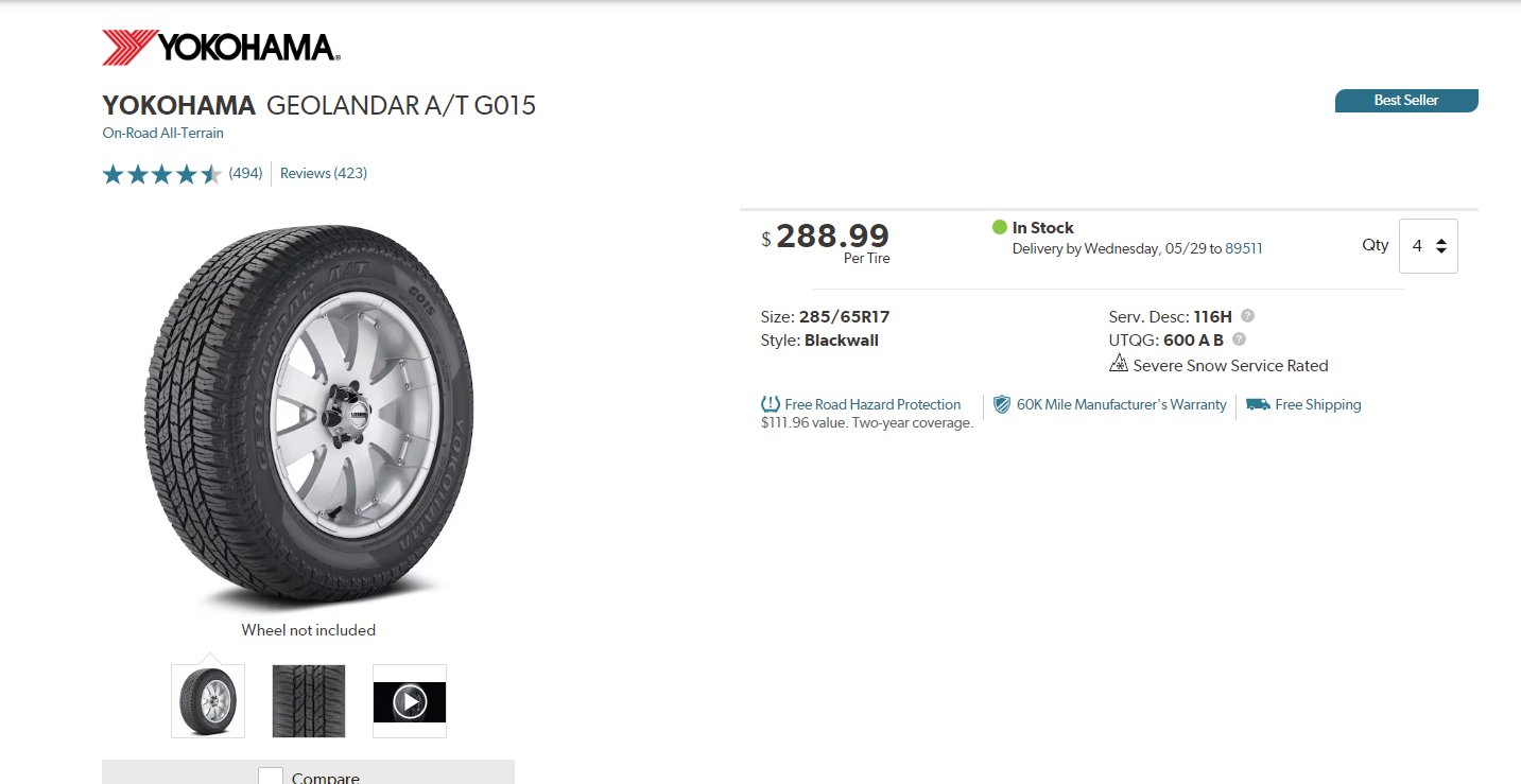

    Here is that Yoko. Maybe it's a Tire Rack exclusive? Or it's discontinued and they're the only ones that have stock? 31.5" tall

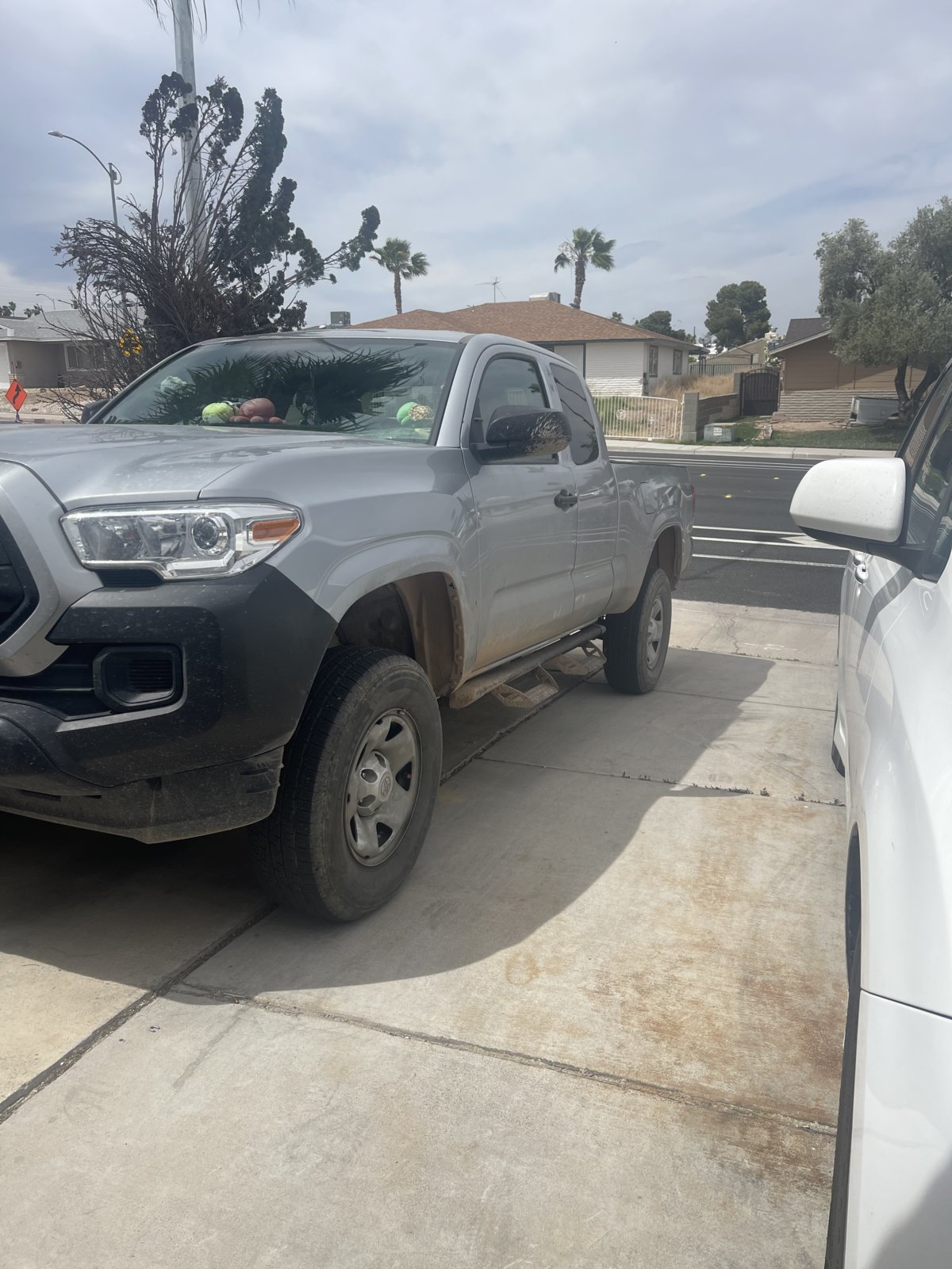

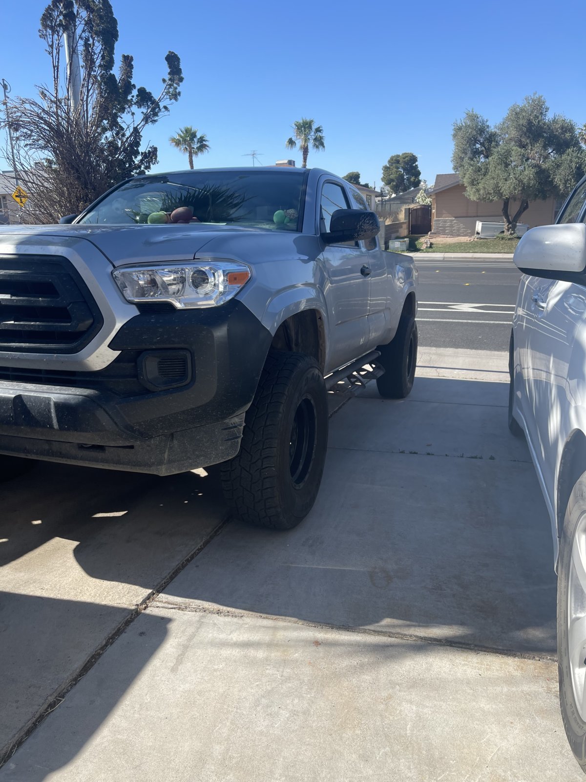

    I have 285/75/16 on a 2022 sr access cab. With a -22 off set and they rub like a mofo in reverse

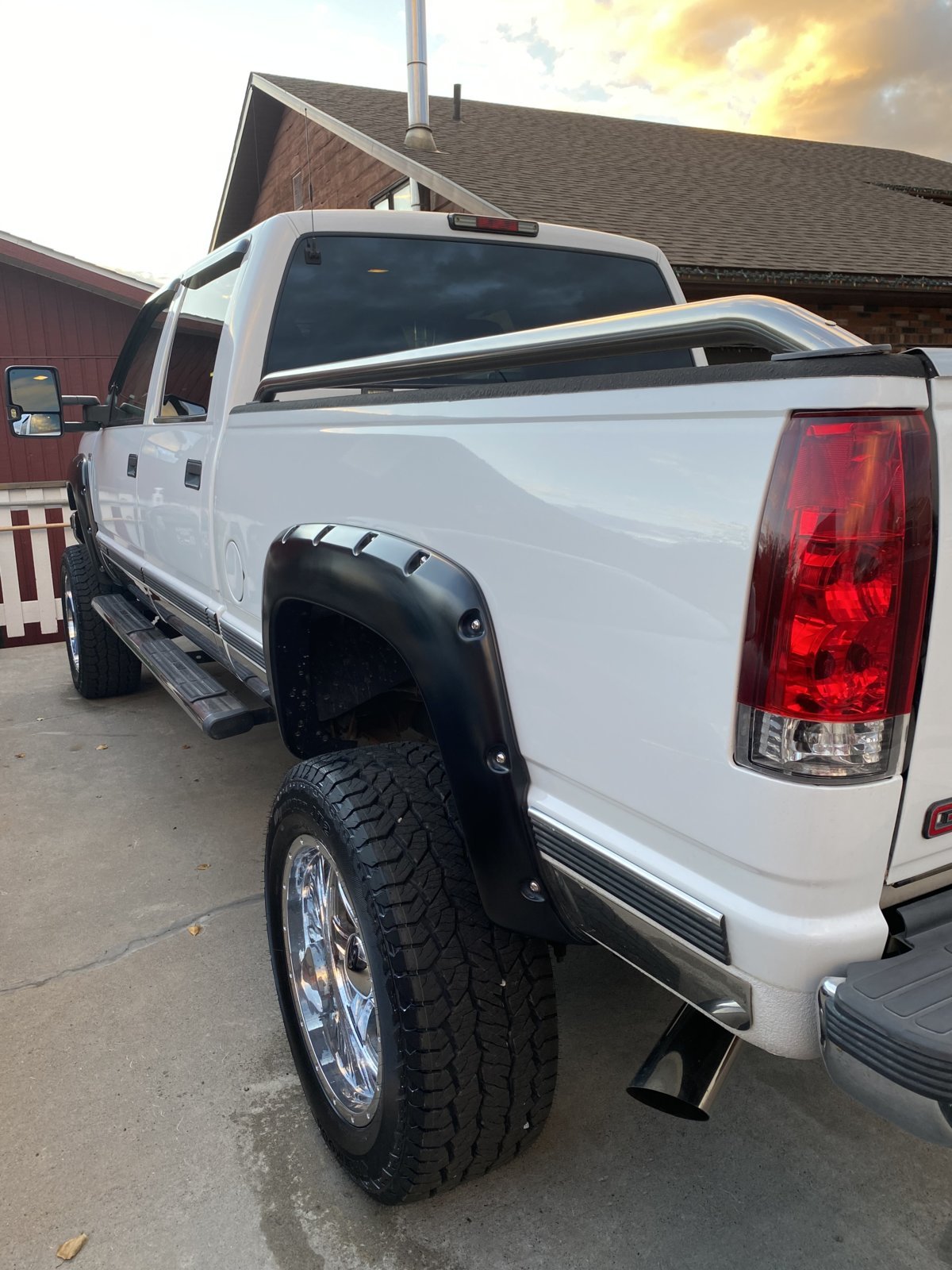

    @lundy for reference as to my wheel/tire preferences - this is my previous truck (I downsized...) LT305/55 on 20x10 Predator 8. It took alot of money to properly swing that combo on a 99 GMC k2500 - I am older and trying to be wiser as I choose wheels/tires for this new to me Tacoma :)

    Silver rims are 245/75/16 what came stock on it black rims are 285/75/16. And I’m still trying to work out the kinks hopefully don’t have to do a cmc

    @2022tacoma do you have aftermarket/adjustable UCA's? Sometimes getting the caster closer to positive 3.5-4.5 degrees will kick the wheels forward and get them away from the cab mount.

    No I don’t everything is stock besides. The 3 inch rough country lift and raceline -20 offset wheels
