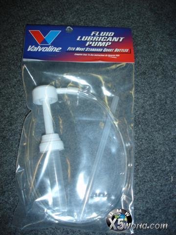

    Without comparing side by side, I think mine is bigger than yours. :)
    I have a quart one that I used to use and the one I listed moves so much more oil it is amazing. I would use mine on quarts as well just because it pumps so much faster.
