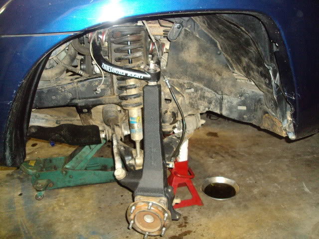

    Ya know, I've installed 2 sets of 4" Camburgs on guys trucks & IIRC I think they still ended up chopping the mount, crazy...
  14. Aug 30, 2014 at 3:33 PM
    Fiend13
    Fiend13 Well-Known Member
    Jul 3, 2012
    #81853
    4,706
    Chad
    Waddell/Phoenix area
    08 TRD O/R DC Prerunner
    Was that with stock shocks? I was wondering if the bilsteins set at .85 with the spindles (almost 7" of lift) would require it. Granted the ride would be rough as shit! Once I get the spindles I'm gonna re-do my setup and have it sit just high enough to tuck in 35's, so mate 4.5" of lift or so. It'll ride a lot smoother then
  15. Aug 30, 2014 at 3:55 PM
    4WD
    4WD cRaZy oLdmAn
    Jul 2, 2009
    #19185
    23,530
    Doug
    Lakeside, Ca / Gardnerville, Nevada
    2004 DC TRD 4x
    Grey wire MOD, deck plate, diff breather MOD, 2nd gen. OME 883# on Tundra 5100's, OMD custom 3" leafsprings, rear shock relocation, Ivan Stewart TRD rims w/285/75/16's, '02 bumper MOD, Famous Fabrications sliders , LED interior/exterior lights, bed bar, Custom tube bumper, Old school KC day lighters,Red Ring 8" HID flood, Kenwood vhf 2M.. umm some other shit I'm forgetting right now
    I'm thinking they'd been fine with a 33" but running 35"'s might've been the determining factor for the chop, Mikey (05offroad) had the billys at 2.5
    & pretty sure he's on 33"'s in this pic
    But it looks like mike had already chopped his before, he's since full LT
    Haha those Camburgs are just so fucking massive, you can stick 3 OEM spindles inside of 1 Camburg...
