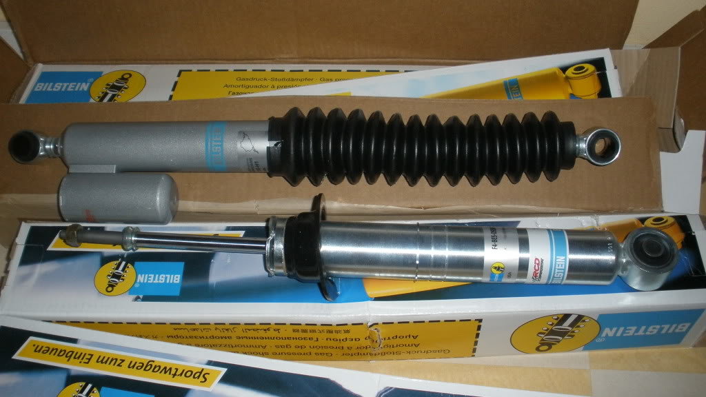

    5100s are adjustable but only by where the bottom plate is. They have a ring and you can move it to 0'' 1.somthing'' and 2.5''
    If you look at the bottom shock toward the left you can see the notches im looking at. Most ppl dont really use the stock coils tho, a lot go with OME 881 or Eibach coils with the billys set to 0.
    i agree with leaf pack idea too, but if you dont want/need it id say a 2'' AAL
    31'' tires fit on a stock yotas easily. Id definatlly go strat for 32x11.5s or even 33s, 32s are a lil easier on gas tho. Just becareful with the rim choice and back spacing, i believe you need 4.5'' of back spacing. 15'' rims are a smart choice IMO, cheaper tires :p If spacers are need to stop rubbin go with spidertraxx or allpros in 1.25'' or 1.5''.
