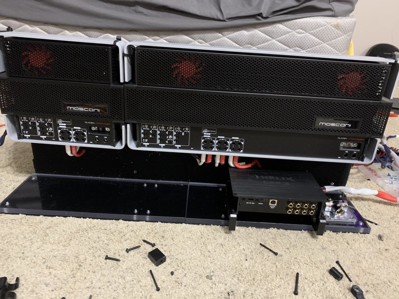

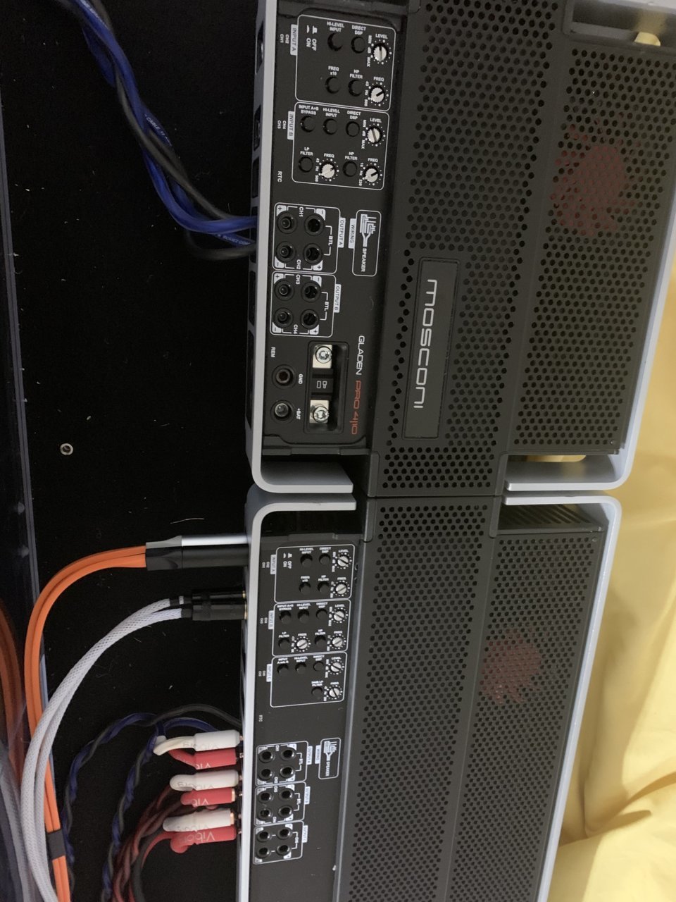

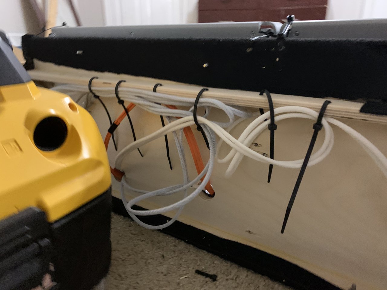

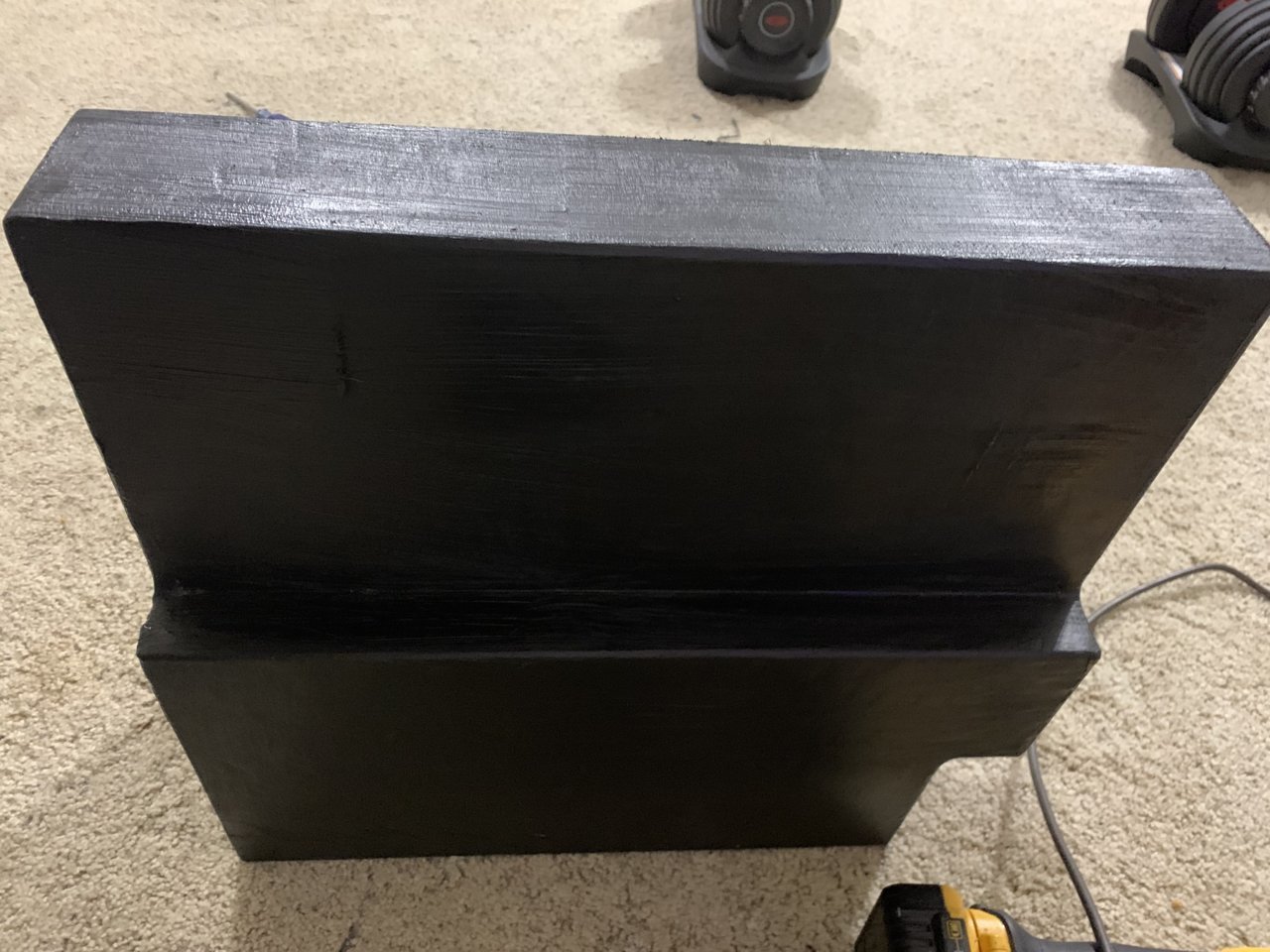

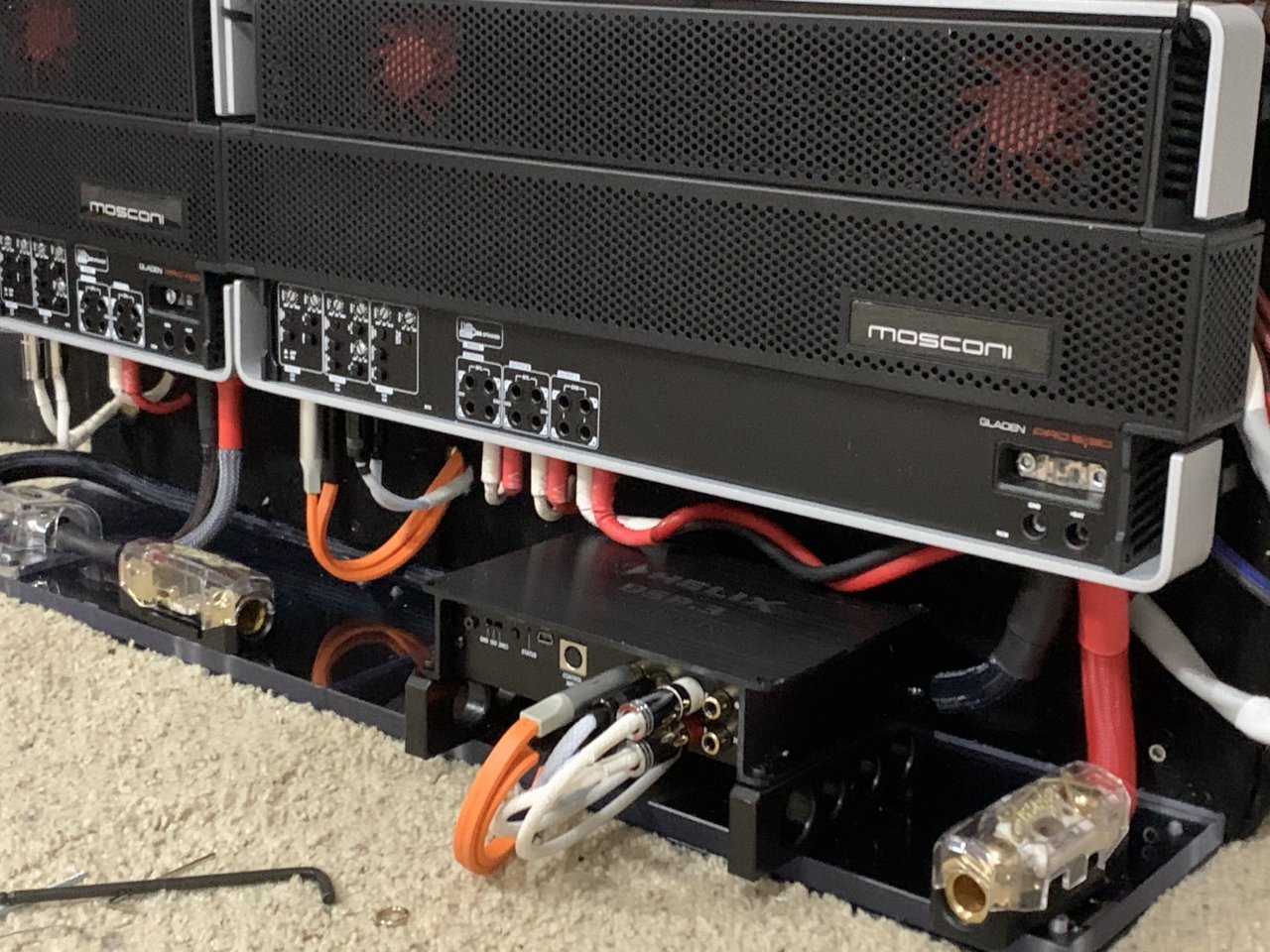

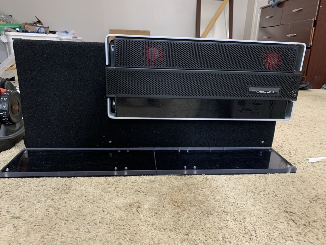

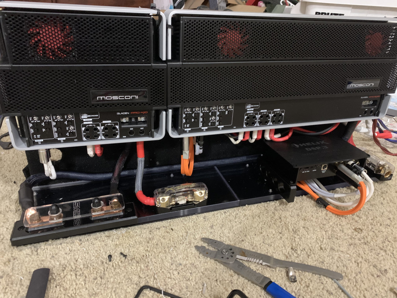

    This barely fit but thank God it did! Finally got the setup I’ve been looking for and just thought I’d share. Sub box and amp rack came from mr marv and he did a wonderful job but with my amps being so big but I had a shelf made for my fuse blocks and the dsp to fit onto behind the backseat. I’ve gotta say that our alternators in the 3rd gen with tow package are very underrated bc I’m running 2 A/B amplifiers with a total of around 2200w and it’s not missing a beat. I did upgrade all wiring and ran multiple grounds throughout the truck and put an Odyssey Extreme group 31 in. Pretty happy with the finished product and it sounds amazing to me. 4B74A88A-433A-4A34-B73C-B8580521F000.jpg828267AF-5D98-4979-8A1C-B7C36F397564.jpg 01B7E78B-C331-4B77-8E8F-B2E5C98C1663.jpg2D062D06-A5F9-4E7F-96EF-D25FAE655DEA.jpg A1805C1F-9DCF-4D0C-9235-4D4E183D6EDB.jpg2E944EB2-2AFF-4C37-8006-AC18BE9AF0CB.jpg 6B00A477-0B4C-42A1-AA50-0EC080AA07D4.jpgE06C5B67-46FE-4677-9BF9-E447A2954019.jpg C0CBC55C-02DF-475B-81F1-0FF27CA681CB.jpg42B08C23-F745-4456-AE41-E4349E37AB85.jpg 42B08C23-F745-4456-AE41-E4349E37AB85.jpg

    looks really good. whats the rest of the setup consist of

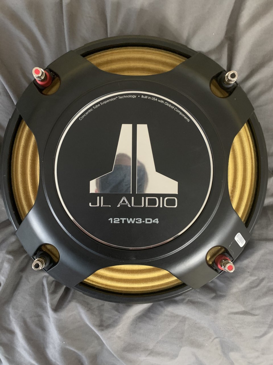

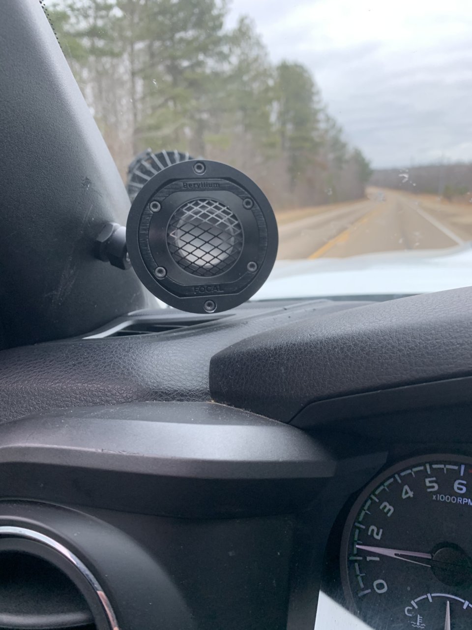

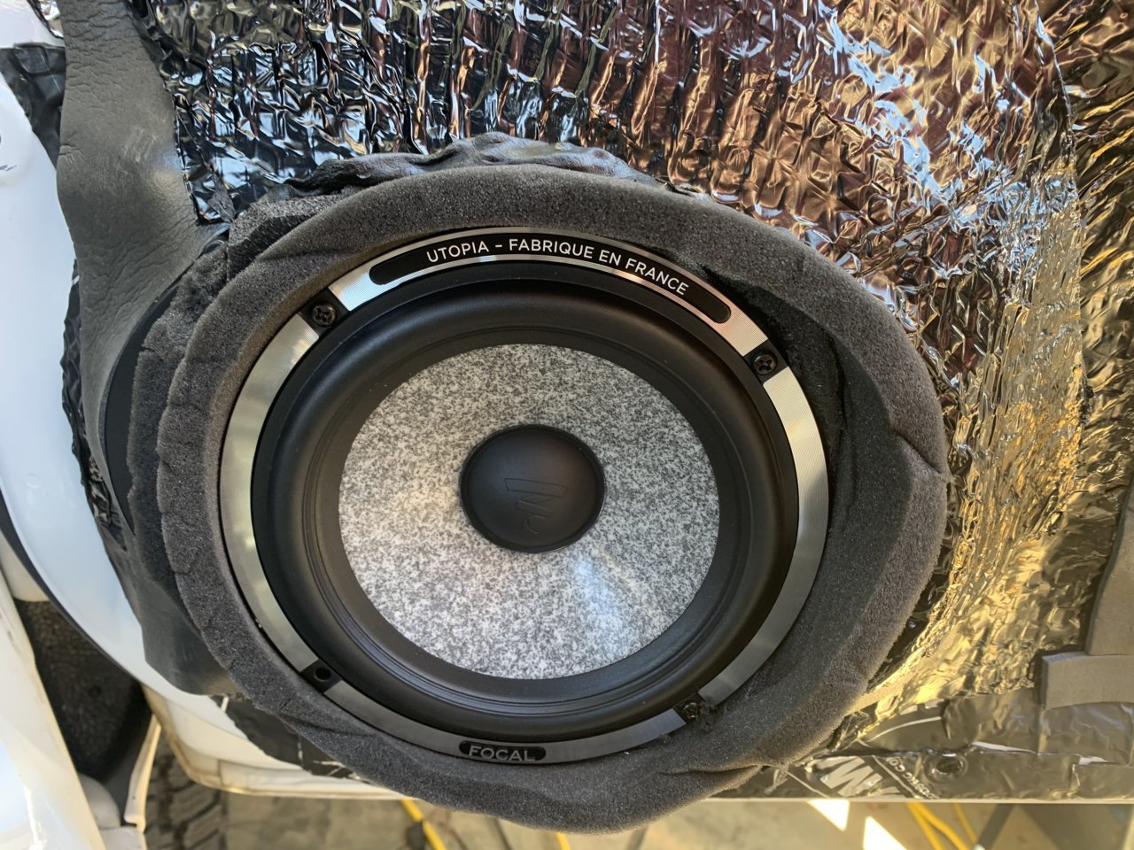

    My speakers consists of Focal W-XP165 Utopia 2 way w 3.5WM Mid range and a JL Audio 12Tw3-4ohm DVC being ran @2ohm in parallel CA78499D-703F-4630-BBDB-893F91B89DB5.jpg 4E3D7B73-6EBD-4364-8E85-021827A14837.jpg DD3549EF-88B3-4078-9DD0-DC779BE321A2.jpg
    I’ll update the pics once I put all the new door mounts and dash corner brackets in but here are some older ones.
    I replaced a JL Audio HD 600/4 so I may be putting it for sale before too long

    Nice choice and setup. Did you sound deaden your whole doors or just around the speaker and behind it?

    I’ve sound deadened the whole truck besides the roof with butyl rubber and closed cell foam then I added some second skin luxury pro ccf/MLV to the floors and fire wall. Had to tear most all the deadener out of the back wall to get the sub box and amp rack to fit nicely and be able to fully lean back and lock backseats

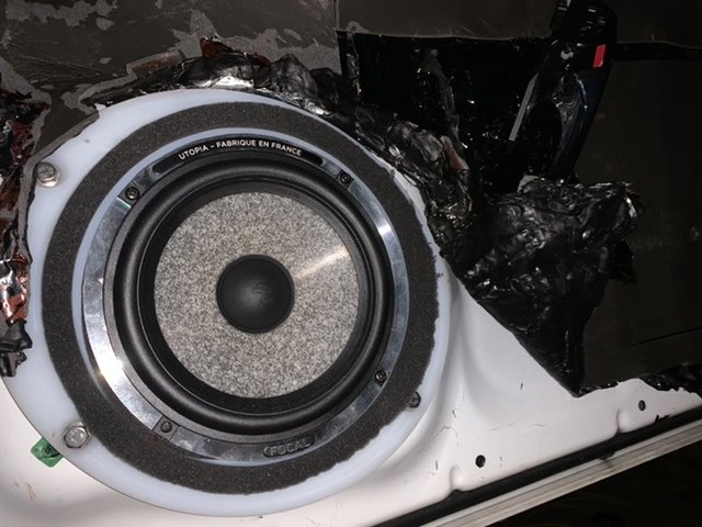

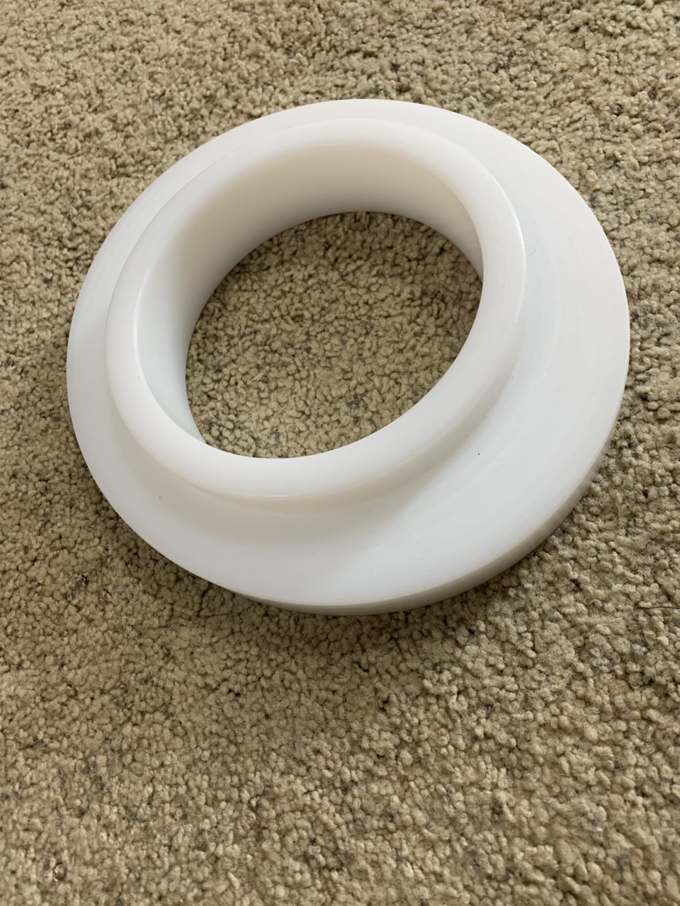

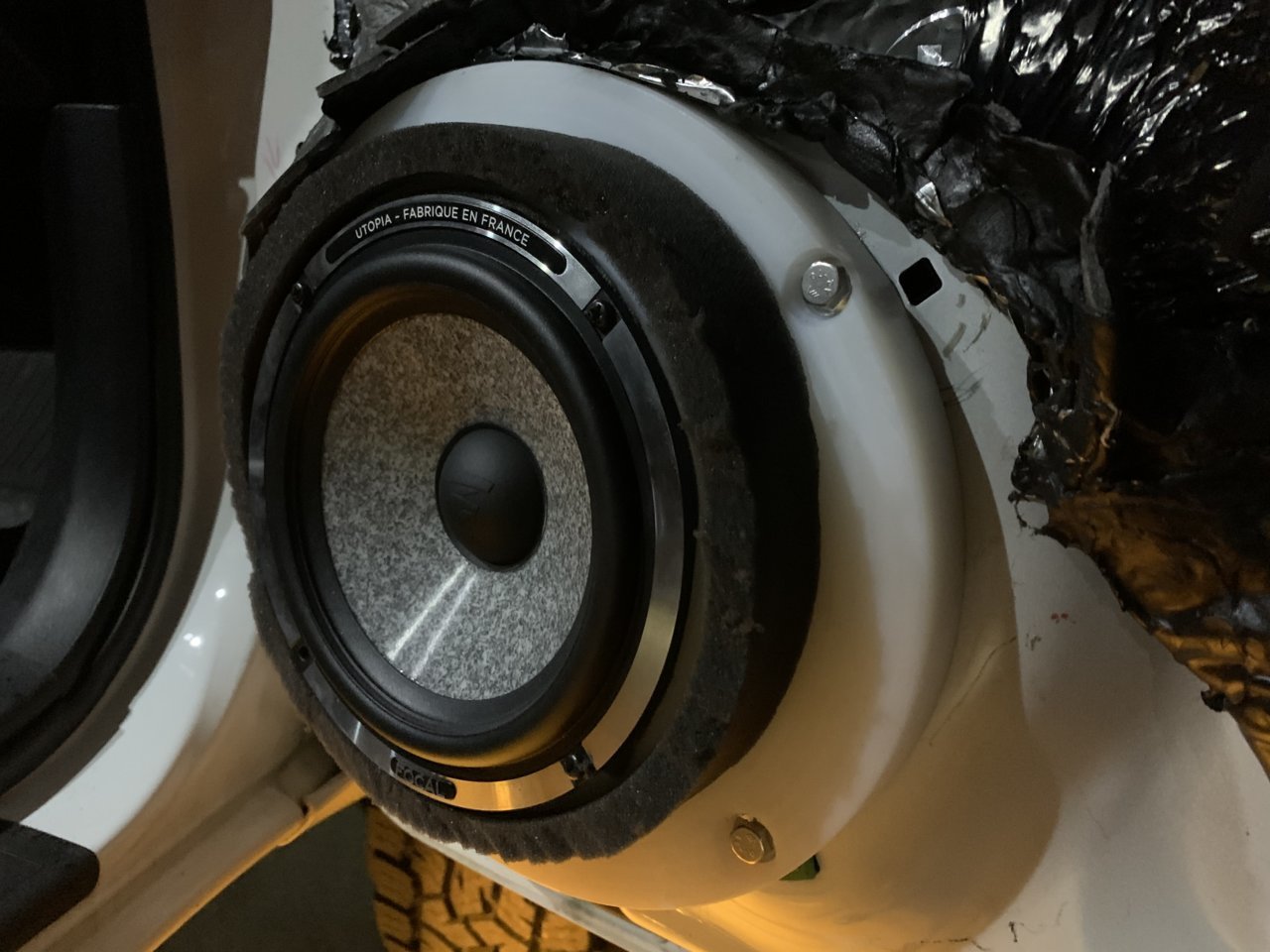

    0D9753A9-6689-40B6-BC1F-9594E9D7A75B.jpg 4BE44F51-75FE-4D86-B9CD-A96BACB9EBEA.jpg 18AD00A8-DCE7-4CD6-9D83-6DC6317D62B3.jpg Got the door brackets installed this afternoon and other than peeling 3 layers of butyl mat off everything went nicely and I’m loving the sound with it being right up next to the speaker grilles of the door. Can actually hear the difference and nothing is getting trapped in the doors. Surprised you cant see any blood in the pics bc i sliced my hands all up rushing to beat the rain

    Looks good. Did you make those new mounts yourself or find them online? They look solid

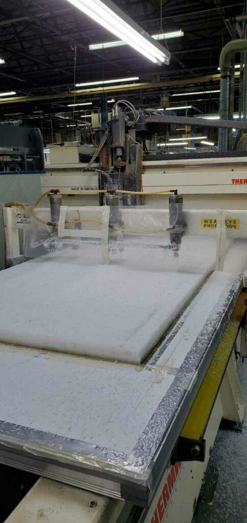

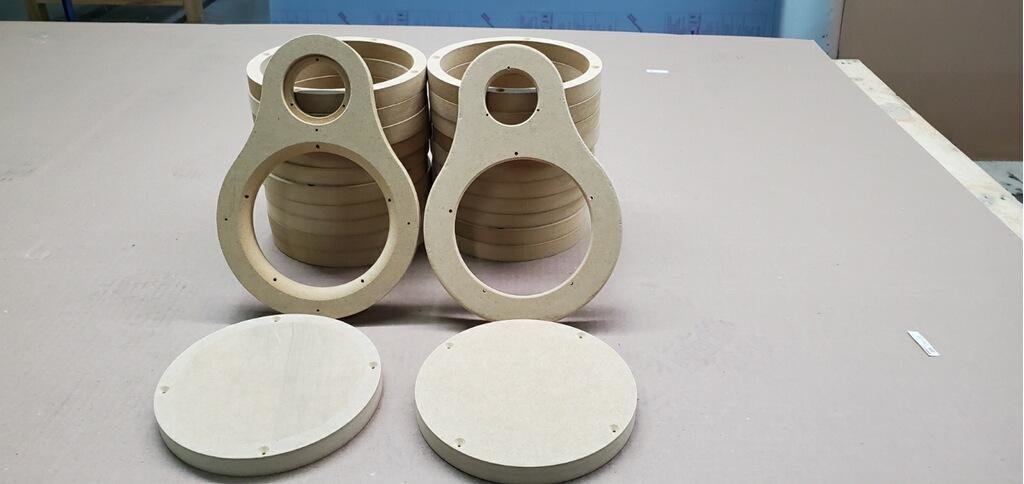

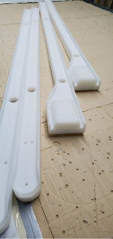

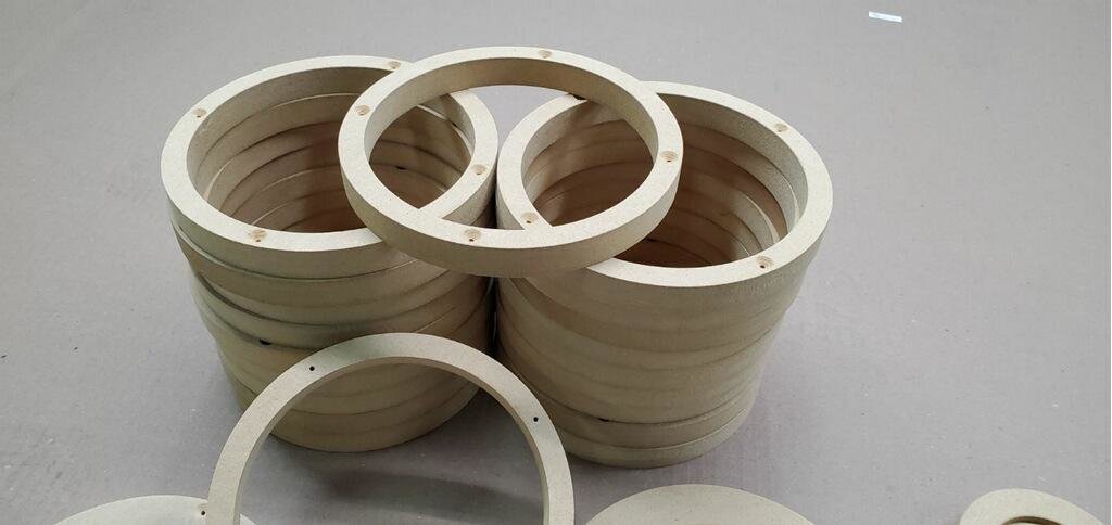

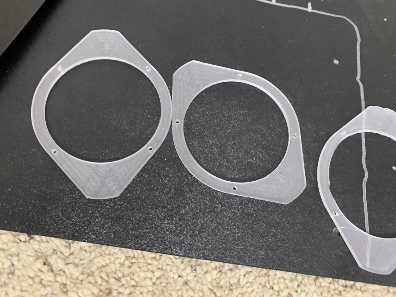

    Here’s a few pics of some stuff he’s making for other members he’s sent to me.. if interested I could probably get you in touchDFB86CBA-4ABD-4B7D-8F26-CB00D963AAFB.jpg DFB86CBA-4ABD-4B7D-8F26-CB00D963AAFB.jpg I met a guy through car audio forum who has all the equipment to do these on the side at his job. He was awesome to work with and made them UHMW. They are very solid. Best I’ve ever had personally
    92104A1A-E3E6-4CD0-A43C-AF2A3C516BE5.jpg 8C58418C-F173-4A4F-9FE2-11A56B438062.jpg 594C6141-FAA7-4781-94D7-B9E9E332EC0A.jpg 91D5A5AE-7A3F-40E9-8DBF-A8BF6E57B4A4.jpg

    He’s also the one that built the shelf piece for my box that marv made. I think it’s made of Lexan or UHMW if I’m not mistaken

    Looks great. How much were the door mounts if you don’t mind me asking?

    $70 plus shipping. Edited I told you wrong the $90 included my risers

    Edited his price. I couldn’t remember exactly but it was $150 for everything and I thought the shelf and door brackets alone were worth that after seeing the quality. Asked him and he said brackets like mine would be $70 plus shipping
