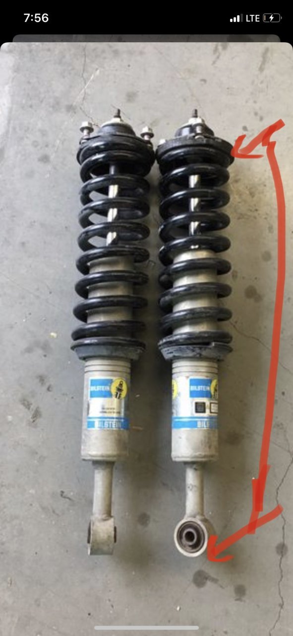

    So I just measured my truck height and looked at the clip setting on my truck oem strut. The drivers side oem strut is set to the second clip setting while the passenger is it to the first clip setting of the oem strut. Also I measured my struts the ones I just picked up (bilsteins 6112) and they’re set on the 4th clip setting making it a 1” inch to a 1 1/4” taller. Also 650# oem springs are 10 1/4” and my 6112 springs are 11 1/2” but remember my oem spring has a 1” toyotec bottom spacer and my 6112 springs are set at the 4th clip setting. My fenders are drivers side is taller by 1/4”. Just some info I found out by measuring stuff out today. I measured from bottom of strut to top of springs as picture indicates. Sucks I wanted to use my oem springs as they’re 650# vs 600# but they’re shorter

    I don't think stock springs will fit around the 6112 shock body will they? 6112s are a much larger diameter than stock/5100/etc.

    They’re actually the same diameter just the oem spring is shorter in height

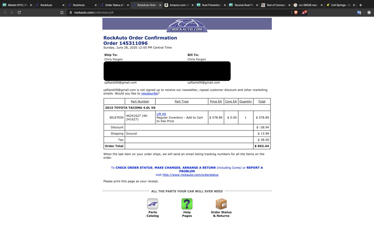

    Just an FYI for anyone reading this thread (especially @Dansly56 ) I just ordered a set of 6112's from RockAuto. $603.xx shipped! Look for the RockAuto discount code in the deals and vendors threads for 5% (covers shipping costs)

    I ended up buying used 6112 that had 3000 miles on them and still under warranty for $240. That’s a good deal for new ones though
