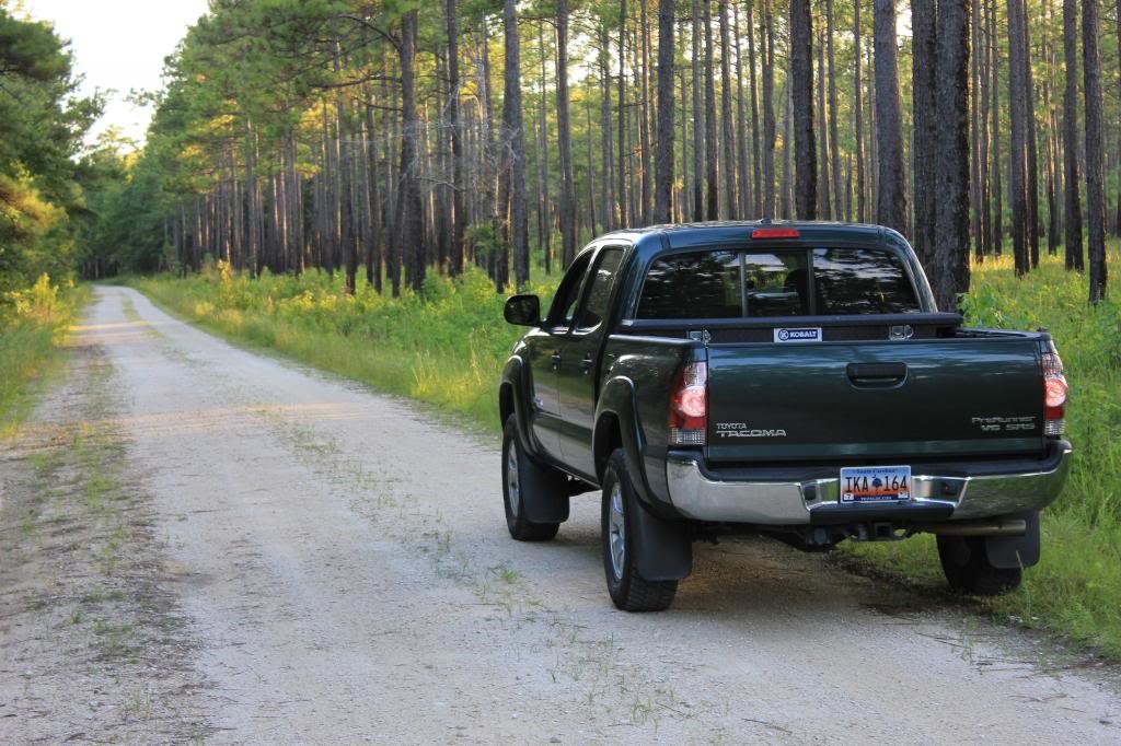

    So I've been running my billys since Dec. (1.75) and have to say I'm pretty impressed so far. Only thing is...now I want to go bigger. Ive been doing research on spindles and it looks like I'll be going Maxtrac 4". Since my rear leafs are starting to sag I'm going to skip the blocks and aal's and just do the AP expo pack with new billys for 3-4" lift. my current confusion is with the spacers/backspacing needed to clear the new spindles. i know i would need spidertrax at 1.25," but I've also read that my stock 16" rim will not work with the spindles (even with the spacers). is this true? also I've read that the balancing weights can sometimes be in the way as well on the 16" rim. Im pretty fond of the stock wheels (not a chrome or black rim kind of guy), so I would like to keep them if possible. Finally, I installed my billys on my own (first mechanic experience) and it wasn't bad at all, just a learning experience and probably slower than most on here. With that said...Is a spindle change something I could handle? I'm not worried about the leaf pack, I've heard they are pretty easy...the brakes are a little worrisome as well...not sure about draining and what not. Thanks for any help.
    Here is a pic of how she looks now
