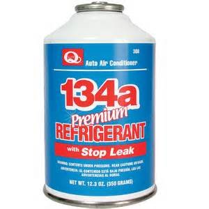

    Please do not use the stuff with stop leak. It screws up the professionals air conditioning tools. If they find you used it, you could be buying them New tools.

    Yep, I never use stop leak, even on coolant leaks. No bandaid fixes for me. I do use the pag oil with dye in it though. Makes it easy to find leaks.
