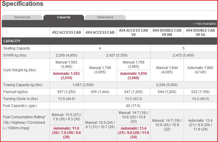

    In Canada, the max towing capicity for all V6 is 5000lbs and 6500lbs if you have the TRD version. The main difference between them is the addition of the transmission cooler. I'm not sure how much the towing capicity would increase with the addition of a cooler on an SR5.

    Why is the capacity higher in Canada for a V6 without tranny cooler than it is here? It is the same truck/engine?? :confused:
    Edit: I didn't notice the OP is in Canada...here is the Canada specs from Toyota.
