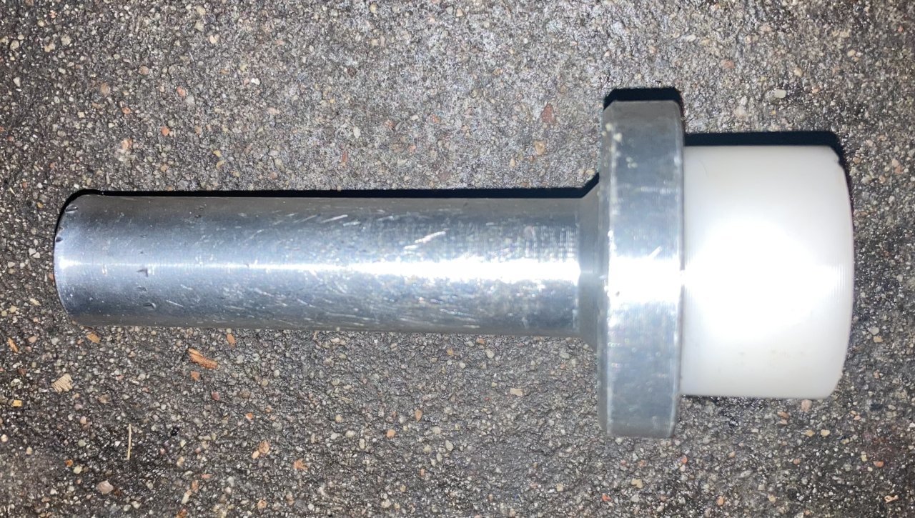

    Both. I just took it out. I wonder if it’s only good for the left seal. Seems a little small for the right. Goes right through the center hole of the seal.

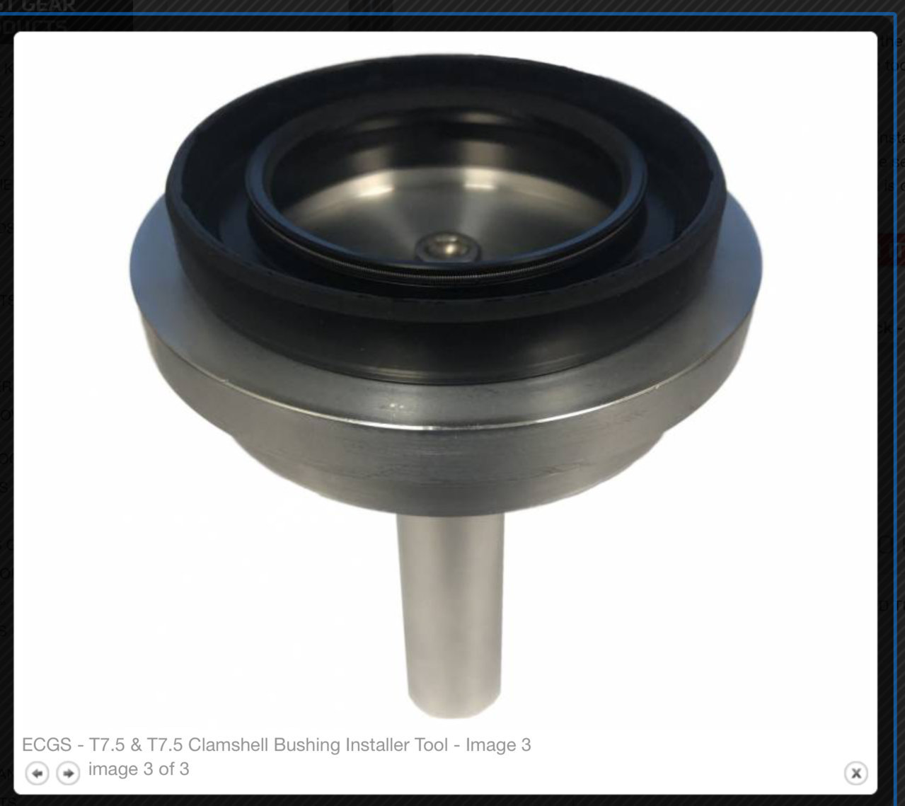

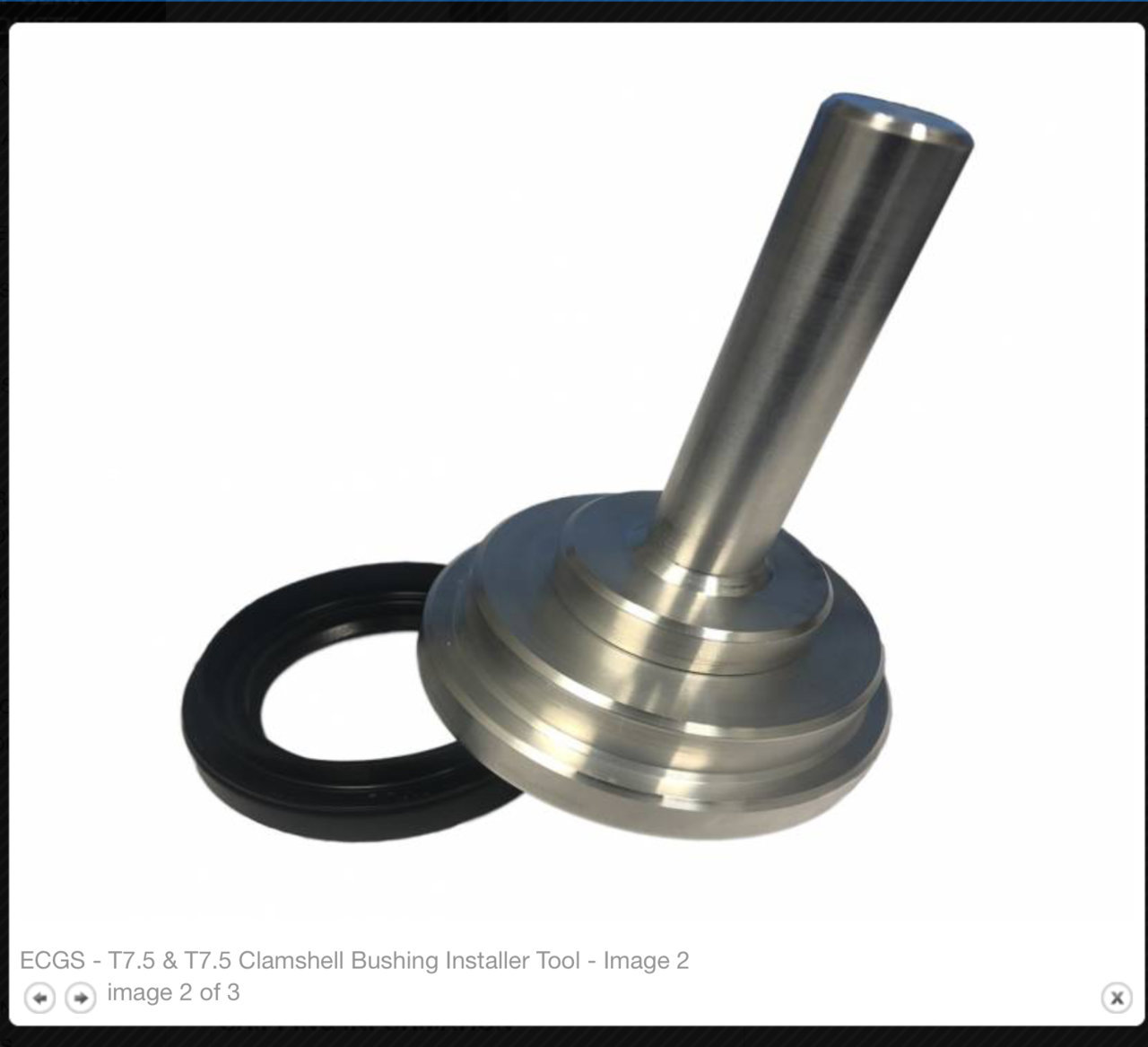

    But it's worth investing in that Wit's End seal driver tool as it was what, under $100 or so total?

    So the seal’s in. It actually seemed easier this time?
    Wondering if where I went wrong was measuring right as I was driving it in. Not sure how much the neoprene? depresses, but I did notice if I checked the depth, walked away & then checked again it was slightly different.
    Also, some seemingly random spot would be 4.5 whilst an inch to the left or right was more.
    Both of those are good reasons to use a driver like the wits end one. Drives it in evenly & of course, to the correct depth.
    Ha-ha! So ALL those observations & I don’t know if it’s going to leak. I got all pissy trying to seat the axle (splines to splines) so I figured it’d be smarter to finish tomorrow. Mistakes start being made….

    This is the one I have. I bought the uninstaller. Another TW member bought the installer & donated it to the loaner kit.
