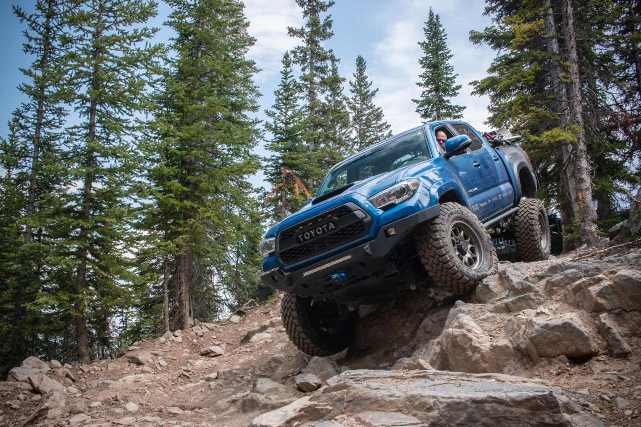

    I probably should have started this thread 2 years ago when I started the build, but I didn't so here we are :rofl:
    Full disclosure, I'm co-owner of Victory 4x4; we manufacture bumpers, sliders, armor, and accessories for Yotas.
    Anyway photos first, then current specs :thumbsup:

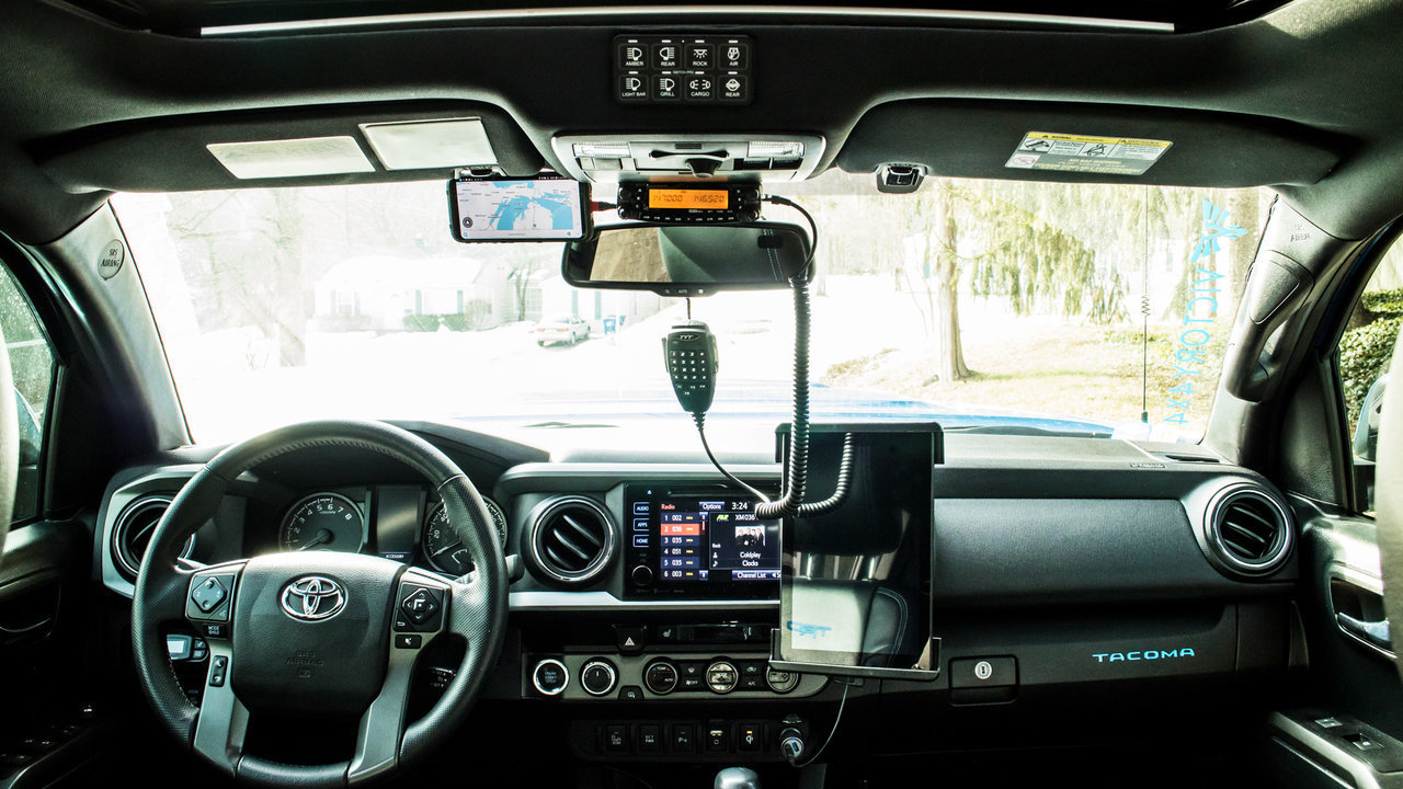

    Sweet build! Are your foot well light hooked up to the dome and map lights or are they just constant on? Either way how did you do it

    They are wired into the dash illumination.

    Interested in how you mounted your ham above the rear view mirror. Looks like a great spot!

    Just used some very small metric countersunk bolts, nuts, and washers through the remote faceplate mount of my radio, the headliner, and into the plastic bracket that surrounds the console up there.

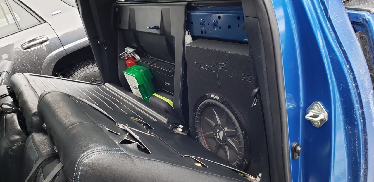

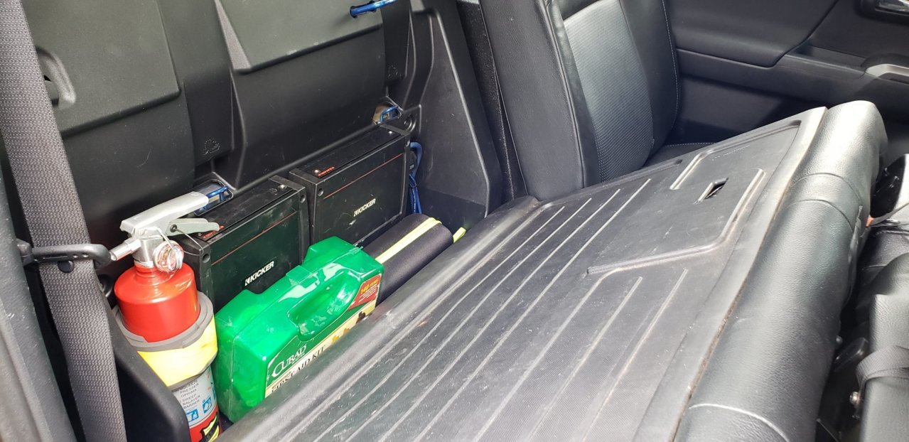

    Had some questions elsewhere about the audio setup, adding it here as well.
    My setup:
    Let me know if you have any questions about wiring or setup. Sorry, the truck is a dirty mess. :D

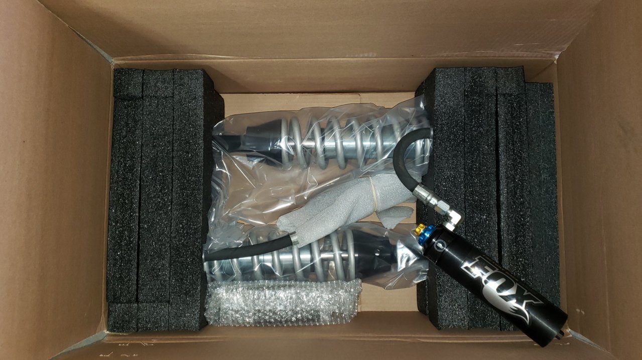

    This kit is a couple months out from BDS I'm told. FOX coilovers, upper arms, add-a-leafs, and rear resi shocks. Not 100% sure, but I assume they'll say it fits 32-33" tires.

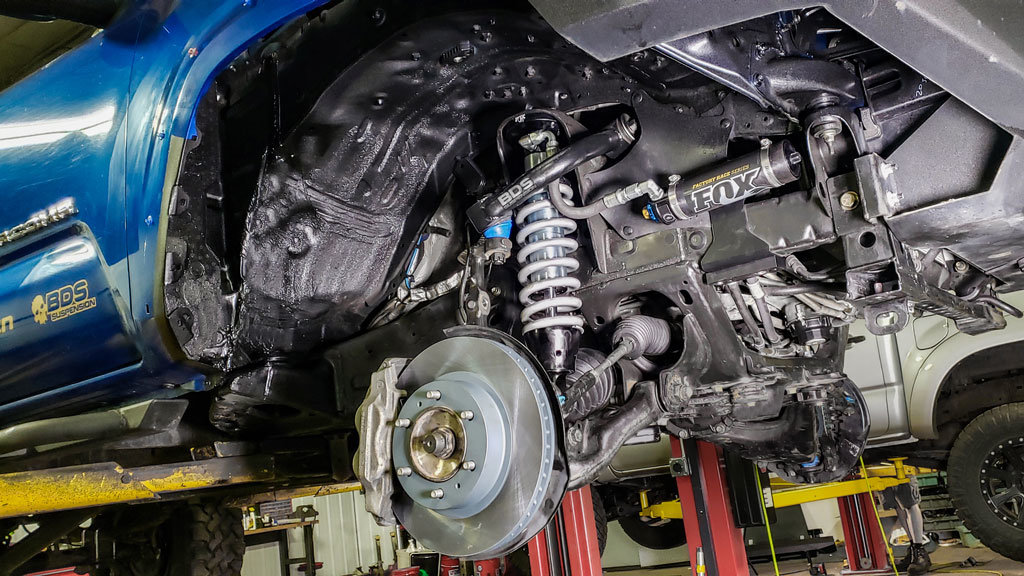

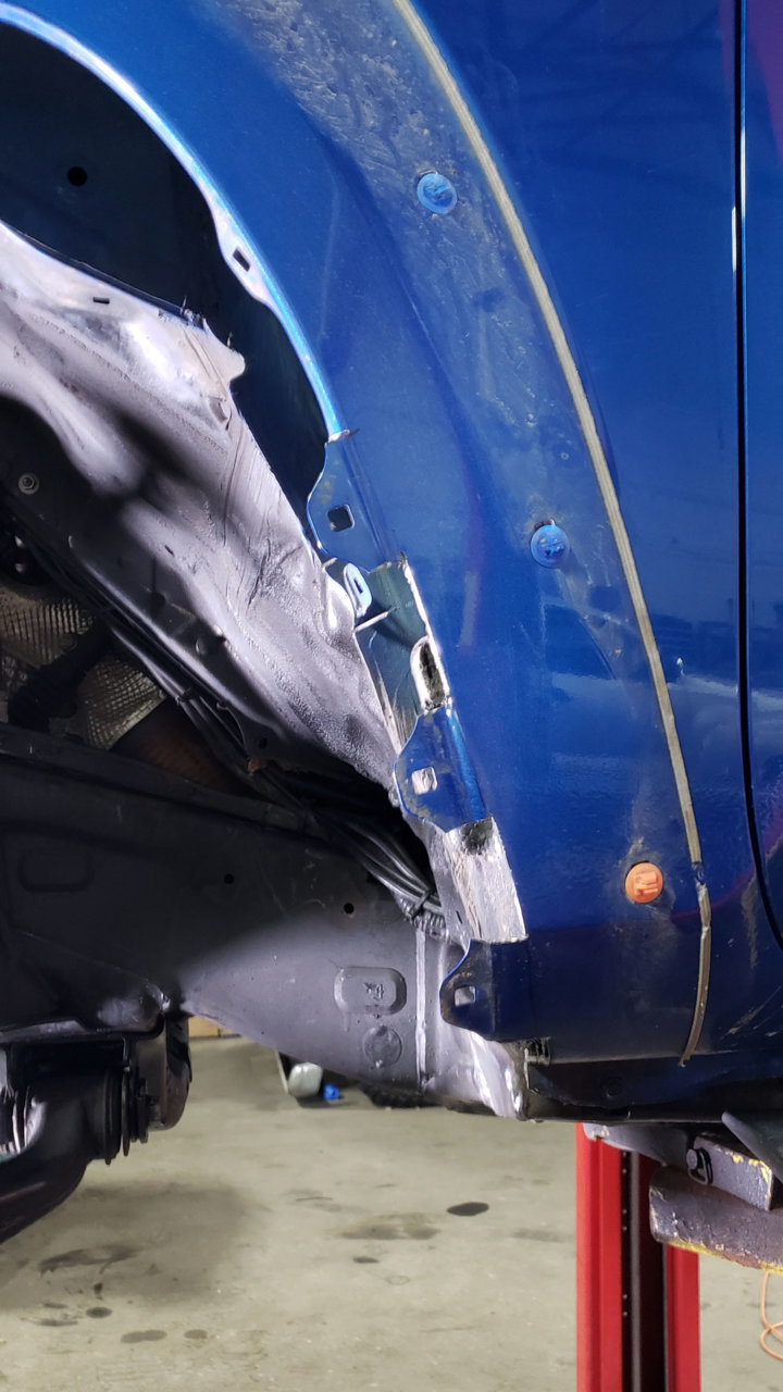

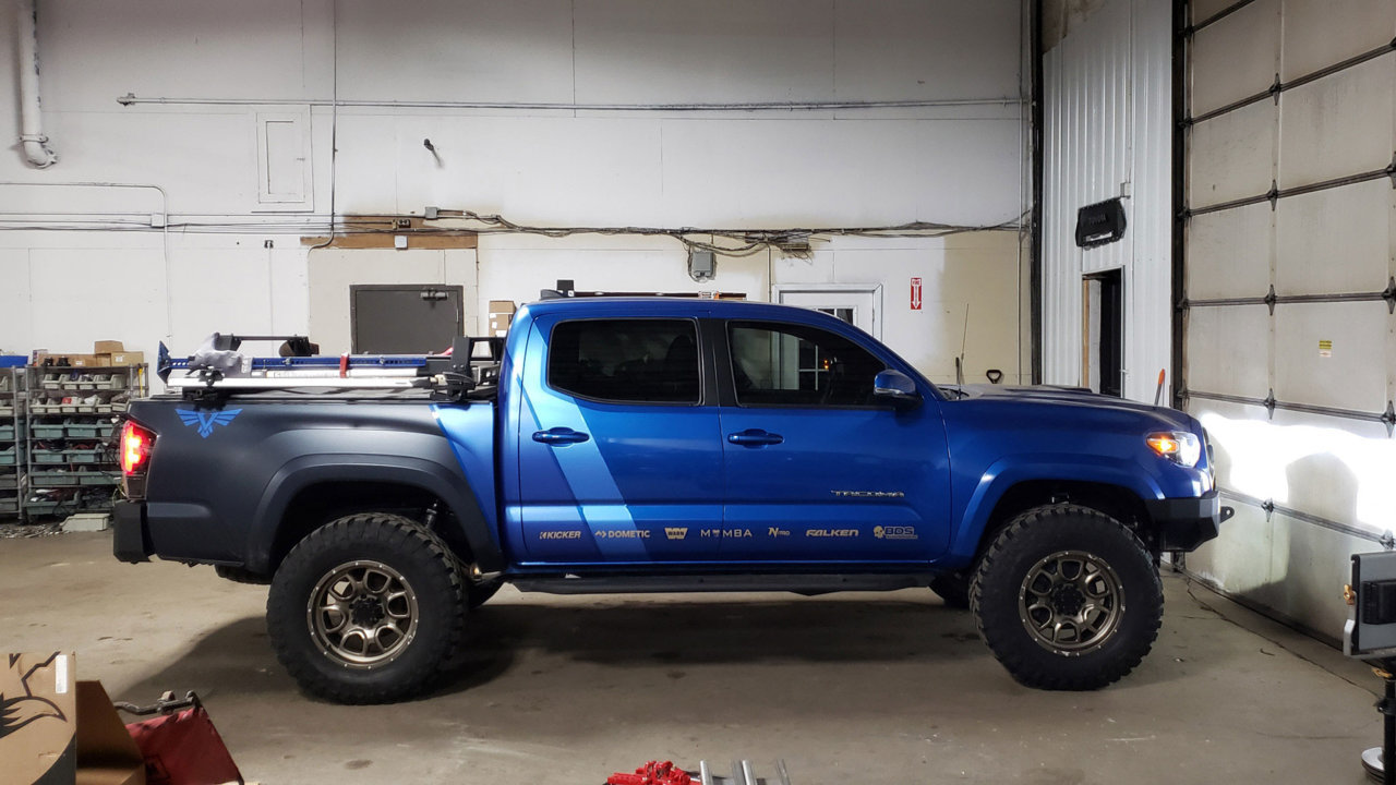

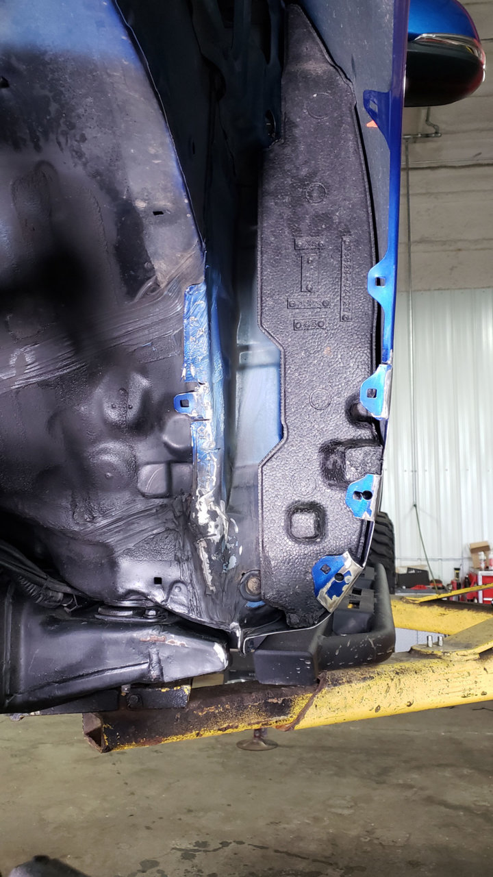

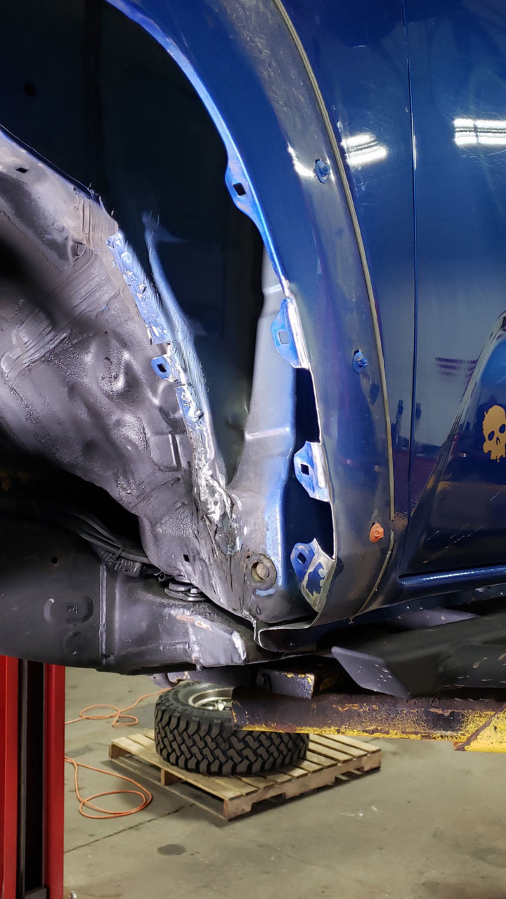

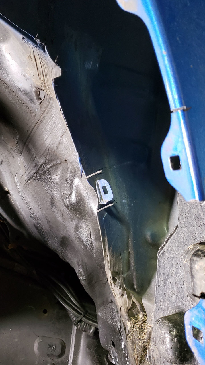

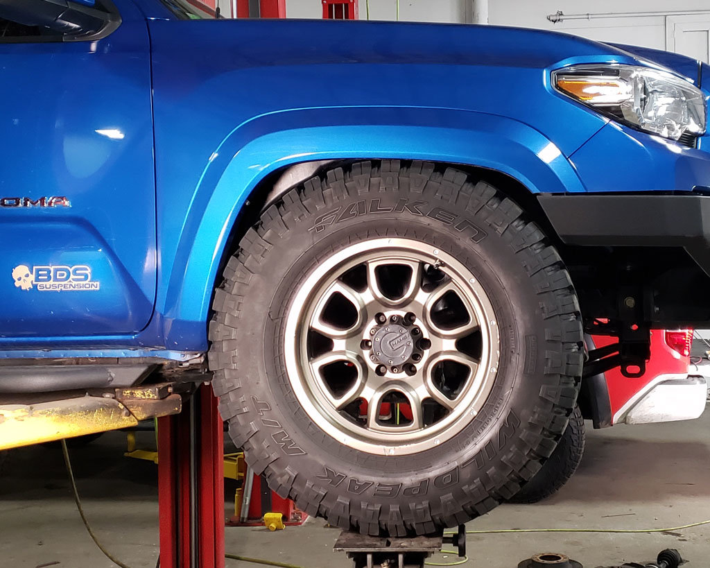

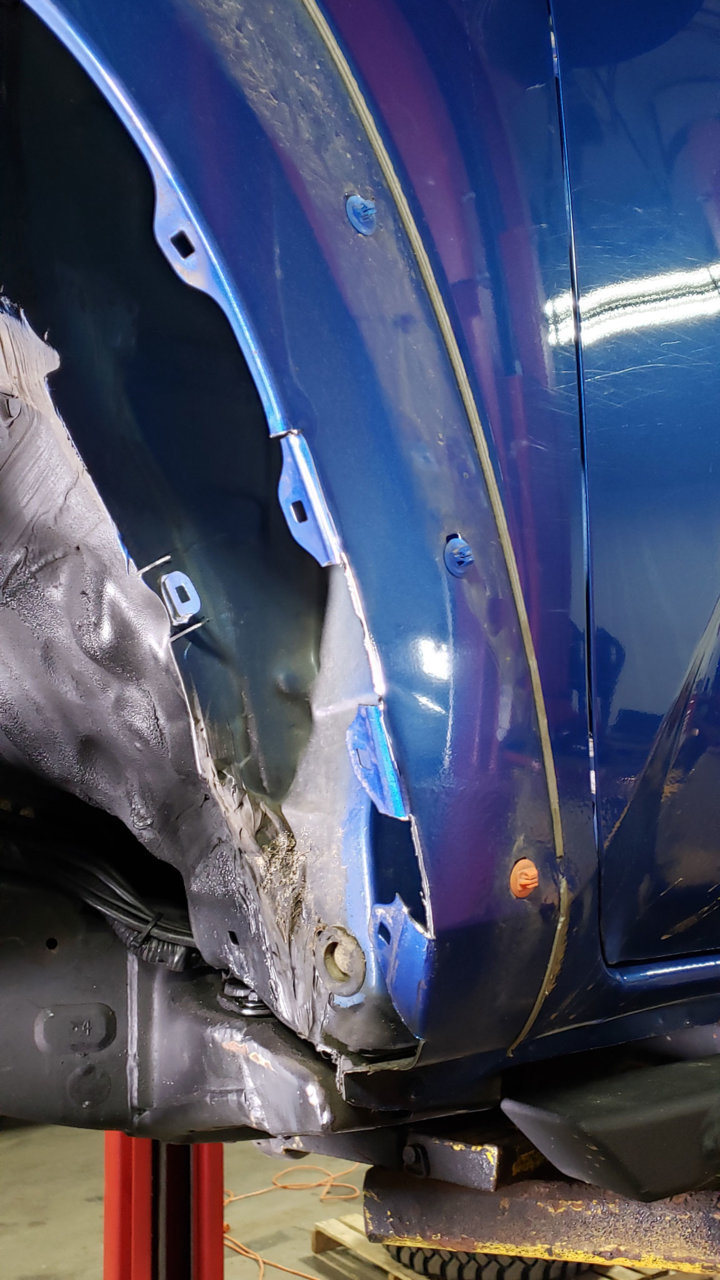

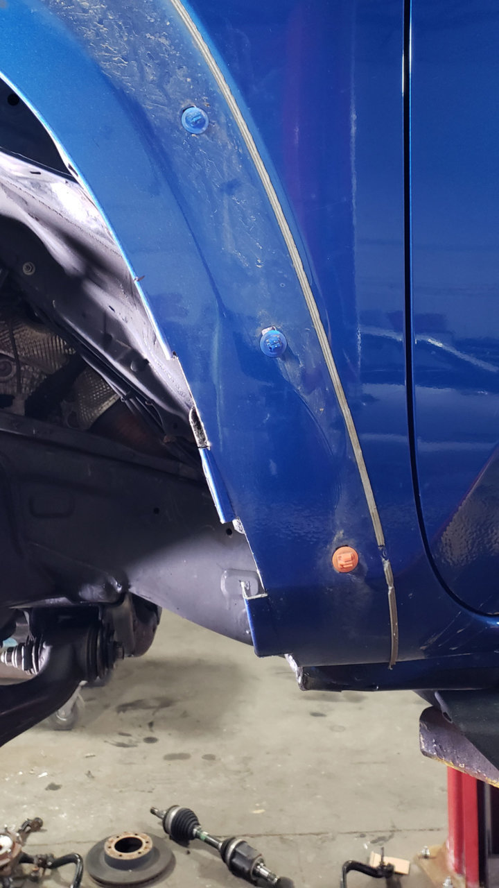

    After a couple of years and 40k miles with the BDS 6" drop bracket kit, I was looking to change the truck up a little. I also really wanted to run our full skid group. The timing was great because BDS is getting ready to release a 3" mid travel kit available with 2.5" Fox front coilovers and 2.0 rears.
    Flexing 35's on a 2-2.5" lift meant I had to do some body trimming that I really wasn't comfortable with when the truck was new, but now at 50K, whatever :D
    So first I had to weld the portion of the cross member back in that I removed for the drop bracket kit. Which I forgot to take a photo of in process, but here it is now.
    Then mocked up the OEM spindles with the BDS uppers and factory lowers to check tire clearance at full compression at 3-4 degrees of caster. Gonna need more in the rear fo sho.

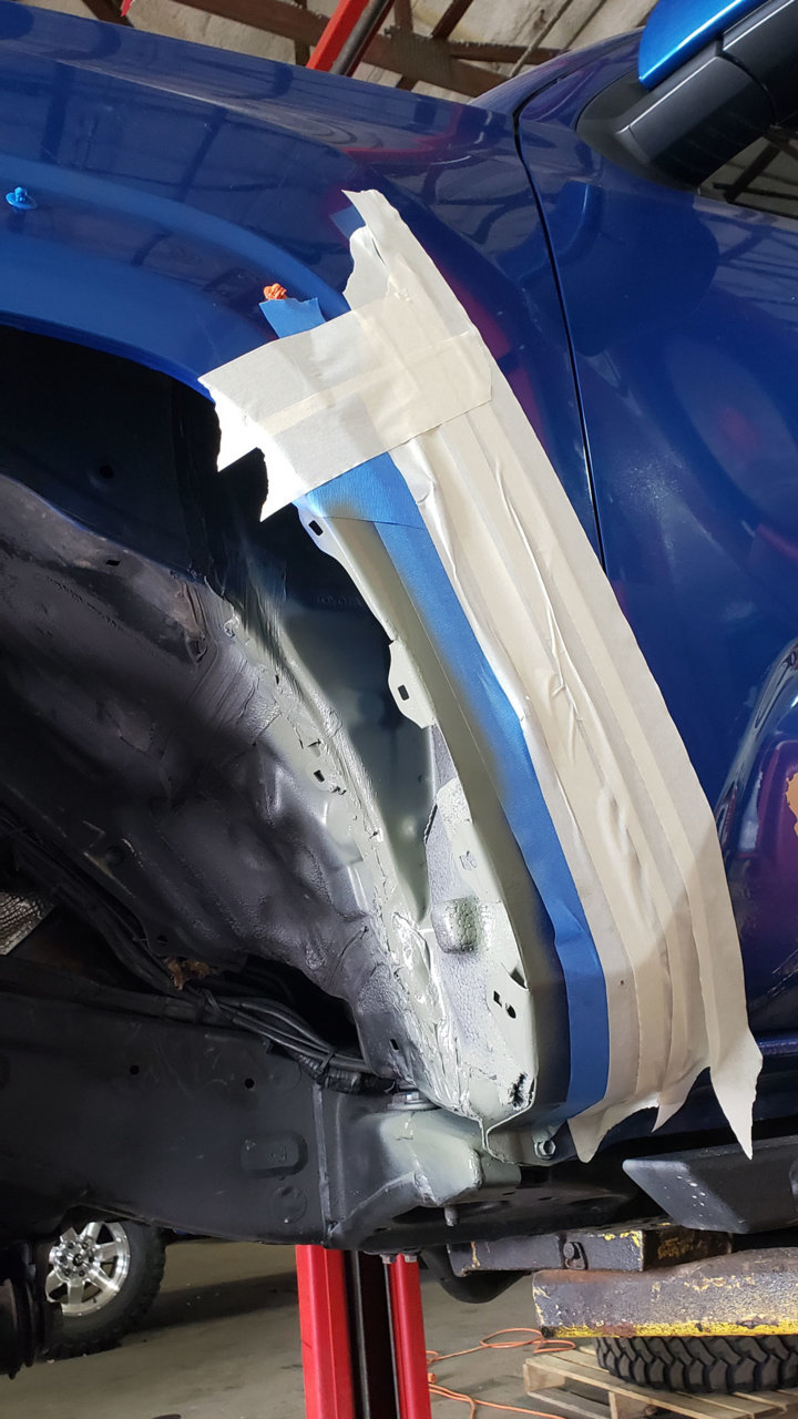

    Time for chop chop. My cab mount chop from a couple of years ago is still good, but I was into these fenders even crawling with the 6" kit, so something had to be done.
    I still wanted to mount the fender to make it look factory, so I cut like this.
    Then I flattened the mounts parallel with the fender.
    Then bent them again at my cut line.
    Same deal with the inner pinch weld, but I used the cuts to make it easier to hammer over. Also cleaned everything up with sanding disc.
    Note the holes I drilled in the lower two fender flare mounts to accept some 1/4" nutserts to mount the fenders.
    Painted with metal etch primer.
    Then added a shit ton of seam seal over the pinch weld and finally some spray on bed liner over the whole wheel well. Which is really the only thing that spray on bed liner out of an aerosol can is good for :rofl:Also bolted on the rest of the new suspension.
    Bolted the fender back on and it looks factory. There is about .5" more to gain here if I can figure out a way to bend the flare back more without distorting the heck out of it... Heat gun maybe? I may also try to get an aftermarket flare to see if that helps. What I gained is barely enough at 3degrees of caster. But more (even with the cab mount chop) would be good.
    In the rear, I was running a 3" block in combination with an add-a-leaf. So I just pulled the 3" block. It's sitting pretty level, so I may decide to add a 1" block back once I get it loaded down again with gear and a tent.
    Loving the DSC version of the Foxs (foxes?) so far. Haven't pulled the camper yet, but did do a little towing this weekend of some new additions to the garage ;)
    Skids next! Then we are going to Utah to play in a couple weeks.
