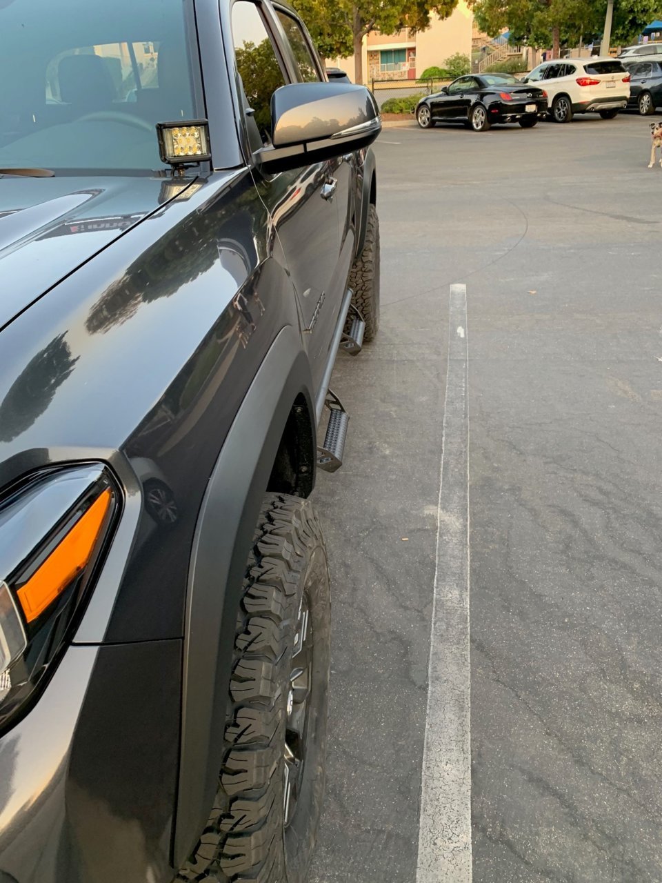

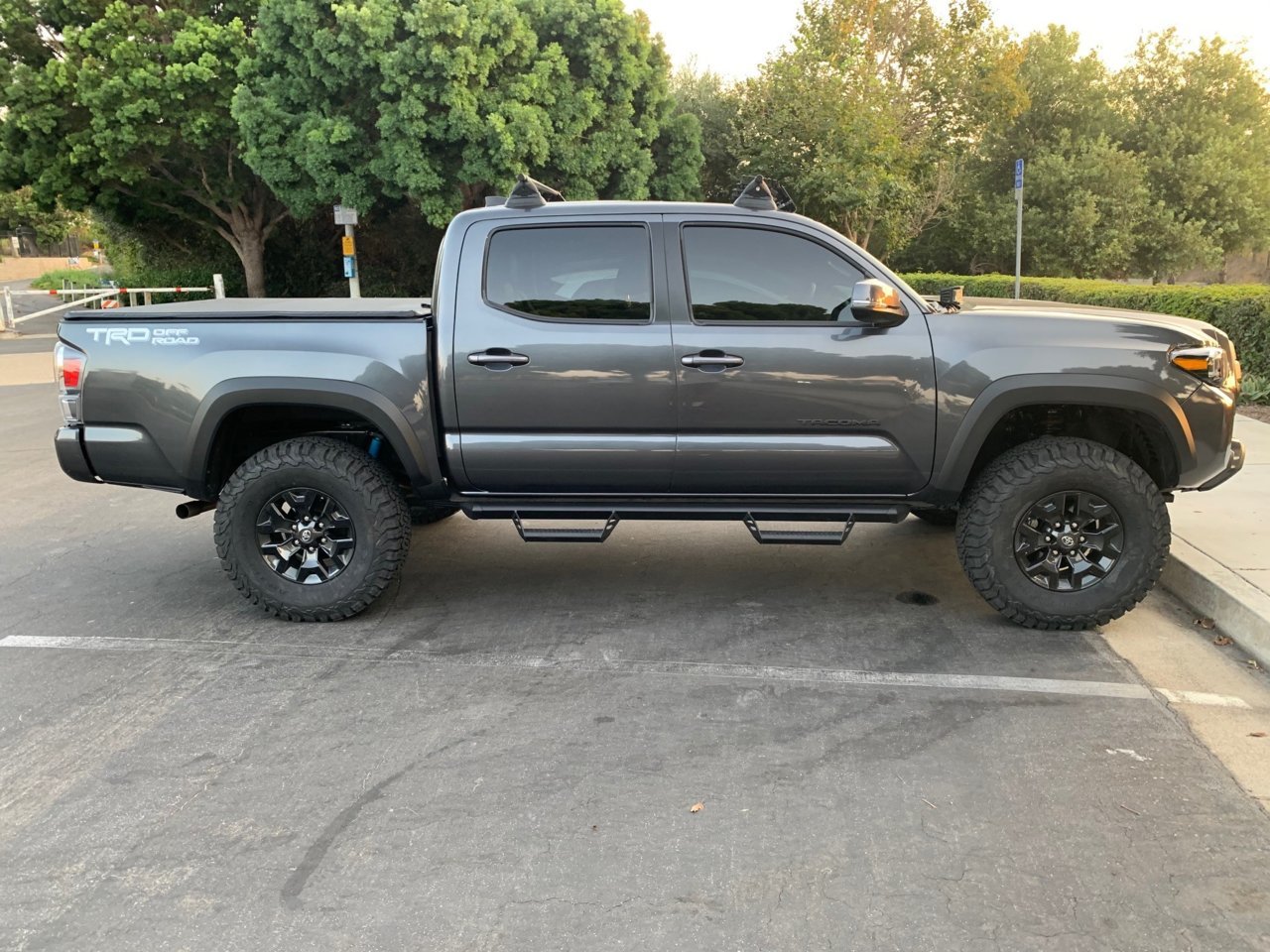

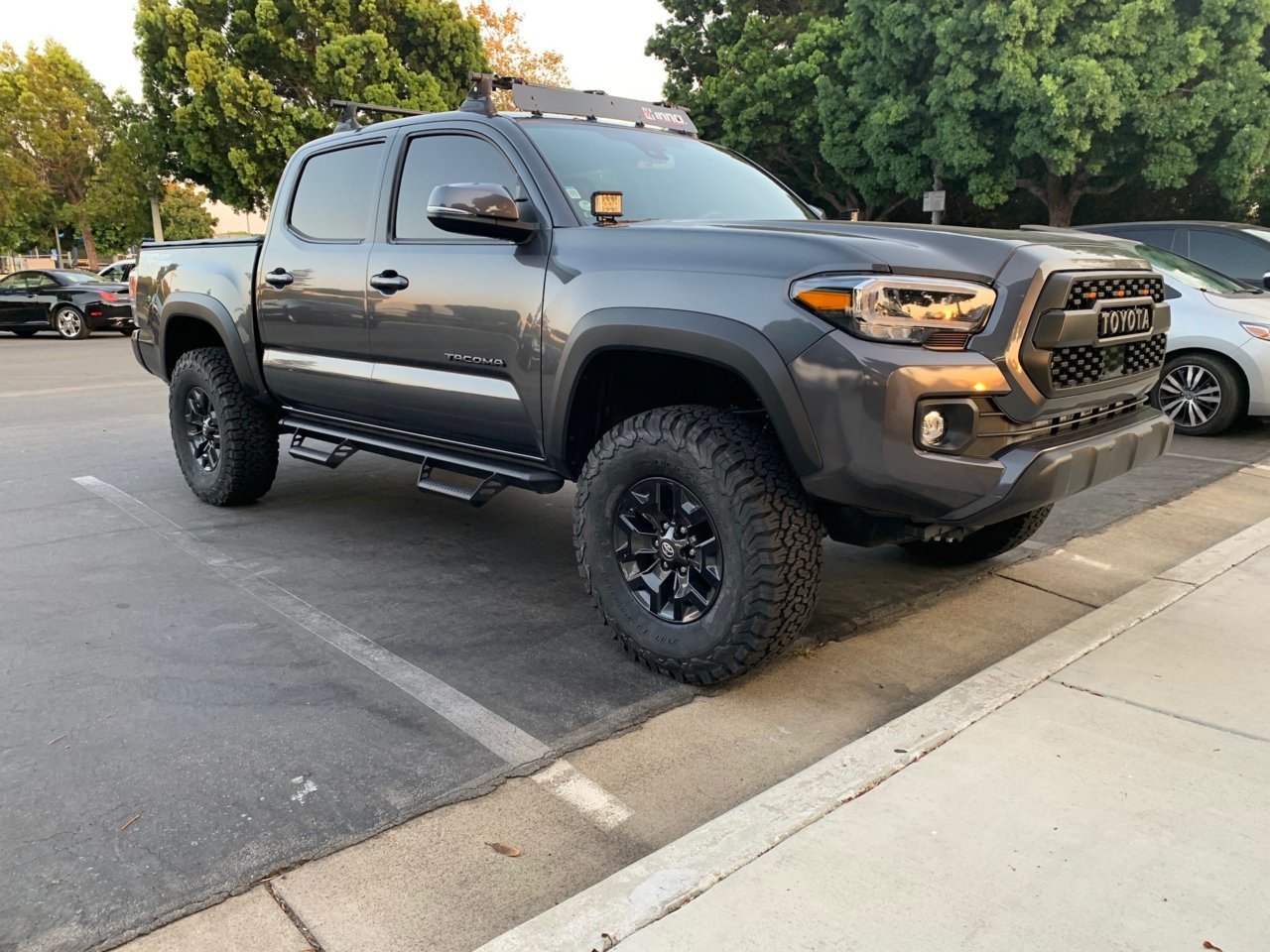

    They're pretty common around here. They are pretty beefy and all put in with loctite. My first time with them so I have very little experience with them, but they allow me to run stock wheels with these tires, pretty much the only option.

    Looks sick bro!! No rub on 2”?

    No rub so far! definitely not on the control arms, I didn't see and on the front fender or body mount, but again....haven't been off road yet but for street driving no issues whatsoever! I'm stoked! AND the truck drives basically the same, I think since these tires are only 5lbs heavier than the E load 265s I had the main hit in performance I took was jumping to the 265/75/16s from stock.
