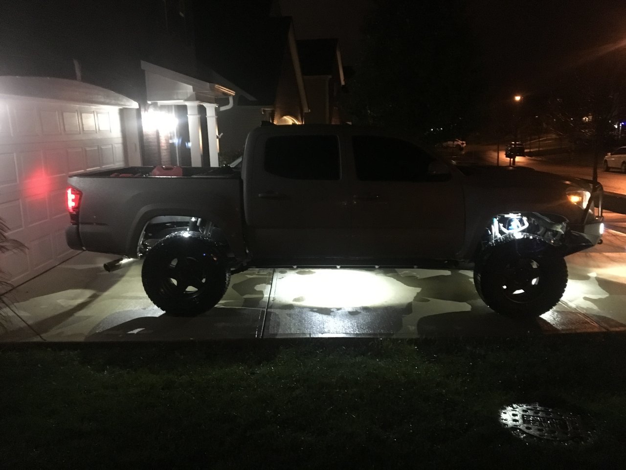

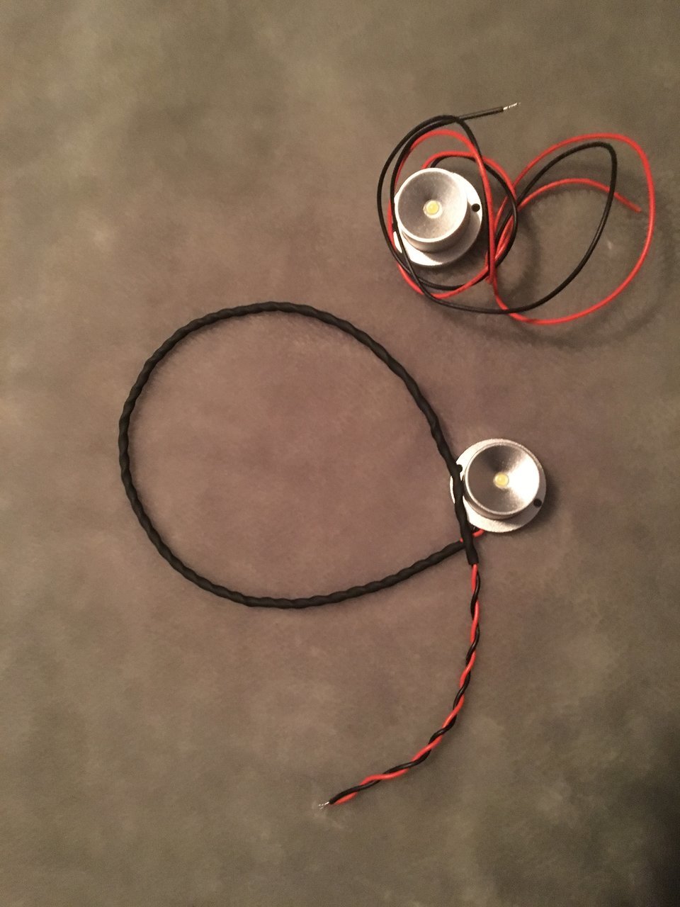

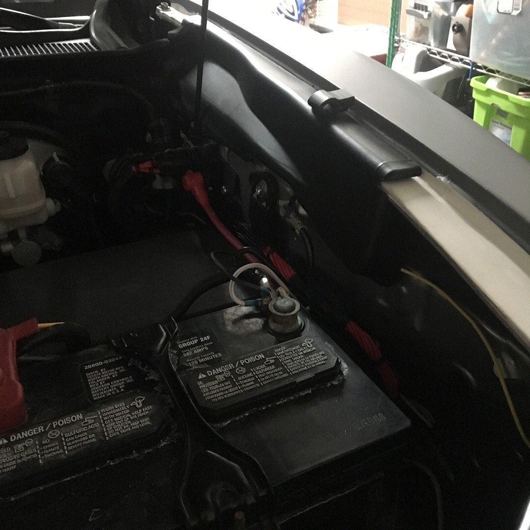

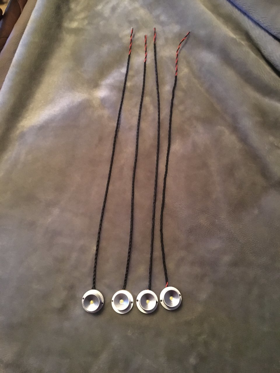

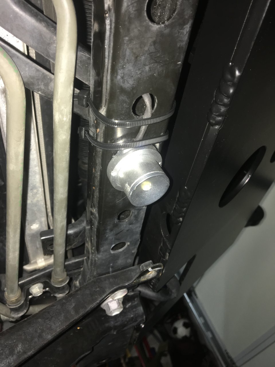

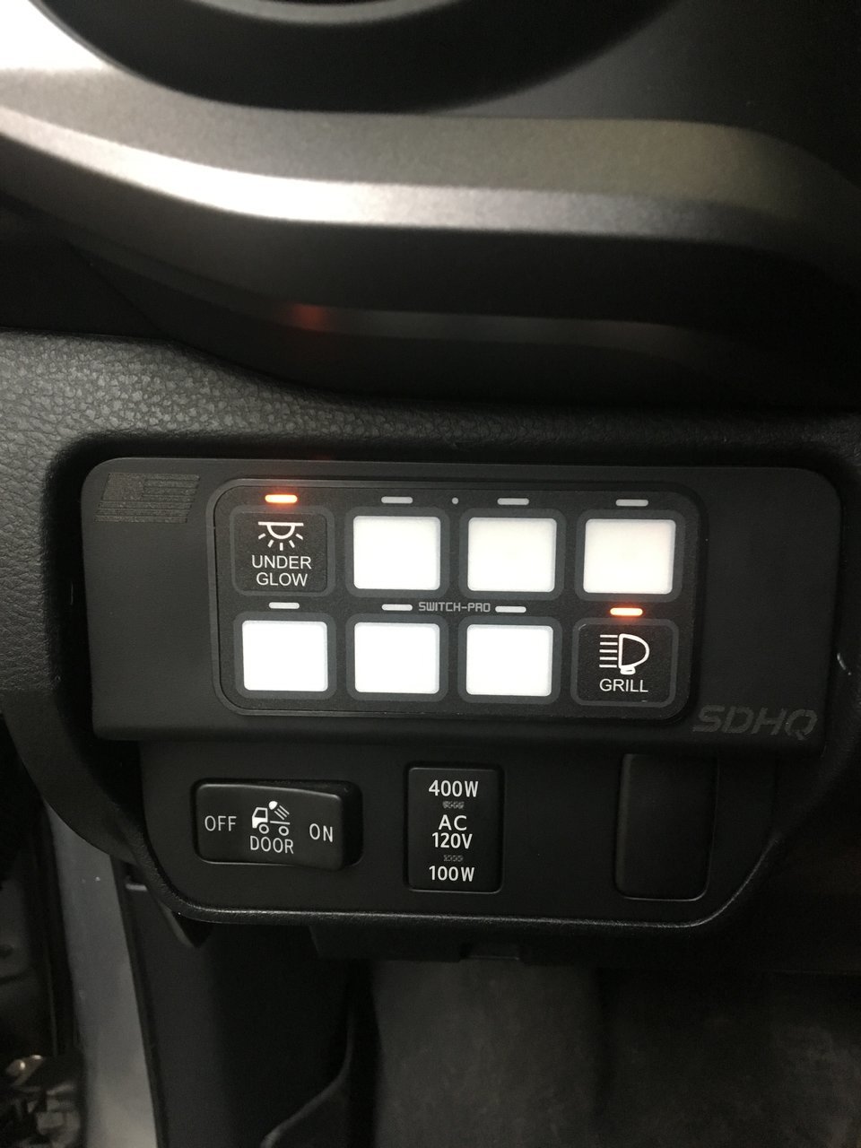

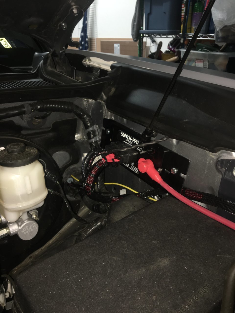

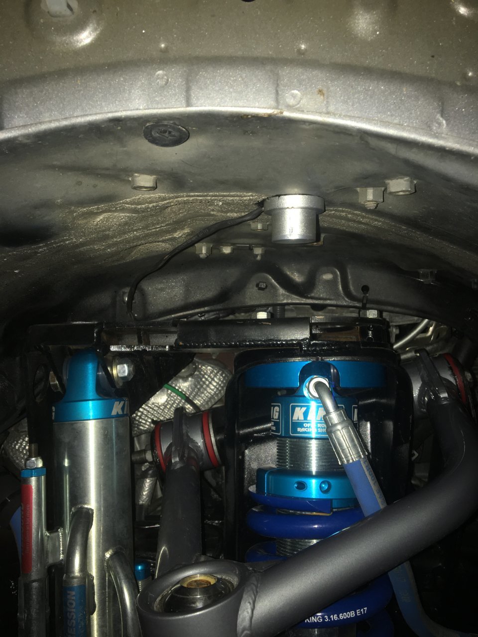

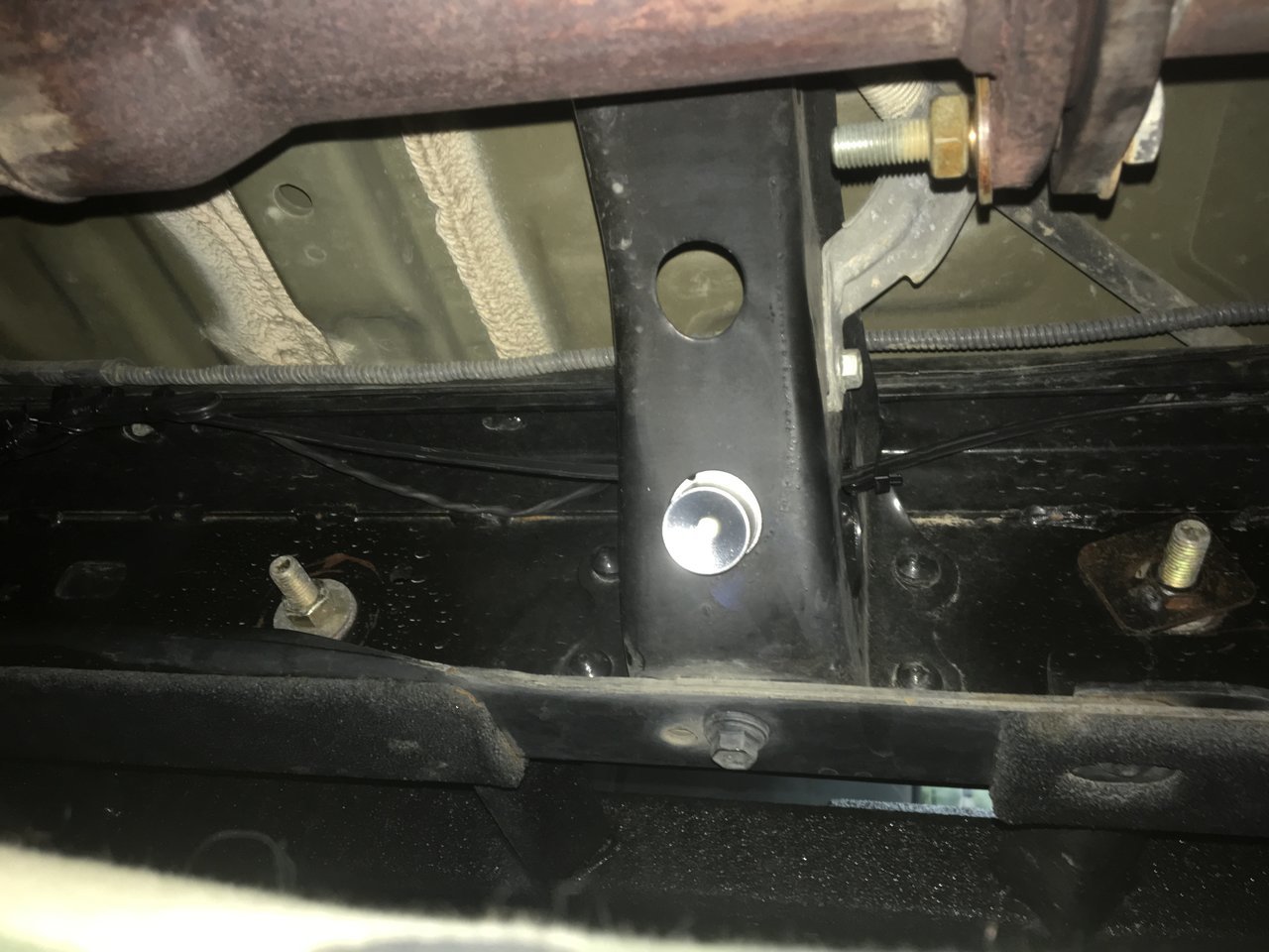

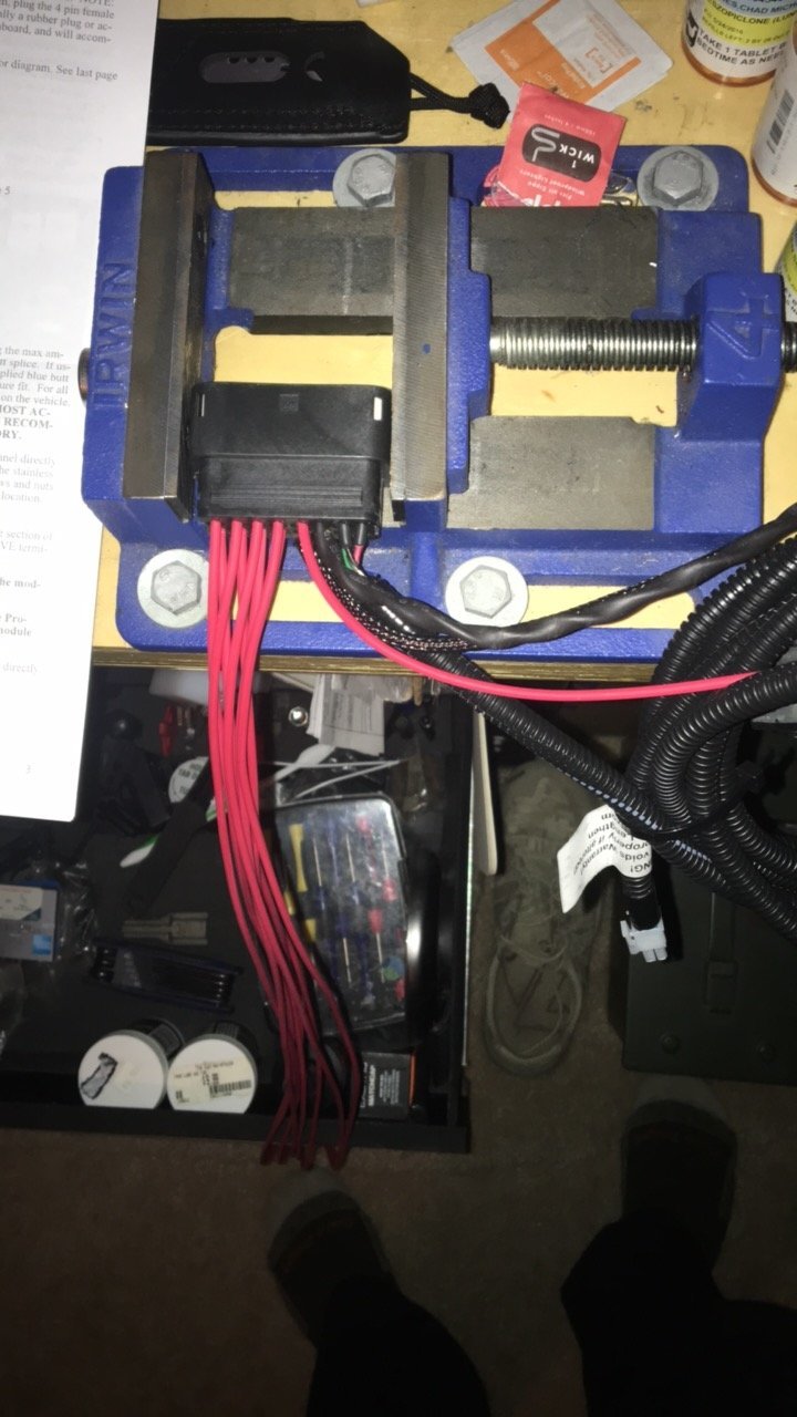

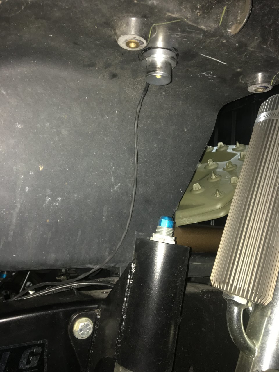

    Did my @C4Offroad rock lights install
    And wired my @switch-pros unit

    I had some lights in the front like yours, got ripped off when I stuffed it lol

    I am gonna move that front one but for now I couldn't find a good place for it

    I like that switch panel, and that vise

    Rock lights are looking good, I still wanna change the angle of the ones in the middle but I like them overall
    Gonna try and get these wired this week or weekend for the rear of the truck

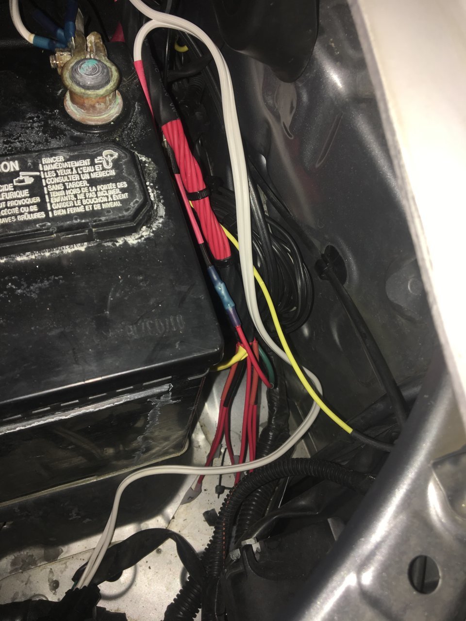

    Which did you tap for the blue and yellow wires if you don't mind me asking. Trying to make sure I dont mess anything up.
    ChadsPride likes this.
  13. Nov 22, 2017 at 3:42 PM
    #233
    Caboose117
    Caboose117 [OP] foul mouthed Marine
    Aug 3, 2014
    #135375
    4,565
    Chad
    Kentucky
    ;IGY6 Rescue Truck
    smashed this, broke that, covered it up with tape and paint
    Yellow goes to your side marker for dimming on the unit
    And the blue goes through the firewall and into the fuse panel under your dash
    There is a legend on that fuse block so you will be able to see directly which to tap
