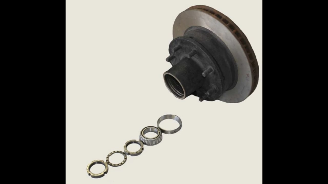

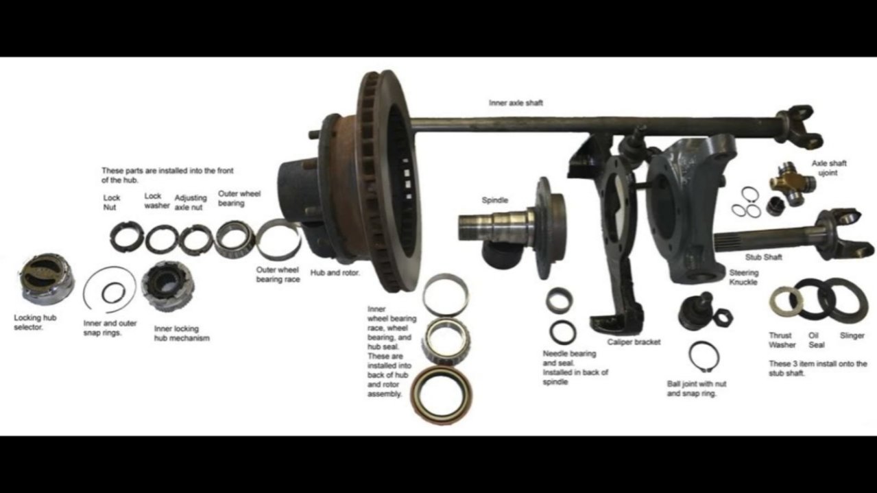

    Got the shock hoops (pictured) beadblasted so I can spray them with steel-it black before They are welded to the truck,
    Did a rough assembly of the spindle/hub/Dana 44 just to familiarize myself with the anatomy of it
    438986A5-C3C4-474E-8639-419E3E4130BF.jpg 53E17EFA-190B-46AA-8AE7-92A6E24E6426.jpg
    Also have a couple schematics I found to give a better visual
    6EA40EAE-42EE-4532-BD74-79903ED1B13A.jpg 66F42975-153A-49F8-9F67-28060BAF474E.jpg

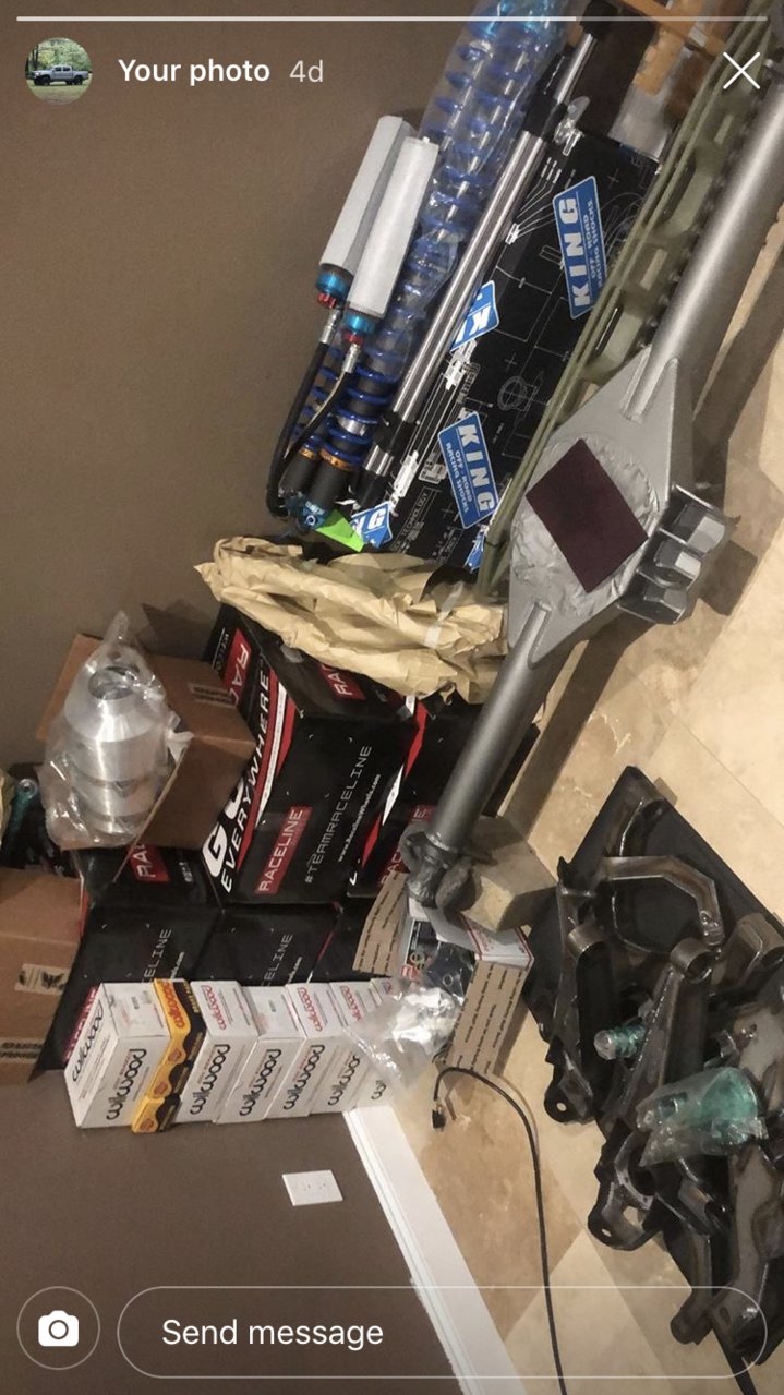

    The parts pile so far

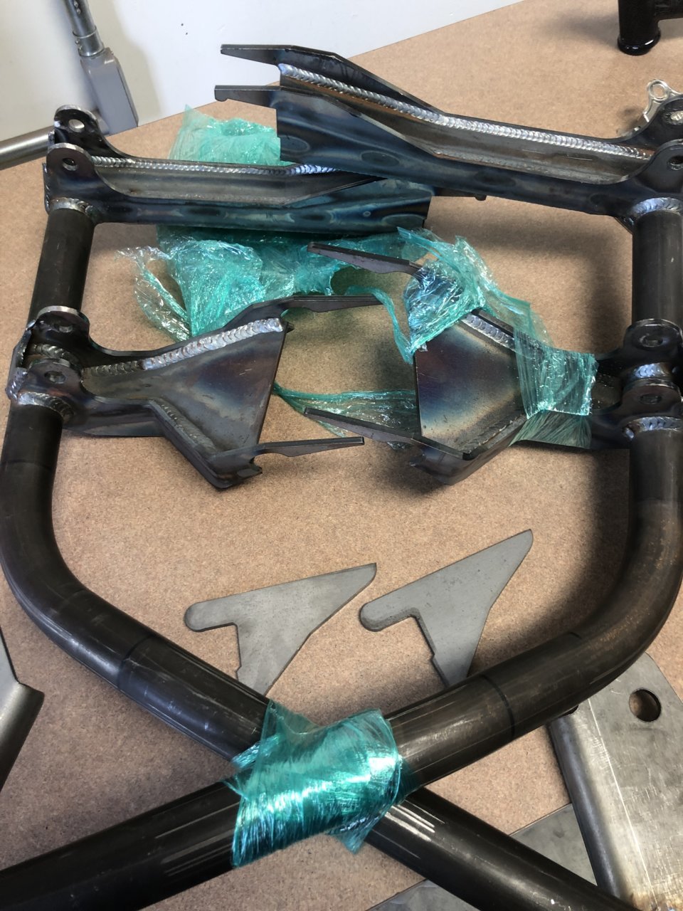

    I’ve been waiting on these stupid plates that allow you to lockout your lower control arm making all your adjustments from the upper control arm and the tie rod
    Well I’ve been waiting on them since I posted the pictures of the front kit.
    They just showed up today.... and they are cut to shape
    But there is no hole in them to center the arms.....
    So
    Gonna try and make it work to do initial install and cycling the suspension soon
    Then it’ll come off and go to Cerakote and then final install
