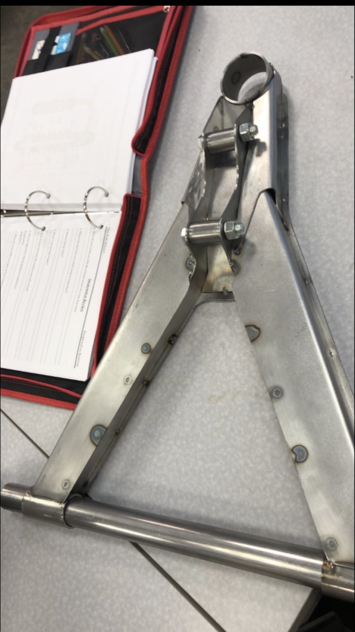

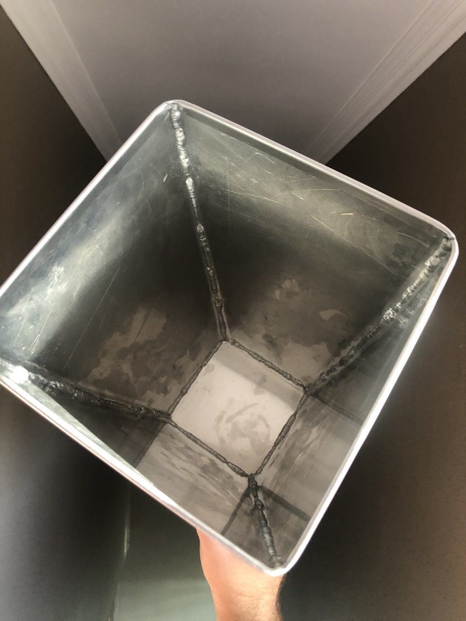

    DF59F522-D6B6-462F-93F3-8CA4E87DE441.jpg CC05BF6A-D594-40F8-BF4F-8D9BE020326B.jpg AEC37D37-D711-40C2-A4F1-9184A0F4B81D.jpg
    We made a lower control arm this week in class
    All parts were cut after using a template to outline the shapes on the metal and then cut using a bandsaw
    Then all parts are deburred and grained then we bend them to the needed angle
    Some are 90 some are like 88 and the center rib is a compound of different bends,
    we machined all the uniball and bushing cups by lathe
    And then we assemble.
    Grading is supposed to be done once all parts are tacked in place.
    They don’t let us fully weld it for grade but when I get time I’ll go back and do it for the practice.

    If you look real close there are a handful of things that would make this a junk part.
    They flat out told us nobody would have a perfect arm because they intentionally build it out of spec so nobody tries to take it home and install it on something.
    apparently a lot of the projects we will be making are intentionally off in some spot or another to discourage use of the item on your vehicle haha

    Makes complete sense why they'd do that. They're just teaching the method so you can walk away with the skill and knowledge

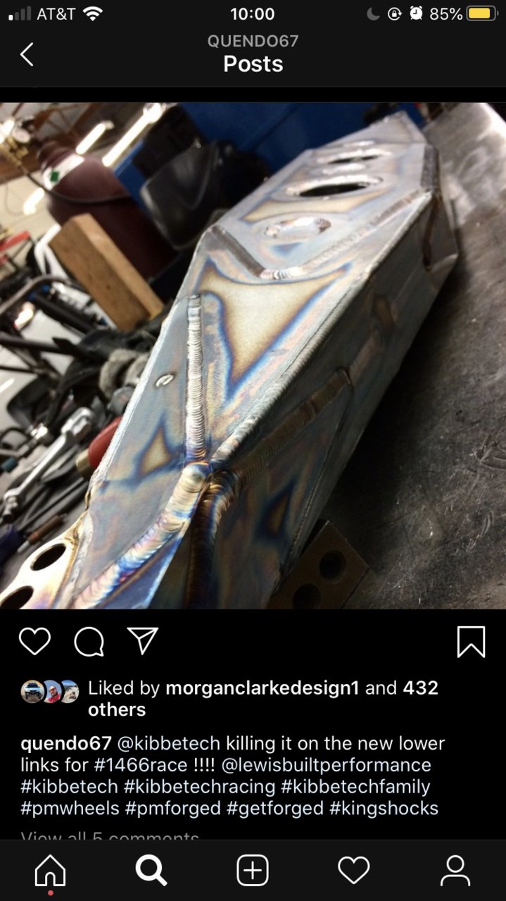

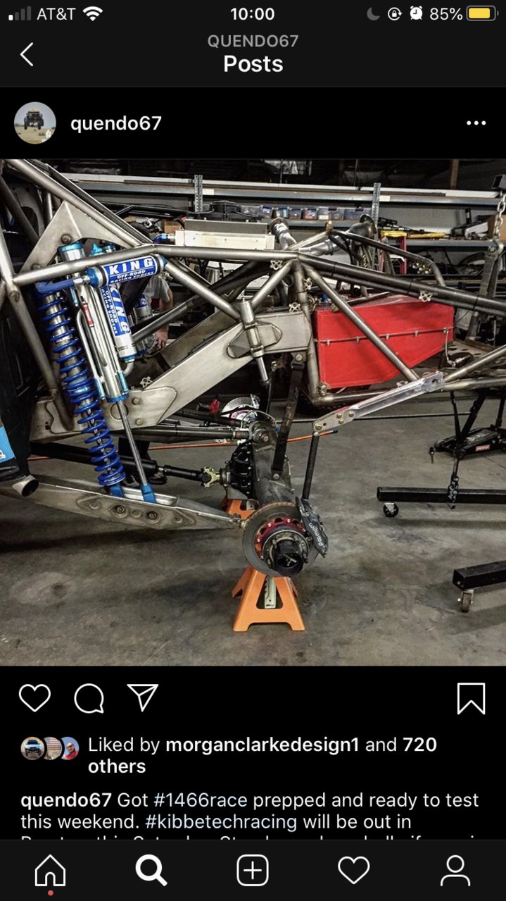

    -48" long tig welded trailing arms take offs from the Camburg Kids Ranger, Designed by lewis built performance and welded by kibbetech
    PRICE 950.00$
