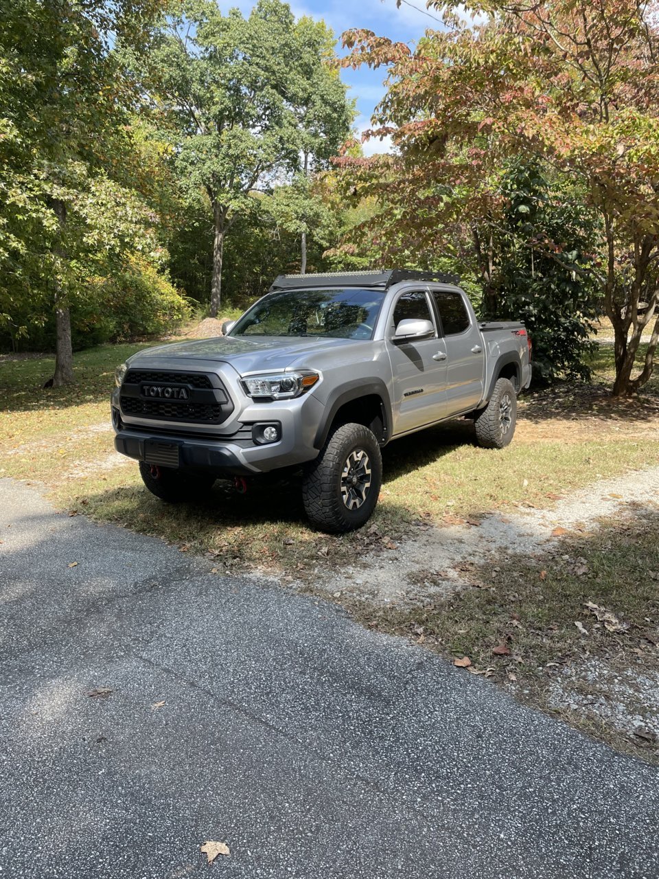

    I’m over the level which is really a raised front look. I’m adding 1 inch block to bring the natural rake look back.

    I too prefer natural rake. I'd suggest dropping one clip on the front shocks.... especially if you don't absolutely want larger tires. Larger tires have too many negatives IMO.

    It also looks higher because your flare is cut. Should have switched those too

    I have since lol.

    Get a 1/2 taller block, easier, no alignment needed and less work than lowering the front.

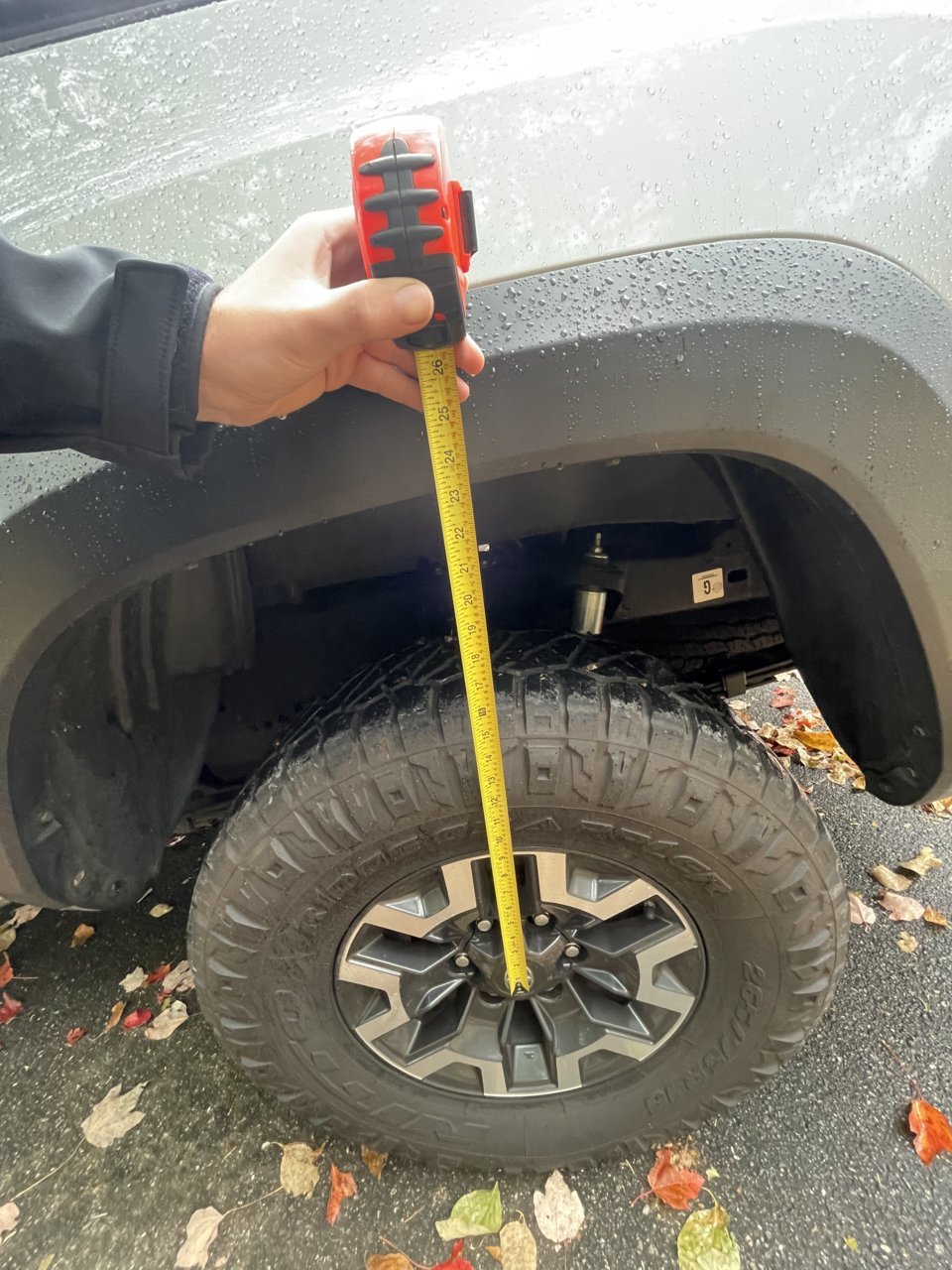

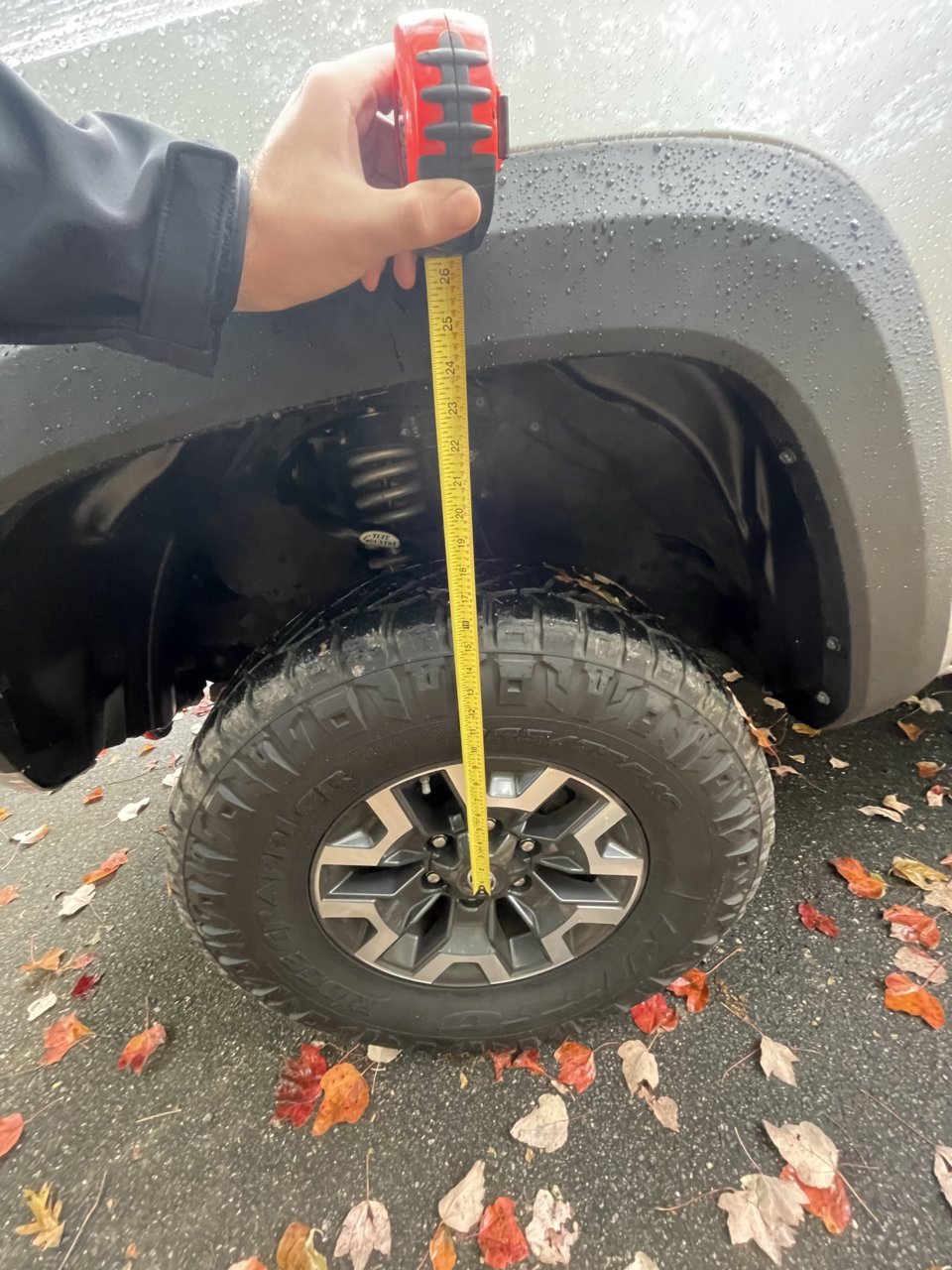

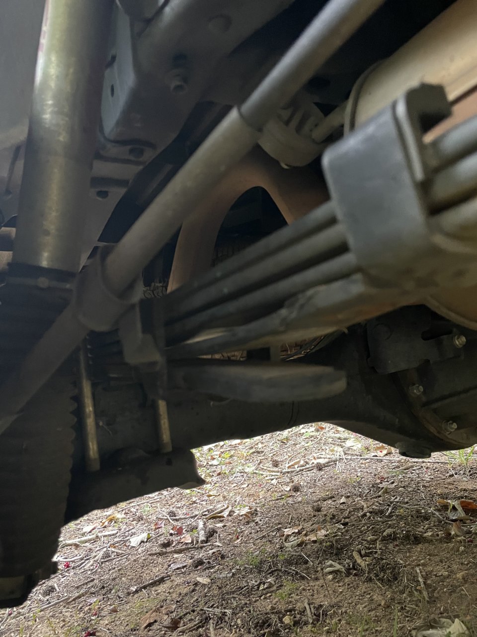

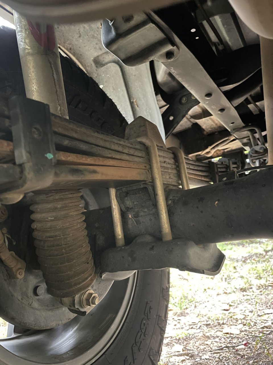

    So,
    do these look factory to y’all? Or did they already AAL in the rear?
    Im contemplating doing the AAL (if I still can?) or perhaps.. just putting new leaf packs on completely.
    Thoughts?
    PS, including my exact measurements. Maybe this can be helpful in choosing the right AAL or new leaf packs?

    Single add a leaf, 2nd from bottom overload.

    Would it be wise to.. add another? Or remove that and add a three progressive pack? Or just get entirely new ones that give the backend the height it needs?

    If you plan on carrying weight, I would get new pack. Like Icon rtx. If not get 3 leaf add a leaf and leave overload in for a full two inches. Hope that would give you enough lift/rake. I personally would do full pack, and be done.

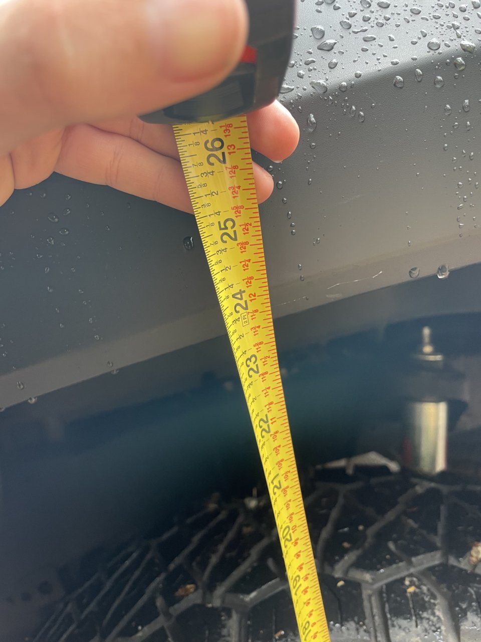

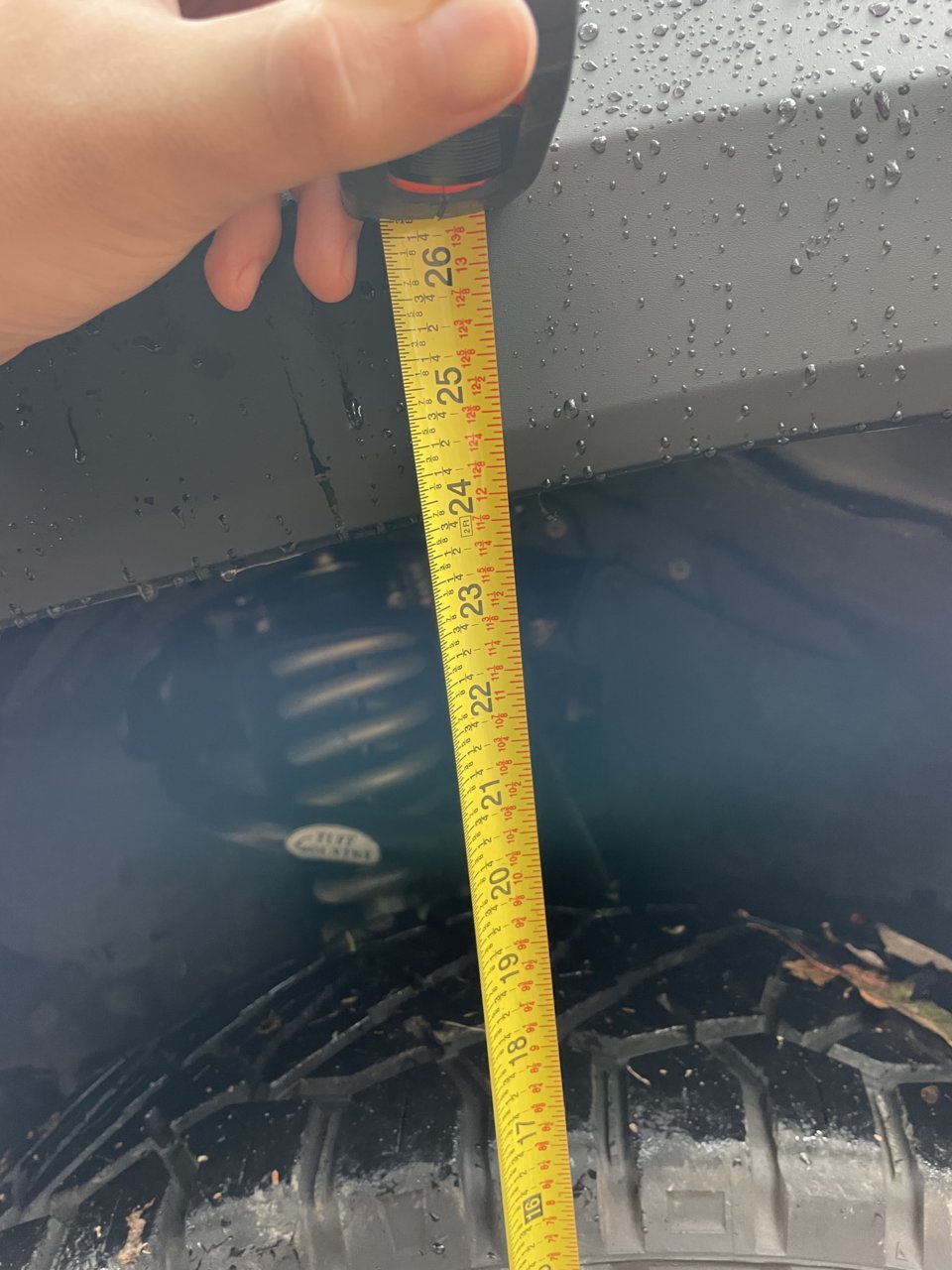

    24” in the front is quite high and might be leaving you with next to zero down travel, which can lead to a non-optimal ride. I suggest jacking the front of the truck up so that the wheels hang freely off the ground and measure the hub to fender distance.

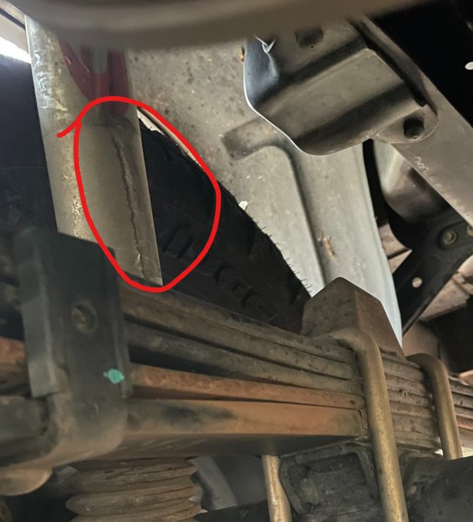

    You're measuring at an angle. Try to keep the tape vertical for consistency.
    Also, what's this? It could be some liquid or other optical illusion, but it looks like failed tube.

    Good call!
    yep! Fluid. They are sending me another! The shock was leaky
