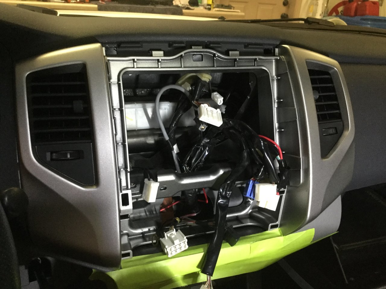

    Hey guys I’ve been using the search... area and been reading and searching for about 3 hours.
    I would like to remove the silver part with the AC vents in the photo!
    I don’t see any screws are there any hidden screws? Or do I have to pull a little harder on the drivers side outside edge? The passenger side popped off but the drivers side is really in there...Sorry but I don’t want to break this part because I’m sure it’s not cheap. Adult beverages for help!

    if I remember correctly,
    Drop the steering column all the way down.
    Remove two Phillips screws above the gauge cluster (straight up from the steering column.) pry the right side of that panel out a bit, because it overlaps the trim you want off
    then just pull that sucker out

    Push pins, philips screws, same thing lol
