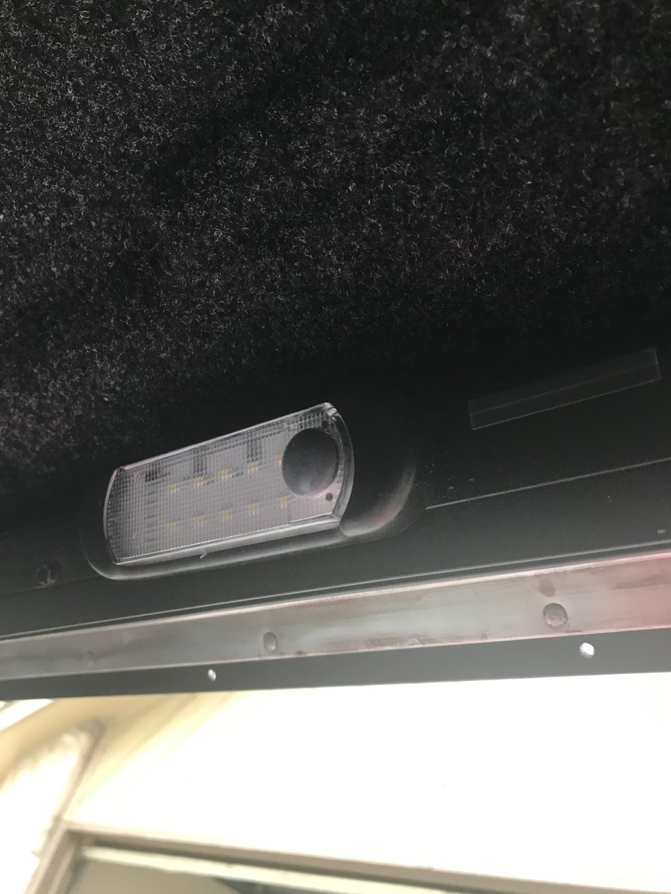

    Went to our local Joannes fabric store and found a good deal of 70% off.
    Cut up some fabric and stapled pieces of velcro to the mating end of the fabric to the camper top carpet! Looks legit!
    Also found the problem with my camper night light, the headlights have to be on for it to illuminate!

    Somebody got lazy and wired it to the tail light circuit at the tail light. You only need to turn on the park lights. That will allow longer run time before the battery goes too dead to start.
    Ideally, there should be a fused wire run all the way from the battery. The downside to having it wired to constant power is that you can forget and leave it on without noticing and run the battery dead. If you make sure the camper light is an LED, you could probably leave it on for over 24 hours before the battery goes dead. If it's an incandescent bulb, leaving it on overnight could possibly drain the battery enough that it won't start.

    Yes sir. I couldnt figure out why it wouldnt turn on until i was stopped at a red light lastnight and it was on. K noticed whenever my head lights are turned off, the LED camper light turns off too. Pretty lazy set up for whoever did it. Thank you!
