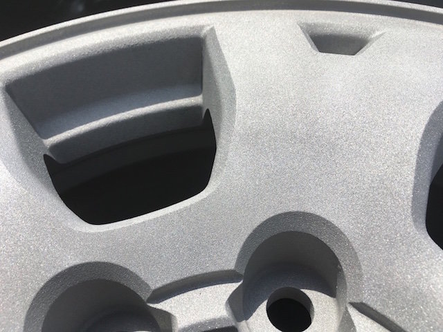

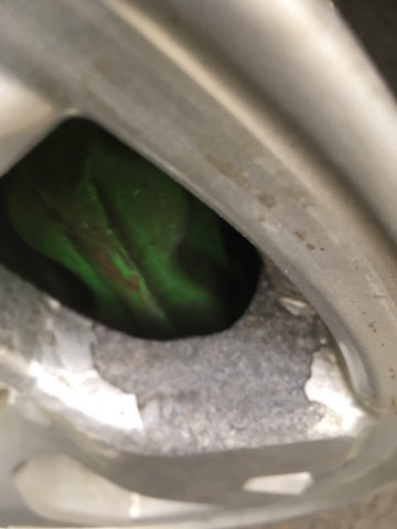

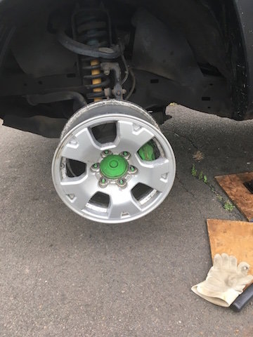

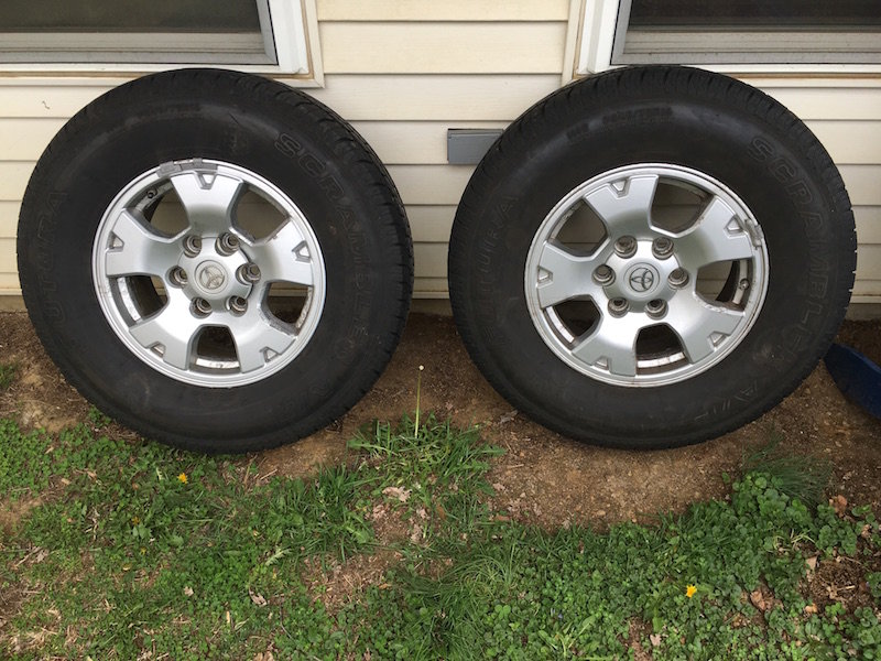

    I decided to pass on using spacers, too many safety issues. Instead I looked for wheels that would fit the truck. After a couple of weeks searching the usual places, a set of four 2006 wheels w/tires and center caps came up on CL for $100.00. I happened to see it 20 mins. after posting and was first to respond and got them!! :dancingbacon:The finish is peeling, but I plan on powder coating or painting them gloss black, which ever is affordable. The tires are in decent shape and match the spare. ( 245/75R16). Yes chuck0412, I will def. be painting the green black as well. :thumbsup:
    How they look now...
    test fit them first, and loads of clearance now!
    Time to paint.........

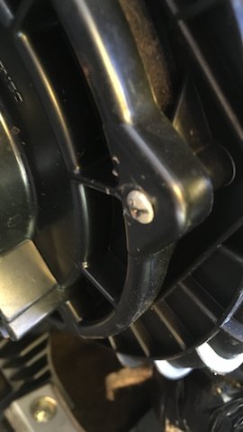

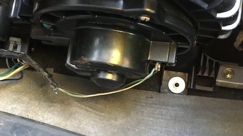

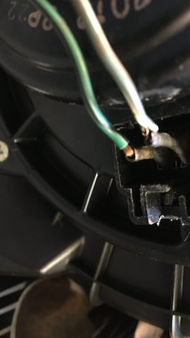

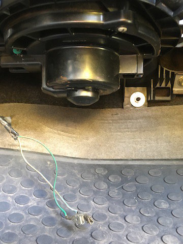

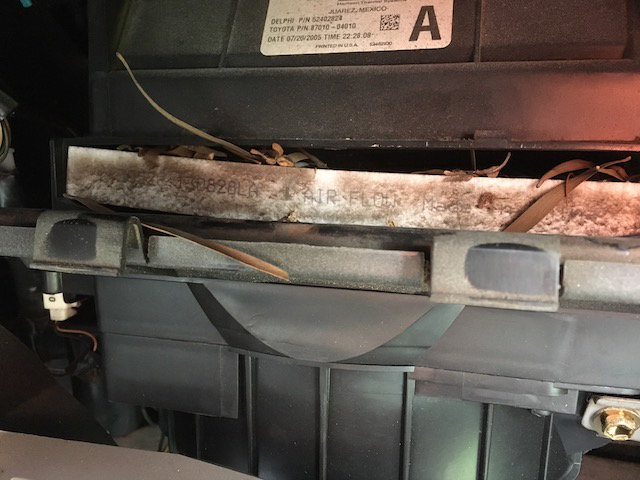

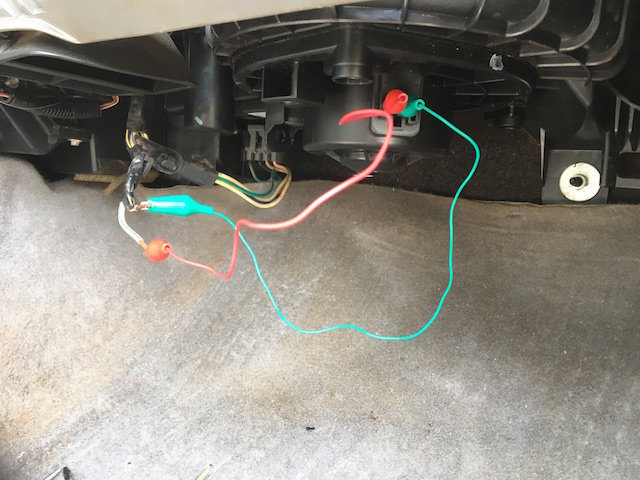

    So now I know why I have all of the 'half-assery' going on under the blower motor!
    I have been dealing with taped & dangling wires since I have been driving the truck...
    I'm always telling passengers to watch out for the wires or re-connecting them after they get out. :mad: This has finally become an issue because I decided to change the cabin air filter.

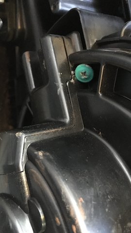

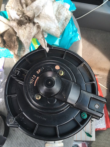

    Besides all of leaves and dirt, the diverter door also came out. I was going to remove the motor but noticed the screws were not factory and one was clearly improvised.
    After checking the Haynes manual and You Tube, I have the wrong motor installed by the previous owner.:facepalm: My real problem is the connector. The 05' connector is 90° further away from the cut and soldered wires. I'm afraid to take this motor out for fear of not having any A/C for who knows how long! I can go without the diverter door being installed.
    Any help sourcing the proper connector would be awesome! Yeah, I could extend the existing crap, but would rather have the proper plug installed.

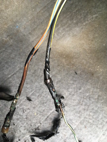

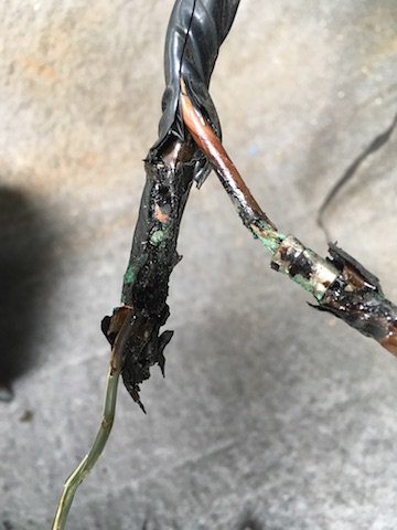

    Ok, got a lot done today.

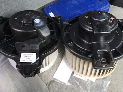

    Picked up the parts from Team Toyota and got them installed. While I had the motor out I cleaned the ducts. Since the old motor fit so well, could it be a 1st Gen? The green screw does absolutely nothing.
    Cut the tape off and found the connections were burned and melted. I think when the wires were knocked off, they would short out until re-connected.
    Tested the wires to make sure the fan would not run backwards.
    Everything in place.
    I tried putting the damper door back in place, but I will have to take the dash and all of the hvac ducts apart.

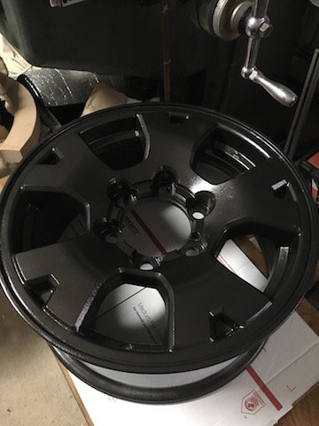

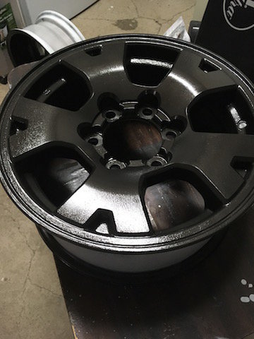

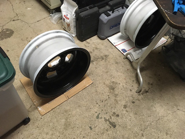

    Also started painting the wheels. Last week I primed them w/Rustoleum brush on. It saved me about $30 in spray. Today Rustoleum black hammered finish went on, the first of two coats.
