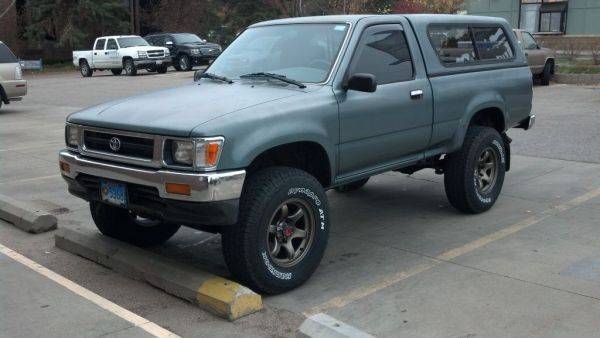

    I am doing a retrofit from TRS on this pickup:
    1993 Pickup
    I am installing D2S minis into clear lense housings for it and need someone to tell me what housings they used. I was debating between the Vision X and the Anzo USA ones off of autoanything, and got the Anzo ones.
