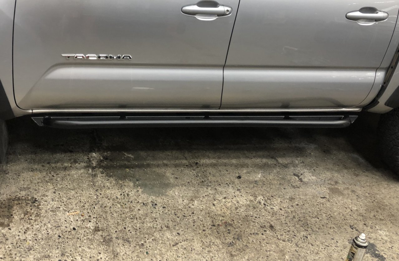

    That’s too bad. I try to keep in mind these things are designed to be scraped across rocks. My RCI rear bumper arrived perfect as well, but has its share of battle scars now. I’m sure these sliders won’t be perfect for long. My main concern was that the powder coat the buts up to the frame be in good shape because I don’t want any rust developing on it.

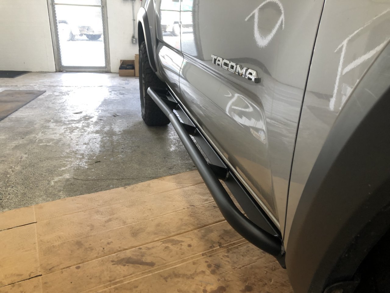

    Those suckers sit way out. Wow

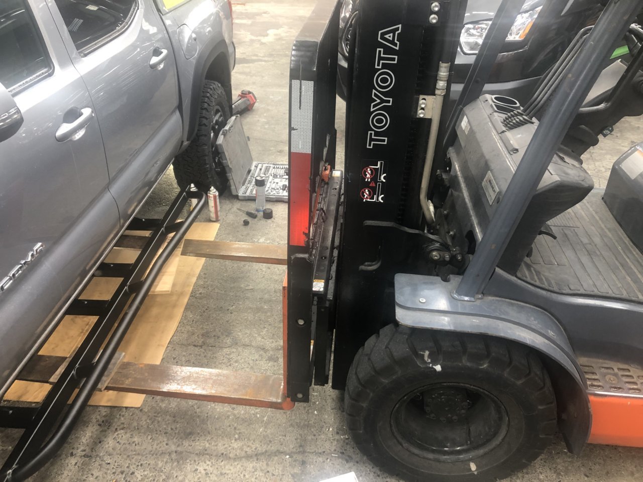

    It may just be the camera angle. They are actually pretty tight. Unless you are referring to the 1st photo with the forklift, in which case that is hilarious.

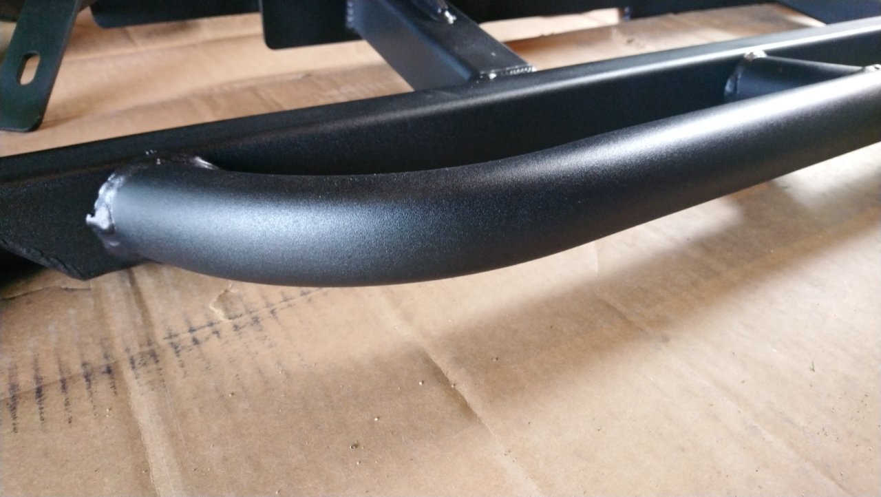

    Thanks for the post! I finally got around to painting my RCI sliders this weekend. Your pics give me motivation to install them this week
    Rustoleum textured finish. I think it came out a little blotchy. But whatever, I saved a little scrilla not powder coatingDSC_0594.jpg
    These things are TANKS

    I'll definitely check out the video if I need help. I plan to use one of my shop lifts to hold up the sliders, pretty much what you did with the the yota fork lift

    The main thing that RCI doesn’t point out is removing the rectangular plug and piercing the circular sticker for the front two fasteners. You must do that first.
    Do the driver side first, because the interference items and the hard-to-reach stuff is all on that side. Once you’ve stuffed your arm behind the brake lines to get into the boxed section on the drivers side, the passenger side will seem like a day off.
