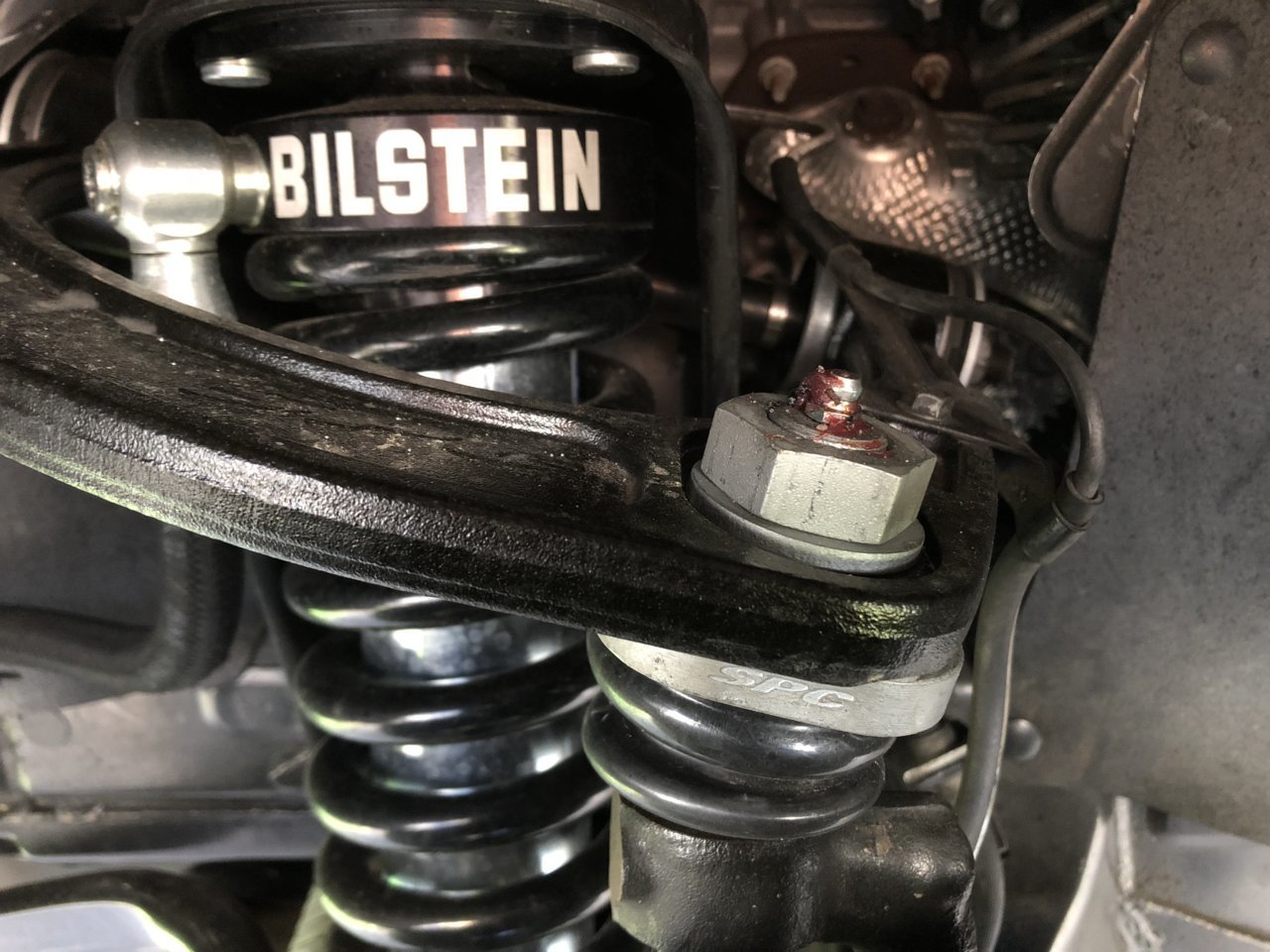

    Just got done doing the King coilovers and SPCs on the front of my 2016 TRD Tacoma. First time ive done anything like this, had a local mobile mechanic come out and do most of the install while i was working.
    There is a ton of positive camber after the install. SPC set to "D" and looks like its maxed on adjustment. The guy that did the install insists that i just need an alignment which i expected, but i didnt think it would be this bad. Worried ill fuck something up on my way to the alignment shop.

    ill snap one real quick, no laughs hehe. I have a build thread going over in suspension but didnt get any love, figured id try here for more traffic. It looks pretty bad, im wondering if he missed something in the install

    i can see what the numb nut did wrong, he has the ball joint installed backwards with the SPC facing away from the tire. This is what i get for trying to save time and hire a local schlep to save some time and keep working while he did the lift. Looks like im going to harbor freight to pick up a jack and a few tools to get this done properly. smfh.

    After hitting harbor freight to buy a few things I didn’t have, and about 90 min everything is torqued properly and the ball joint and adjuster are oriented properly. Still some positive camber but MUCH better.
    I stopped him when I saw the camber before he did the rears.
    Guess I’ll be doing that tonight or in the morning. Thank god I know how to turn a wrench, woulda been pissed if I couldn’t fix it on my own.
    How bad is doing the rear leafs ? Shocks look easy it’s the heavy Dakar I’m worried about getting into place on my own.

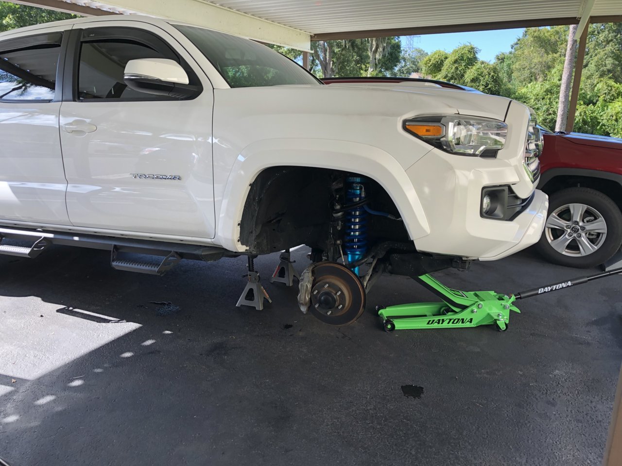

    That jack :thumbsup:

    That’s what I hit harbor freight for haha. One of the rear wheels is seized tho haha another errand for the list lol.

    Yeah it's super easy to correct the ball joint on your own. Just jack the front end up and loosen the top nut on the SPCs, twist the ball joint to the D setting and for the correct camber make sure the ball joint is slid as far toward the tire as it will go (there's a slot for it to slide in/out to adjust camber). Torque the top nut to 150ft lbs and get an alignment to top it off

    Basically how it went. I retorqued everything as well. Eliminated most of that positive camber. Now to do the rears and get an alignment. Hopefully not get crushed by the heavy Dakar pack in the process haha
