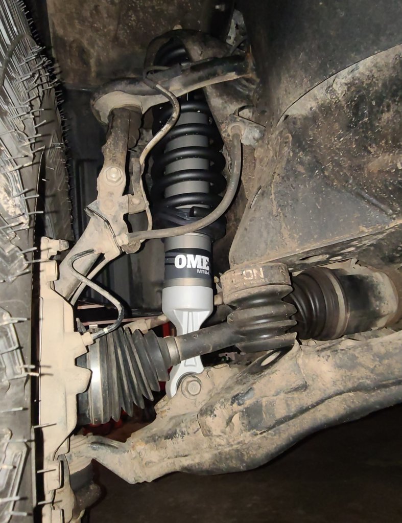

    Once @CygnusX191 informed me it wasn't needed, my swaybar immediately came off and has been on a shelf in the garage since.
    I can follow by saying I really liked the way it freed up the front end.
    With stock coilovers it made the ride feel like sitting on a waterbed at times.
    The ICON front bumps (made for Tundras) helped with some of the sway and control.
    The MT64s were right up my alley, as far as product description goes.
    Something more to help stabilize not having a swaybar.
    They'll either do what they say or they have a great marketing team.
    So, far.
    Definitely smoother ride. The response helps eliminate the waterbed feel and adds control on the turns.
    Figuring out the clip setting adjustment can be confusing. Luckily, I chose correctly for the current setup.
    I'm sitting right at 2". If I add weight I won't mind if the front drops a little.

    I added the rear when I had the habitat but i still like it even with it removed. Keeps the truck a lot more planted through corners and made a huge difference with cross winds with the camper. I swapped to the TRD one in the front too so they are both red :)

    You have discovered the same thing that I have, that a bump stop very close to the control arm can limit lean in the way that a sway bar does but you still maintain the great ride quality of not having a sway bar. It's a fantastic combination that I will always run if at all possible

    Take note of the swaybar location on the '24. Toyota basically did the same thing but had to use the bar.

    Where was I?
    oh ya. MT64.
    I'm at the 4th setting with only sliders and skids maintaining 2".
    If you're carrying bumper/winch what have you, I'd probably go for the top setting.
    (Larry wanted to know for when his pkg. shows up.)

    I found that going to aftermarket leafs took away the last of the waterbed feeling after removing the sway bar. Stiffening the rear really did help the front.

    I can believe this.
    Even with the aal, the firmer fronts actually helped the back.
