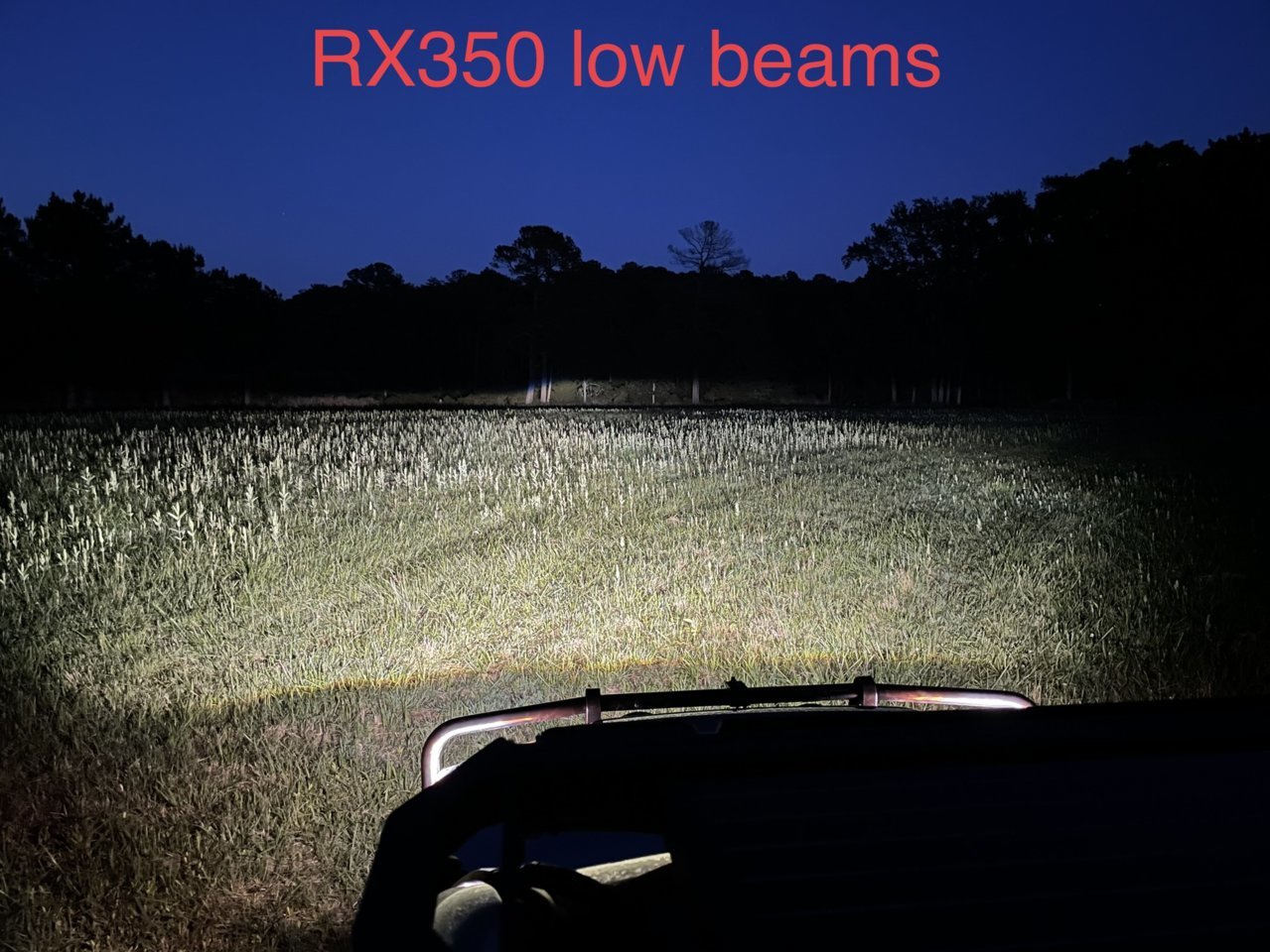

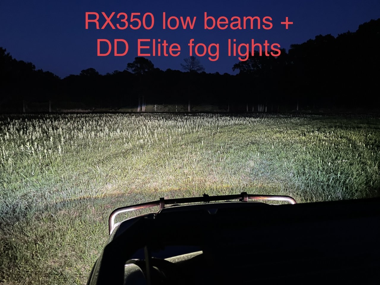

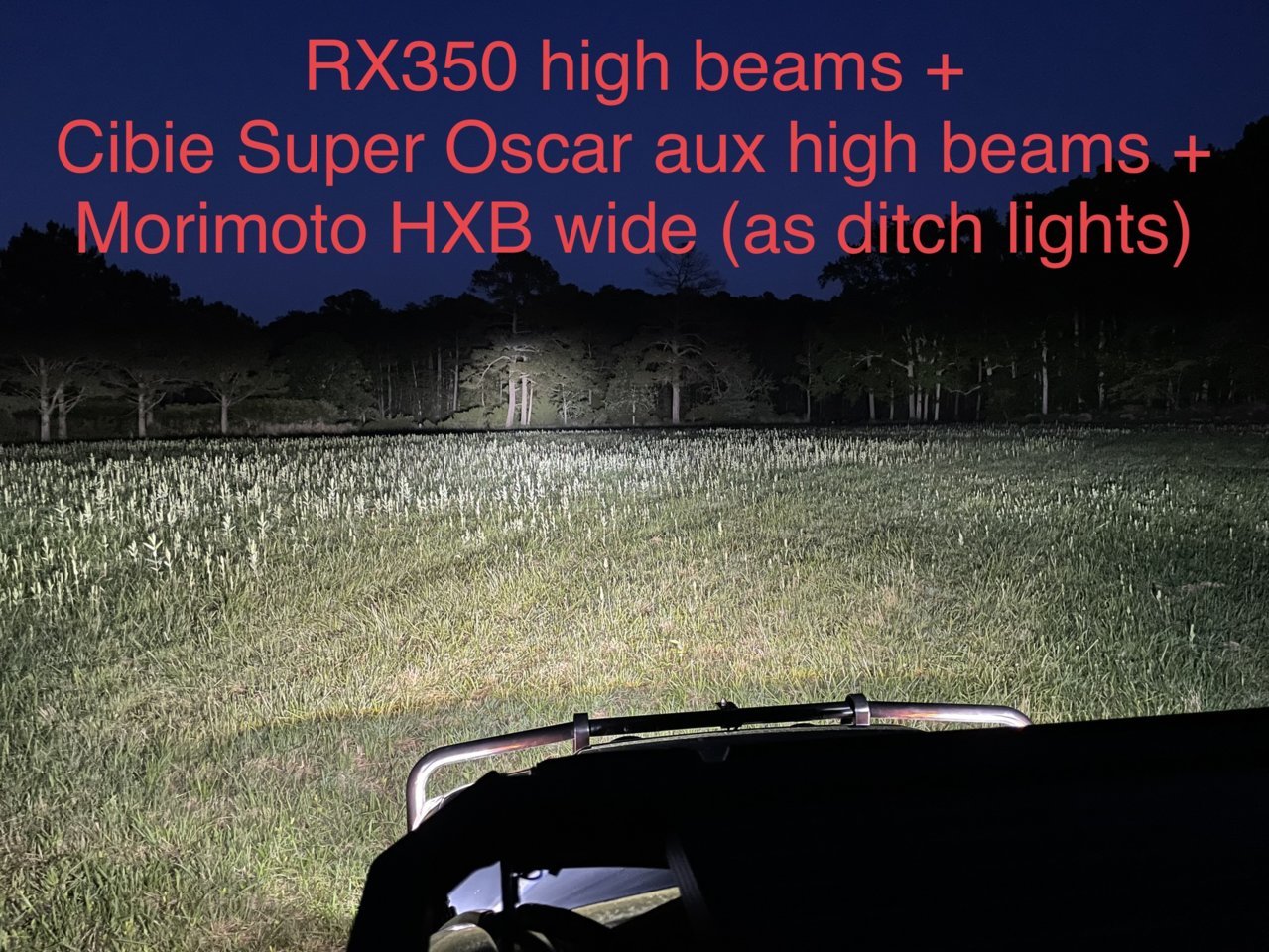

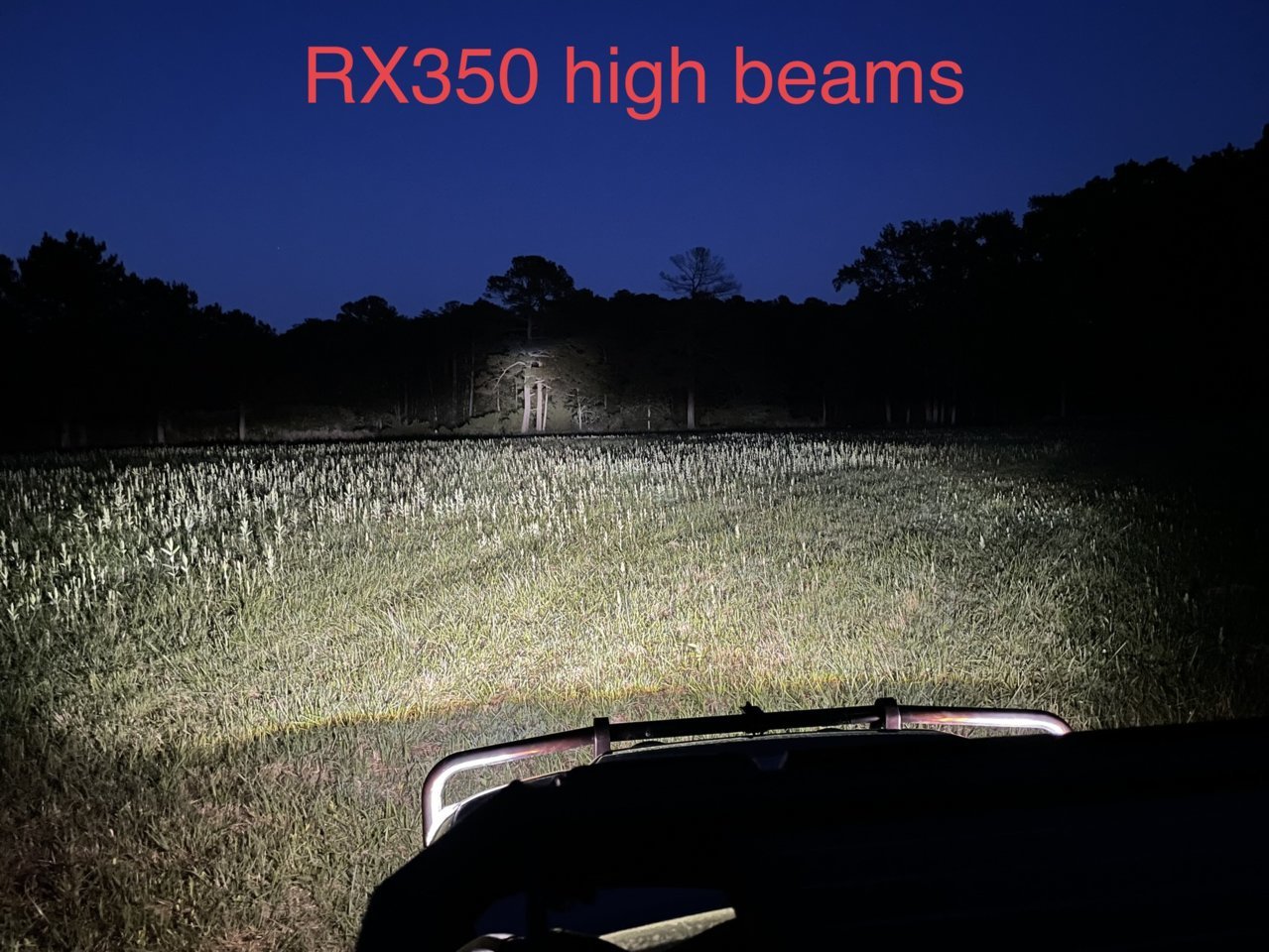

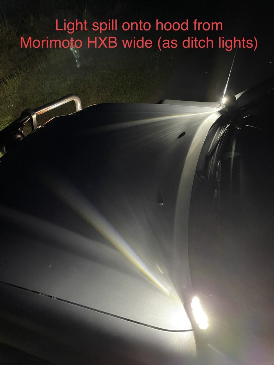

    Quick shots I took tonight comparing output at the varying “levels” I have available.
    My only gripe with the Morimoto ditch lights thus far is the weird spill emitting perpendicular to the direction they’re aimed. Not distracting or anything, just sloppy design.

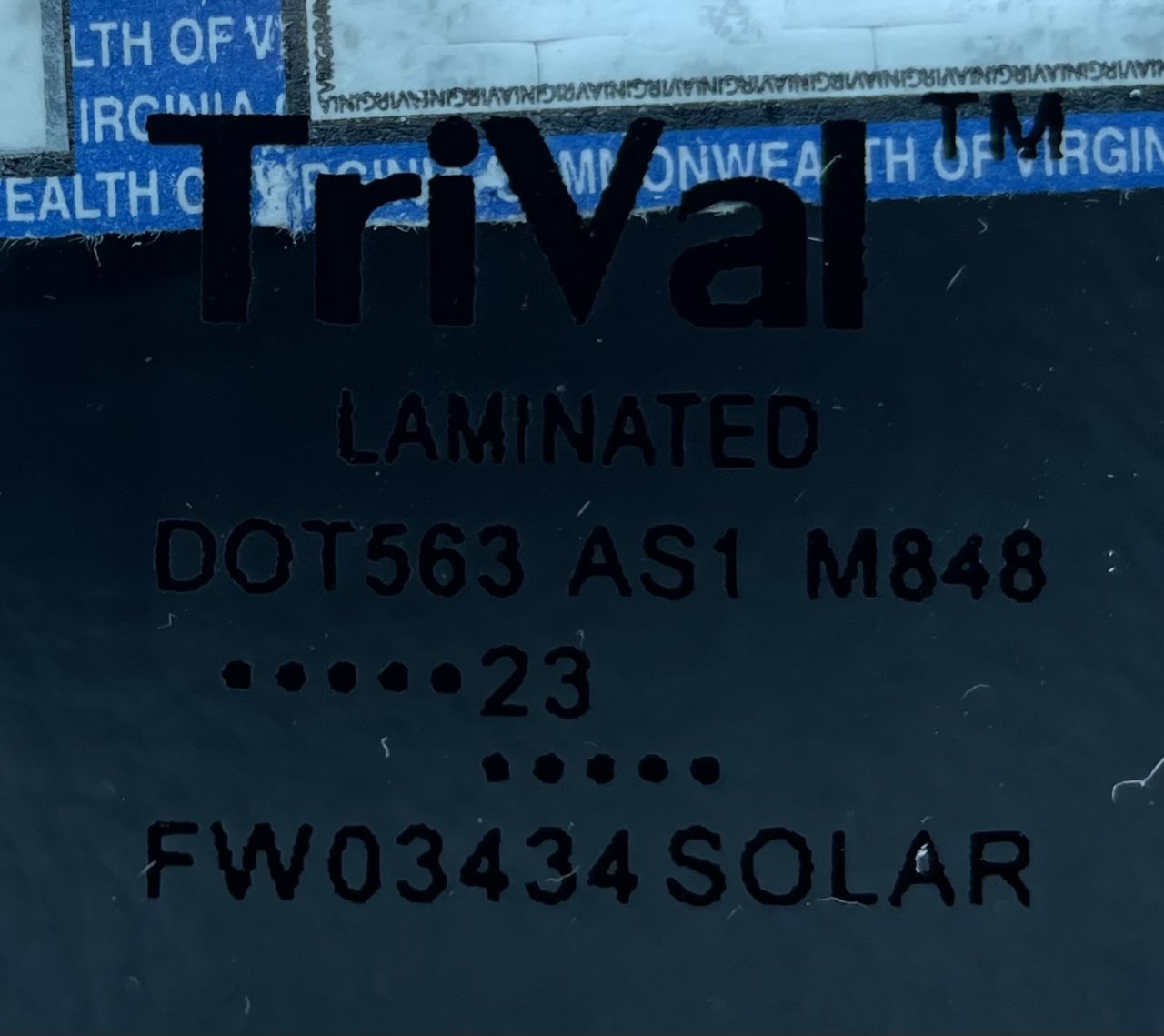

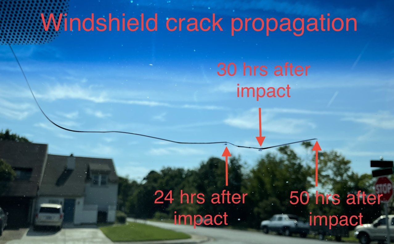

    Well, it finally happened. Something on my truck broke. Okay, something on my truck broke that had nothing to do with mods.
    I caught some sort of debris while bebopping down the highway the morning of this past Saturday, 02 SEP. I didn't even notice the damage until nearly 12 hours later. As you can see above, the crack was spreading pretty steadily, so the only option was to replace the windshield.
    In the interest of brevity (since this post is more for my own reference than anything else), I did a little poking around. Safelite installs crap-quality windshields, and the wait time to get an appointment with them was way too long. Glass America had an immediate availability, but they don't do what they say they'll do. I specifically requested quality, non-Chinese glass to be installed on three separate phone calls with three separate people. Apparently that word didn't get passed on to the people actually doing the work.

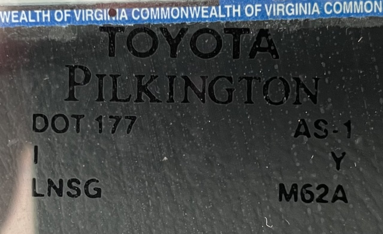

    Note the DOT 563 marking, which indicates that the windshield was manufactured by Shenzen Automotive Glass in China. Compare this to my stock windshield:
    DOT 177 corresponds with LN Safety Glass out of Ohio. Source here:
    https://www.carwindshields.info/dot_db
    I'll stick with the crappy off-brand windshield for now, but when it breaks, I'll go to Glass King out of Norfolk. Despite the painfully slow comms with their people, their installer is clearly a knowledgeable guy who understands what it means to do it right the first time. I imagine that's why a couple local dealerships recommended them, since they also handle the dealership's glass replacement work.

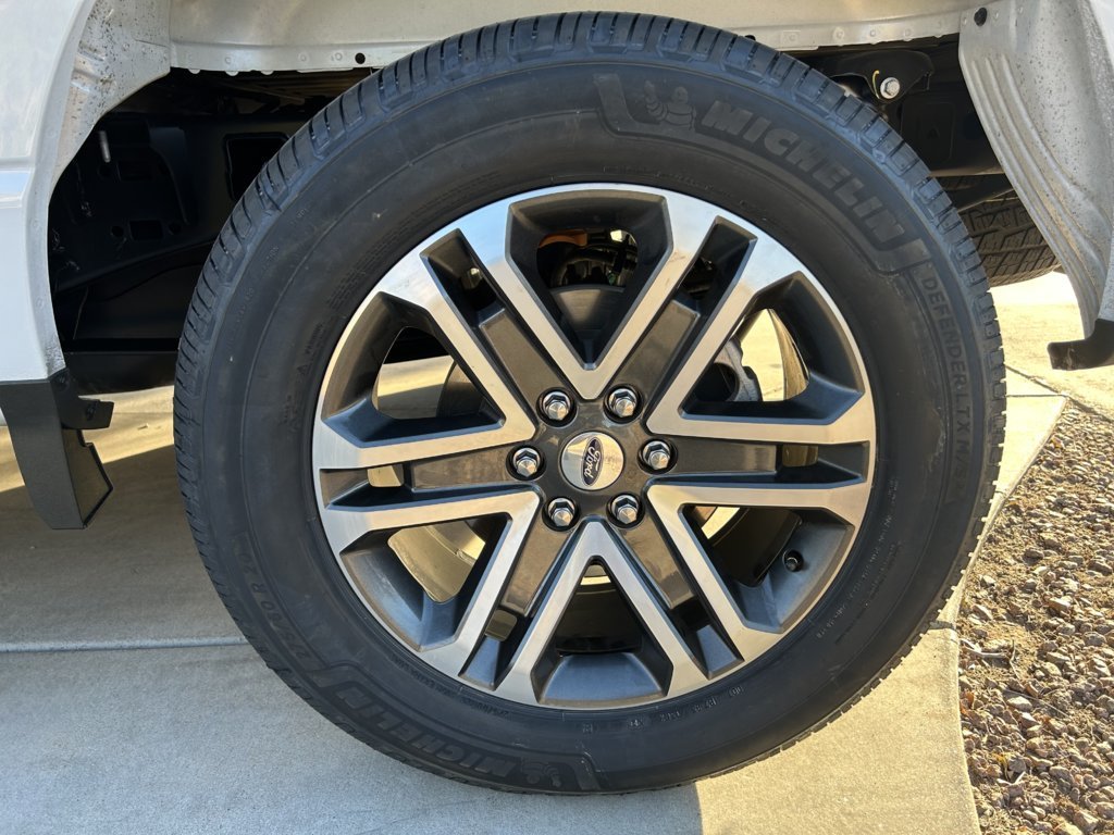

    I hope so too. The good news was that I got the Michelin grandpa tires, piggybacking off of your research. So far I like them!
    I got a 2022 f150 with the 2.7 ecoboost. So far I love it, hopefully that lasts.

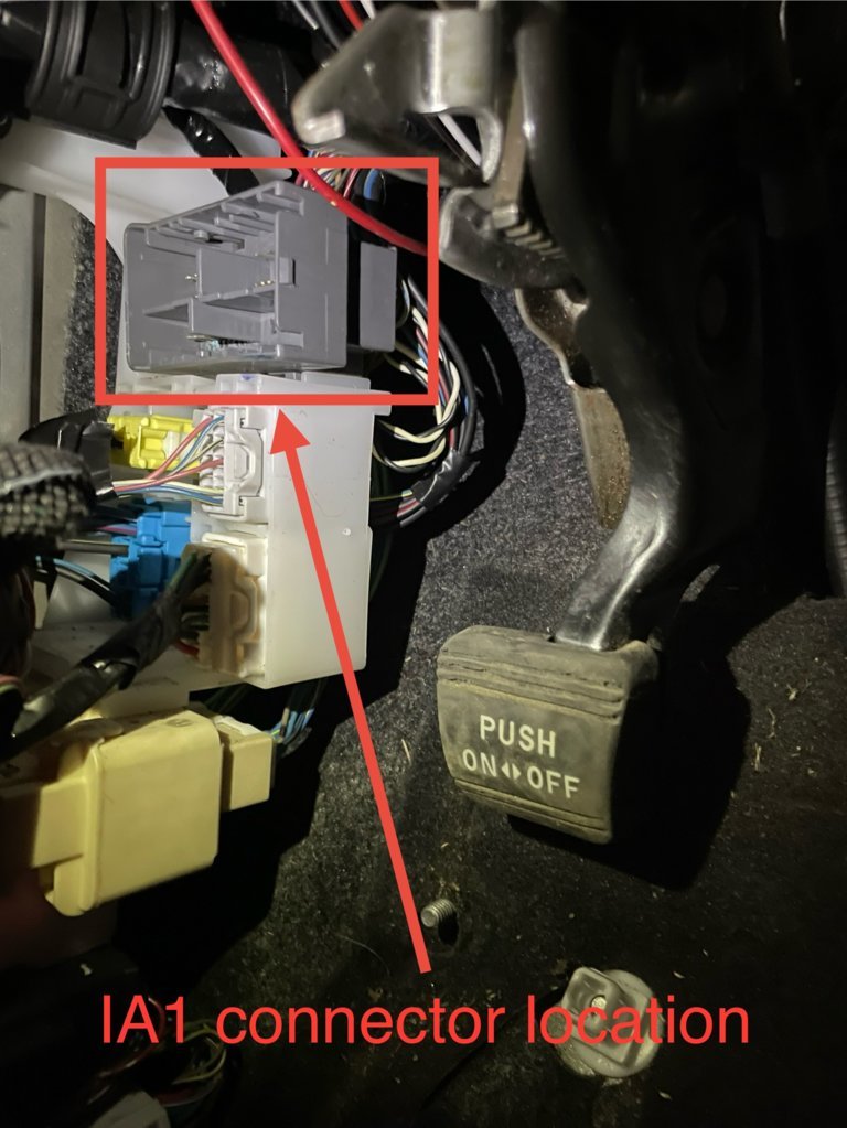

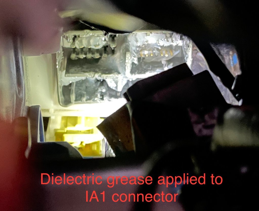

    The same headlight malfunction I experienced in November 2023 (at 90.9k miles) and March of this year (at 116.9k miles) appeared once more a week ago (at 117.9k miles). This sort of trend is indicative of a root problem that needs to be addressed. Time to do some digging.
    Thankfully, TW is an outstanding resource for all sorts of troubleshooting. I stumbled across a few posts from @BadDNA, who seems to have experienced a nearly identical issue with similar symptoms:
    Corrective measures

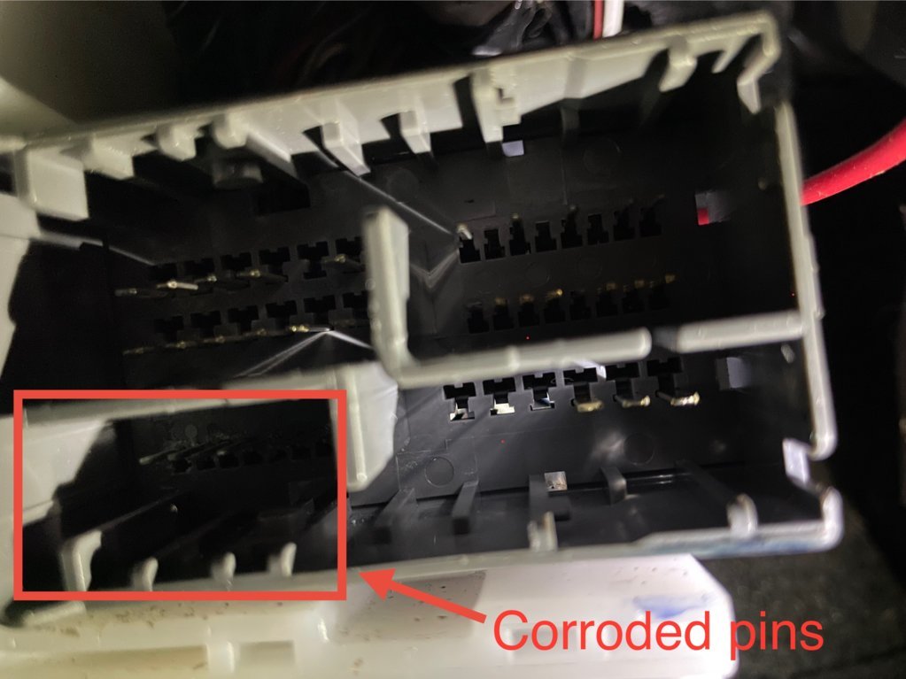

    In BadDNA's case, water intrusion led to the pins inside the IA1 connector shorting out on each other as well as corroding. Considering how similar my symptoms were, I thought it wise to try the same approach.
    I got all up inside my driver's side footwell, located the IA1 connector, and unplugged it to take a look.
    While it's pretty hard to see, the lower-left pins in the connector are a blue-green color. This clearly indicates water intrusion and corrosion.
    I grabbed a toothbrush and scrubbed out the connector as best I could, cleaning up with some q-tips. I then applied an alarming amount of dielectric grease to the connector, to prevent further water-induced issues.
    Plugging the connector back in yielded results that were different, but not better. While my headlights were now turning off when ordered, my high beams were still stuck on with the headlights engaged. Further investigation was required.

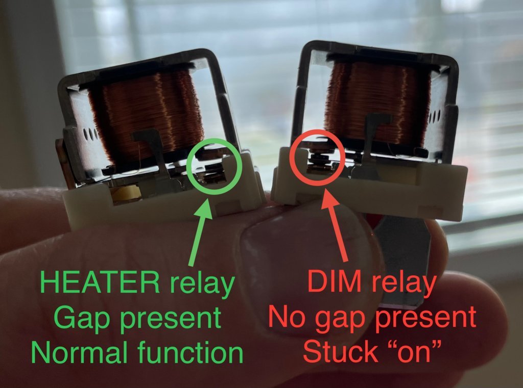

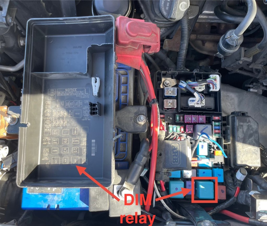

    I removed the DIM (high/low beam select) relay from the under-hood fuse panel and disassembled it. I also pulled the HEATER relay to use as a reference, since it is the same type of relay. As you can see, the DIM relay's contacts are welded together, rendering the little lever arm immobile. That certainly explains why I don't have low beam functionality.
    I ordered a new DIM relay, OEM P/N 90080-87025, and installed it. Testing yielded proper headlight function
